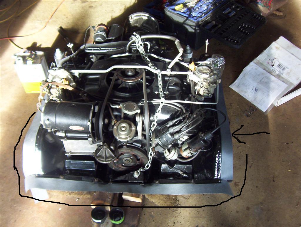

The flexible perimeter seal goes around the engine connected by staples or some people replace them with pop rivits. Both sides, front & back.

oké 64 powerglide, thanks for the picture
I think this seal is missing at my corvair, i'll take a look this weekend.
BTW, can i replace it for just any other rubber seal ?, or does it has to be a Original ?

Your seal will not look like that. That is for an early model. Late model has a different style. Just look at the outer perimeter of the engine sheet metal and it should have a rubber seal that is screwed to the body with sheet metal clips and just pushes onto the engine tins. If there is a gap between the engine sheet metal and the body then you have no perimeter seal. And you definitely need one if that's the case.

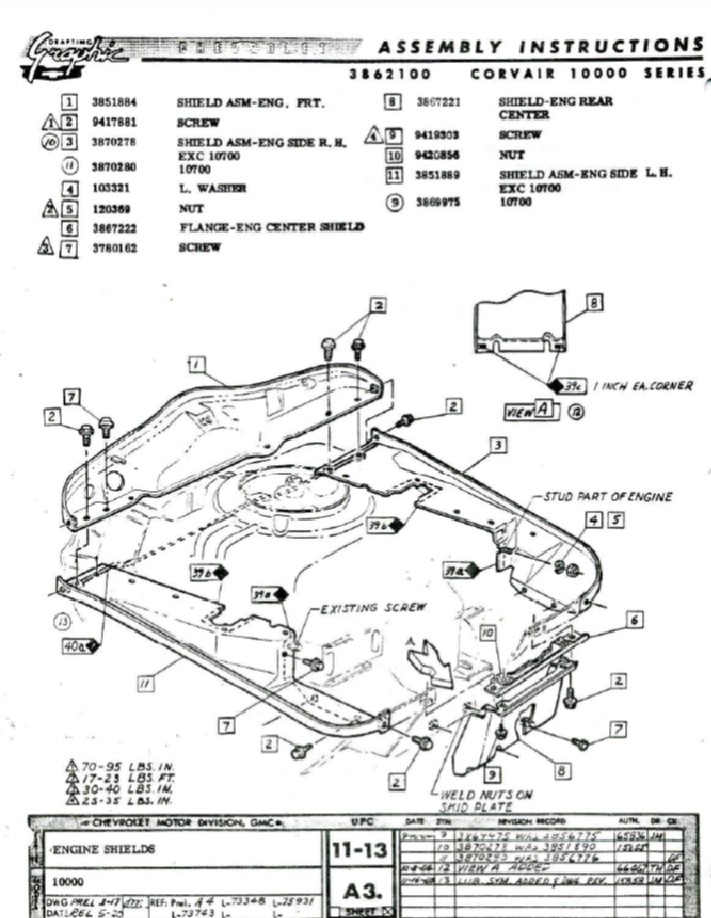

These images show the engine compartment seal for late model (1965-1969) Corvairs. The combination of sheet metal and a rubber seal prevents dirt, water and heated air from entering the engine compartment. The cooling air that passes over the engine cylinder heads and cylinder barrels exits out the rear of the car via the thermostat doors. If the engine shroud and rubber seal were not present, this heated air could reenter the engine compartment, and would then be drawn by the fan blower to pass over the engine cooling fins again. Continuous recycling of this heated air would reduce cooling efficiency and could ultimately cause the engine to overheat. Exhaust fumes and carbon monoxide could also be drawn into the engine compartment, and could then make its way into the passenger compartment via the heater and defroster system. It is therefore very important to properly install and maintain the engine compartment seal around the engine perimeter.

The appropriate sections of the Corvair Shop Manual and Assembly Manual are attached to illustrate the engine compartment sheet metal and seal...

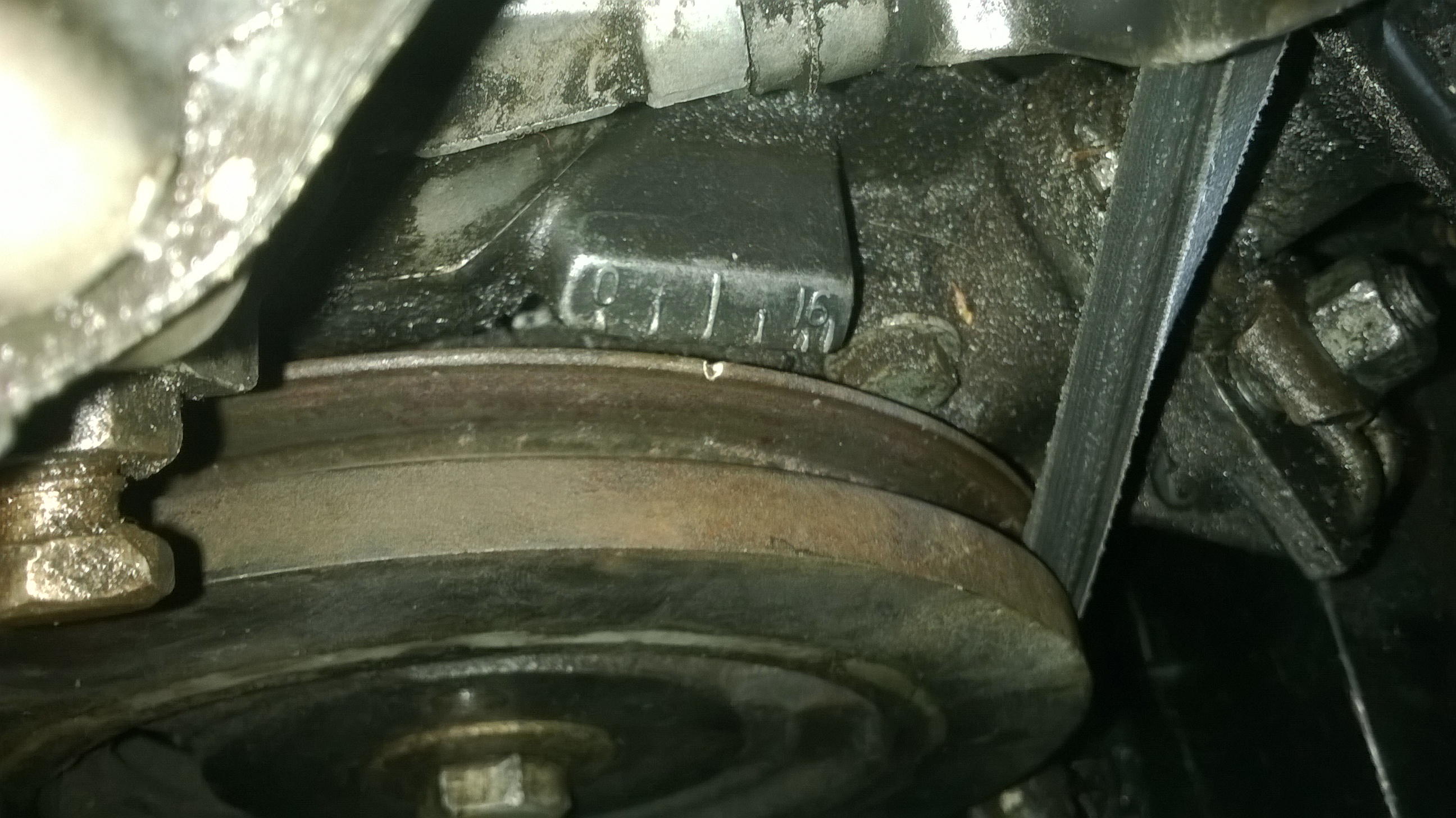

So the first thing i'm gonna try is setting the ignition time right, i've got a flash lighter from a local shop that i can borrow but does anybody know were i can find the UDP mark on the harmonic balancer ? I can only find a small "dent "on the balancer (see picture) but not a mark ? or is the "dent" the UDP mark ?

That is the timing mark, make sure it lines up with the rest of the marks on the outer ring & inner ring on the harmonic balancer. You should be able to see two more lines closer to the bolt. The outer part & inner part are laminated together & can sometime slip & the lines don't line up. It they are all in line you are fine. Be sure to click on the photo to enlarge it to see it better. Someone correct if i'm not right but i'm running my 64 at 14 BTDC & think the late model is 12 to 14 also.

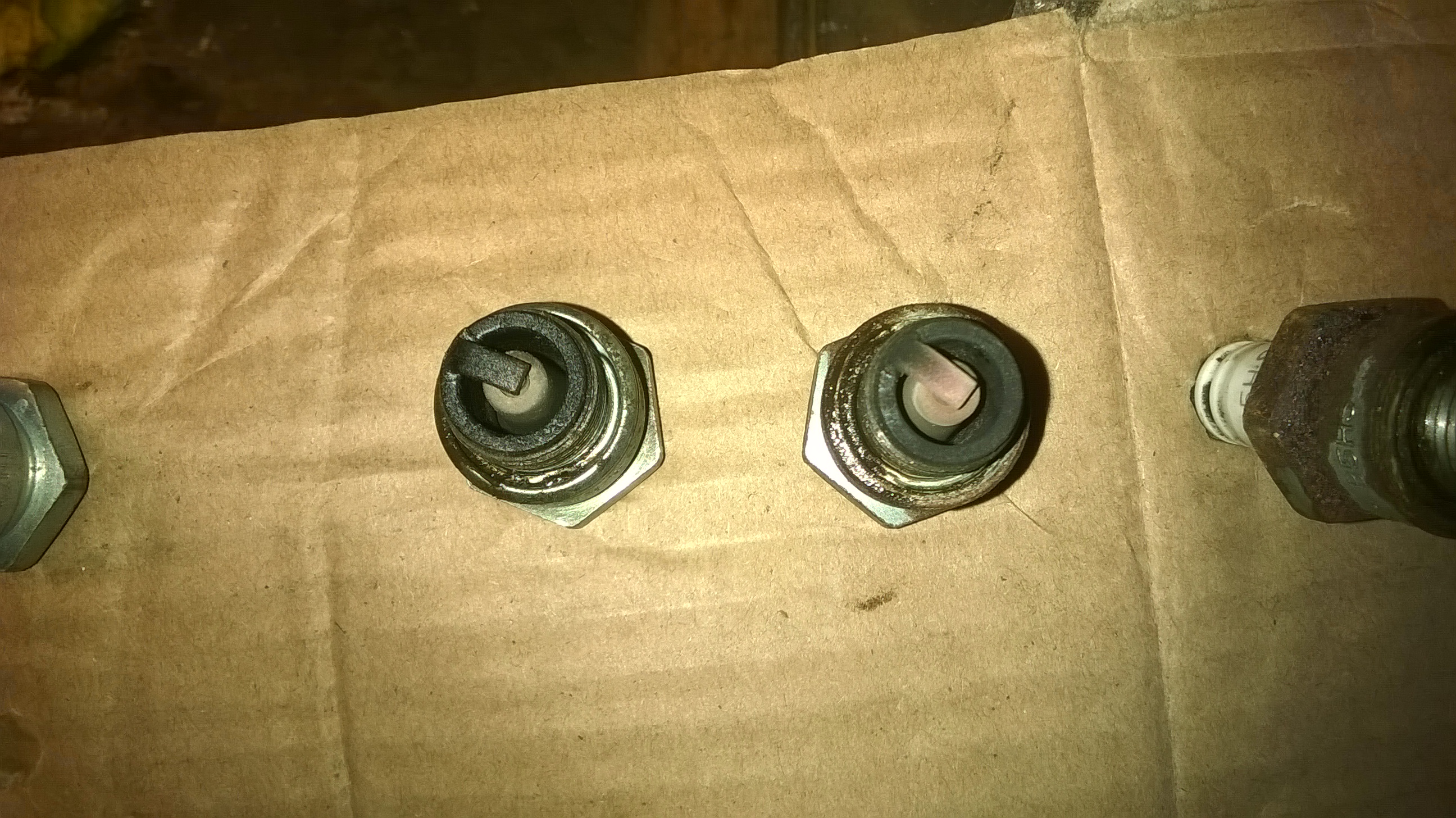

The garage told me that it's probaly a matter of adjusting the carburateurs and the timing and the right spark plugs.
some of the plugs have a white color. (a sign of the wrong mix of fuel and air)
