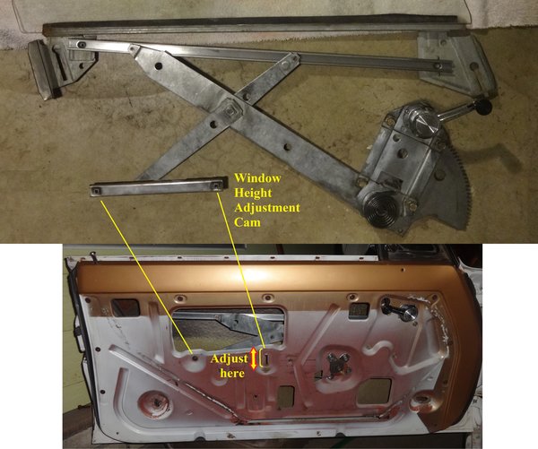

Here is a look at how all of the parts of the window mechanism fit together:
First, this is the Front Door Window Mechanism in the Rolled Down position (imagine a phantom door over it): This is the Front Door Window Mechanism in the Rolled Up position (imagine a phantom door over it): Window front edge height (angle) adjustment using short cam follower :
Move adjustable end of this cam up to raise the front edge of window, down to lower it
(The window glass "pivots" on the lower rear corner of the glass, so to speak, to make the top edge horizontal, if it's not already?) These are the attachment points with screws (as opposed to bolts) that hold the window brackets to the longer cam channel:

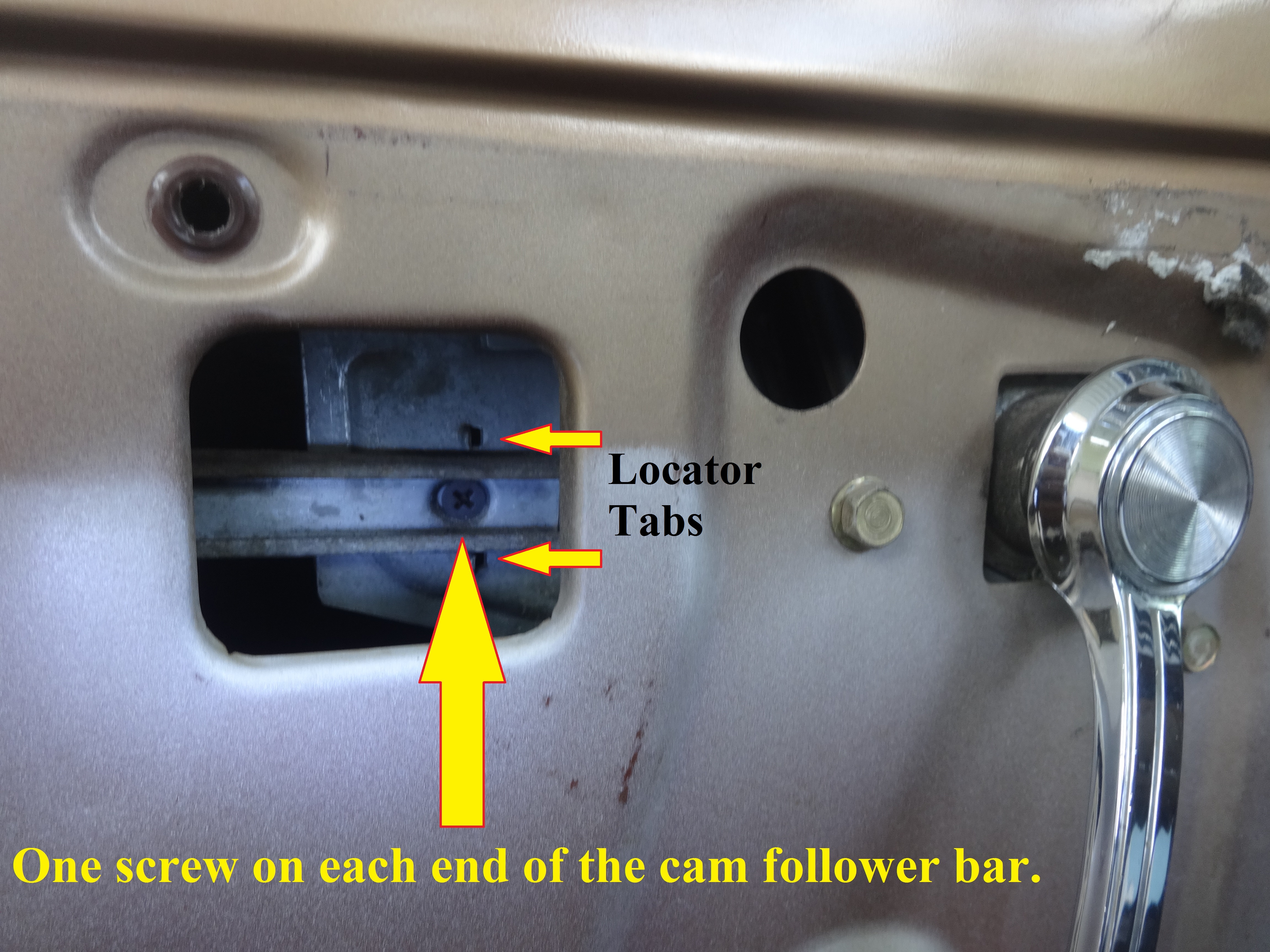

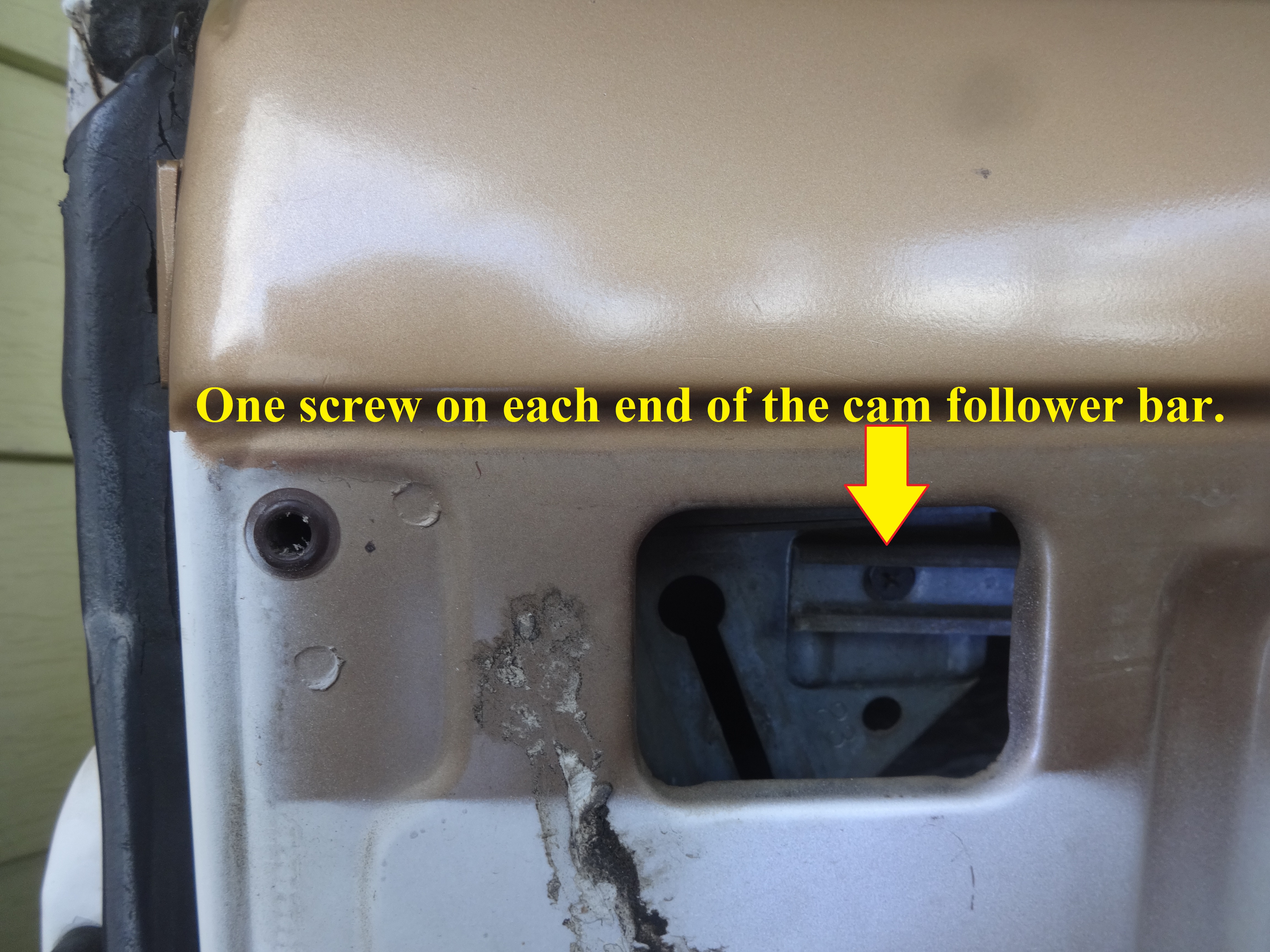

Window to Cam Channel Attachment Screw Location-Back :
(When re-installing glass, attach this end first because the forward end has locator tabs, but the back one doesn't.) Window to Cam Channel Attachment Screw Location-Front :

My '65 convertible's front-left window isn't secure when down; it rattles and hits the door when I shut the door. When looking down into the window opening the outer rear edge of the glass is pushed against the outer fuzzy. See picture:
The front of the glass is pushed against the inner fuzzy.
Is there an adjustment to make the glass more parallel with the opening?
Is there a way to better secure the window so it's not rattling around in the door?

The rear window track is adjustable in and out at the adjustment stud near the bottom of the track, which will change the angle of the window in the door. The track is also adjustable up and down which affects the length of the space between it and the vent window channel. If the window has too much forward and rearward movement the track needs to move up some to make this length shorter. To tip the glass away from the outer door skin the lower adjuster needs to be made longer. Door panel removal is necessary to make these adjustments to access the lower adjuster nut and stud. Be sure that the water paper is intact between the door panel and the steel of the door so water can not get on the inside of the cardboard door panel and ruin it.STB2000 wrote: ↑Mon Oct 18, 2021 5:31 pm My '65 convertible's front-left window isn't secure when down; it rattles and hits the door when I shut the door. When looking down into the window opening the outer rear edge of the glass is pushed against the outer fuzzy. See picture:
