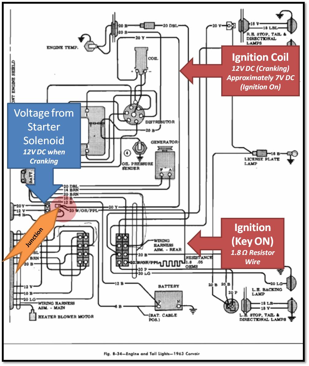

The nature of the wiring harness changes depends on the type of alternator installed. If the alternator is an original 1965-69 alternator with a stock external voltage regulator, the wiring should match the wiring diagram in the 1965 Corvair Chassis Shop Manual. The original generator voltage regulator would have been removed, and a standard 1965 and later voltage regulator would be in its place. The wiring harness would have been modified to match the 1965-69 configuration.
If a later design Delco alternator was installed (possibly with a greater amperage capacity and an internal voltage regulator) the external voltage regulator may have been removed or disconnected. The alternator wiring may be a single wire or three wire configuration.
In any case, the ignition system should function as long as a battery is present. The charging system maintains the charge on the battery, but does not directly impact the wiring of the ignition system. The ignition coil positive terminal should have approximately 7V DC present whenever the ignition key is in the ON position. (The voltage is reduced by a ballast resistor in the circuit, to help prolong the life of the ignition points by reducing the voltage and current flow across the ignition points when they open and close).
There is a spliced connection in the wiring harness that also connects the ignition coll positive terminal to a wire that comes from the starter solenoid. This second connection boosts the coil source voltage from approximately 7V DC to approximately 12V DC whenever the ignition switch is turned to START and the solenoid engages the starter motor to crank the engine. While the engine is being cranked the coil voltage primary circuit is temporarily increased to a full 12 volts to boost the secondary spark voltage to a higher level. This makes it easier to fire the spark plugs while cranking the engine, which promotes easier starting. When the engine starts and the driver releases the ignition switch, the solenoid turns the starter motor off, disengages the starter, and discontinues providing 12V DC to the coil. This reduces the coil primary voltage back to approximately 7V DC, which is adequate to keep the engine running while also prolonging the life of the ignition points.
Left-click the image with your mouse to enlarge the image for better viewing...
1963 Ignition Wiring Diagram
This wiring diagram (below) is for the 1963 Forward Control (Truck and Van) configuration. There are some differences in the wiring configuration between the car and the FC vehicle. On the car, the splice between the solenoid wire and the ignition switch wire occurs at a two-pin connector in the engine compartment, near the starter. On the truck, the 8-pin connector has a different shape, and the starter solenoid wire (20 Y — 20 Gauge Yellow) passes through a 2-pin connector and then continues to the 8-pin connector. The wire changes color as it leaves the 8-pin connector (20 BRN — 20 Gauge Brown) and then it continues all the way to the ignition coil positive terminal. This is the wire that provides a full 12V DC when the starter solenoid is engaged.
The other ignition coil wire is labeled 20 Y (20 Gauge Yellow) as it comes form the ignition switch. After it passes through the 8-pin multi-connector, the color code changes to 20 W/R/B. It then passes through a special resistor wire in the wiring harness, which reduces the voltage from a nominal 12V DC to approximately 7V DC. The wire continues on to the same ignition coil positive terminal, where it connects along with the other 20 BRN wire. The 20 W/R/B wire should show 7V DC between it and GROUND whenever the ignition key is on. The 20 BRN wire is only "hot" when the starter solenoid is engaged and the starter motor is cranking the engine. During those periods the 20 BRN wire provides full battery voltage (12V DC).

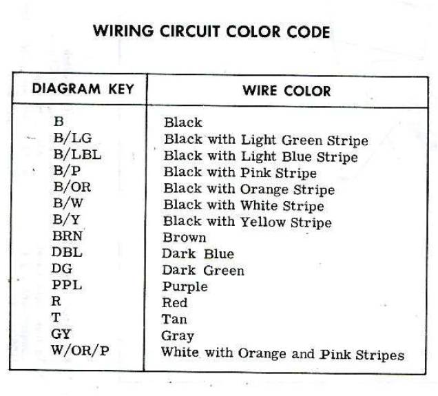

Voltage to the ignition coil comes from two sources. With the key ON, voltage is provided from the ignition switch in the instrument panel, and is routed through the 8-pin multi-connector in the engine compartment. This multi-connector is sometimes a source of trouble, because the electrical connections inside the connector can become loose, bent, or corroded — preventing voltage from the ignition switch from making it past the multi-connector. If you do not measure voltage at the coil positive terminal when the key is on, you will need to backtrack from the coil in the direction of the ignition switch to determine where the fault is. Since vibration, moisture and heat in the engine compartment can cause problems with the 8-pin multi-connector in the engine compartment, you should start by checking at this connection point.
Another common fault is the negative coil terminal wire that connects to the distributor. This wire provides a GROUND connection whenever the ignition points are closed, which energizes the coil primary circuit with voltage at the positive terminal and a GROUND at the negative terminal. If this wire is faulty, the coil will not "see" a ground connection when the points are closed, so the coil will never energize. This short wire between the coil and the distributor flexes internally whenever the vacuum advance moves the breaker plate. Over the years the internal wire strands can break down and provide a faulty or intermittent connection. When the points are closed, you can disconnect the wire from the negative coil terminal and you can use an ohm meter to check for continuity between the wire and chassis ground. If you do not measure a ground through the wire and ignition points, and the distributor housing to GROUND, you will need to determine the cause of the fault. If the wire proves to be faulty it will need to be replaced.

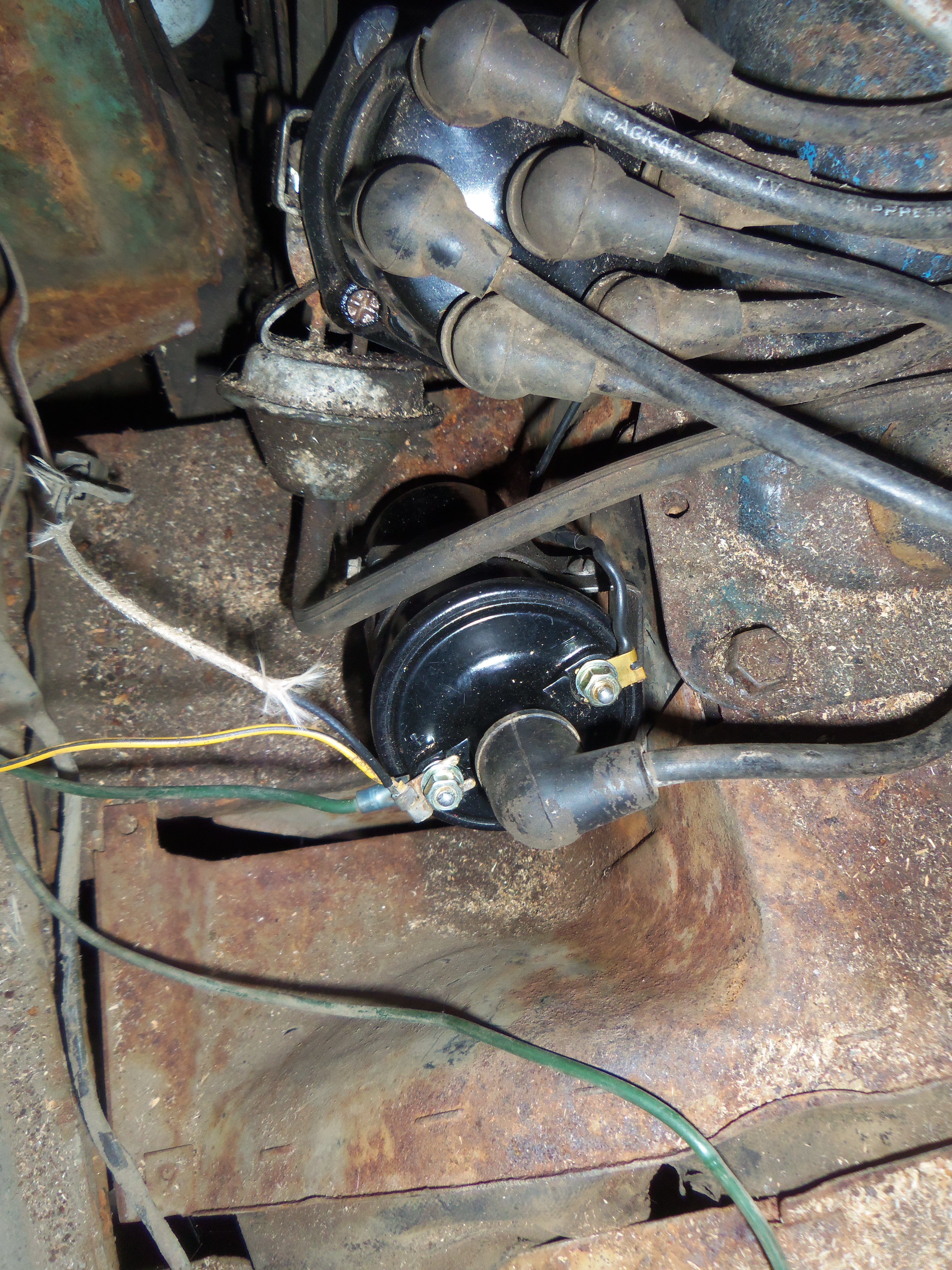

Thank you, I am going out of town for the weekend, but will take some pictures of my coil Monday and post them. It threw me off because there is a black wire and a yellow wire with black stripe going to the positive side of the coil as well as a green wire from the regulator and none of that is in the wiring diagrams.

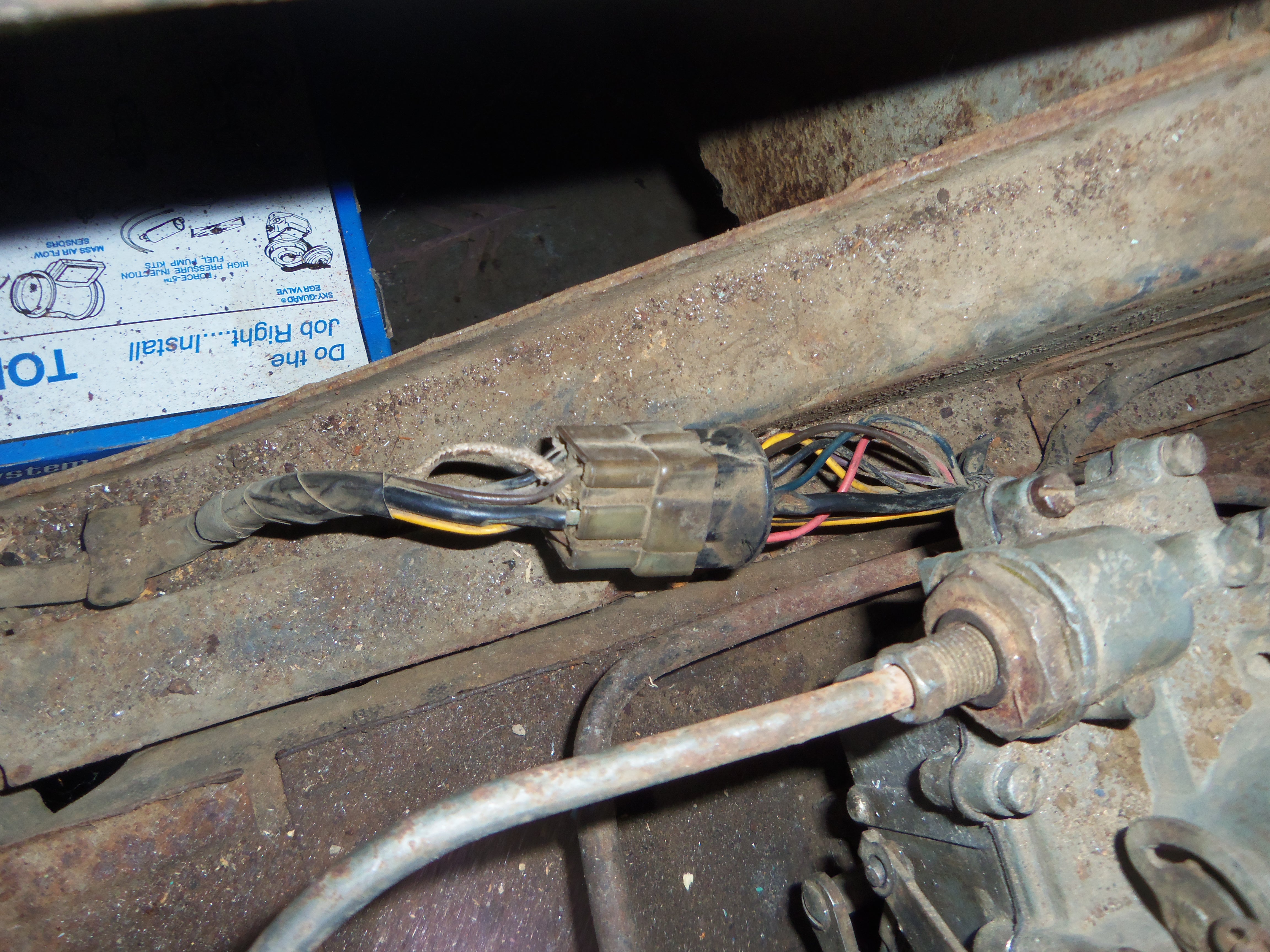

I'm not sure what the brown wire that's cut goes to...

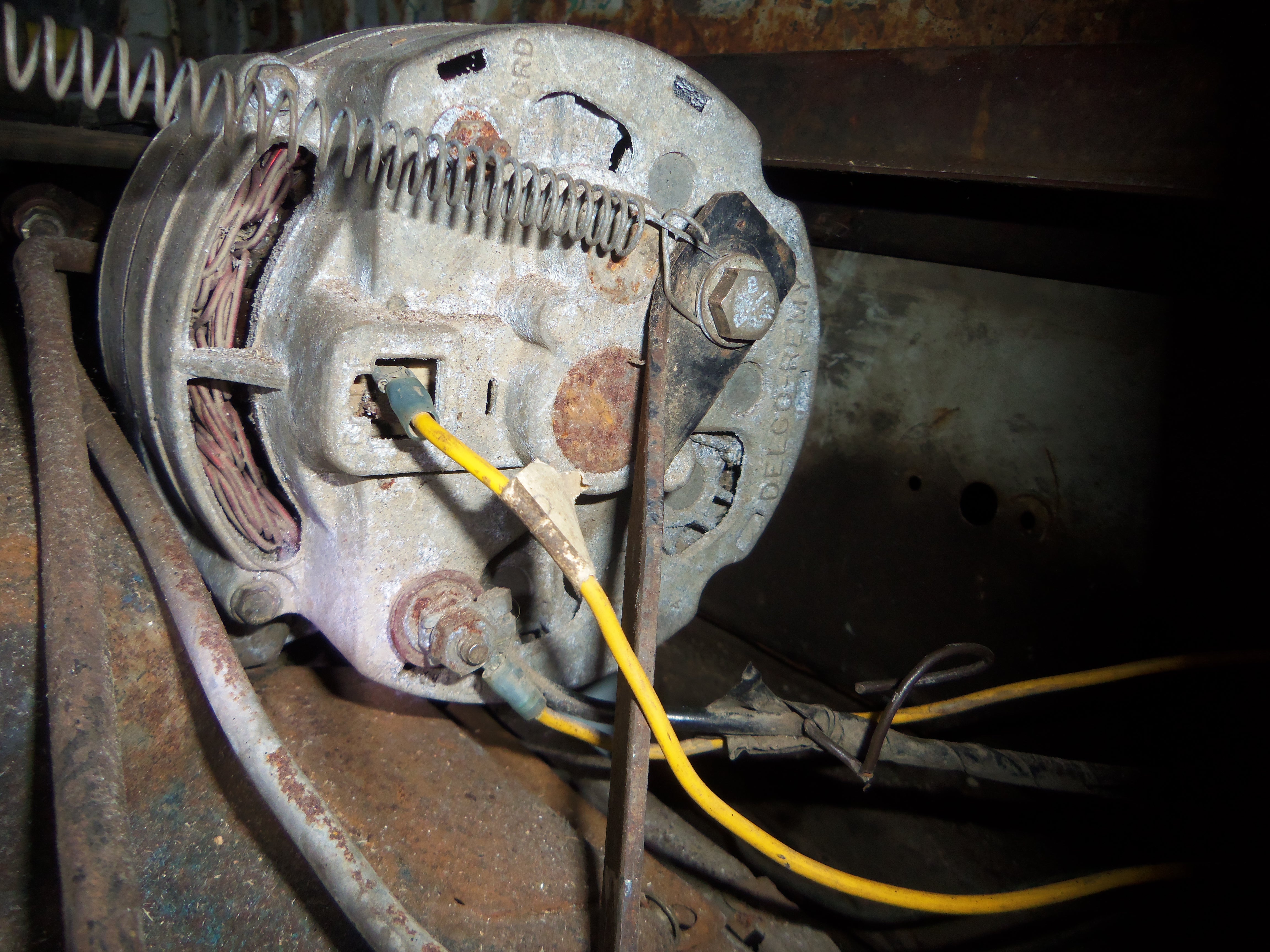

The engine wiring harness, I took it apart and pushed the connectors through one at a time and cleaned them up.  Eventually I will replace it, but it has continuity across the connector.  I was suspicious of it because of the stripped spot on either side of the connector on the black wire going to the alternator.
The top yellow wire goes to the top yellow wire on the alternator and the bottom yellow wire is the one on the alternator connected at the same point as the black wire.  The green wire is the one connected to the positive side of the coil primary along with the yellow/black stripe wire and the black wire.  There was nothing connected to the fourth position on the regulator.
I'm not sure, is the black wire with the cloth like covering the resistor wire in the diagram?  I replaced the coil thinking it was an inexpensive part that probably would need changed out anyway along with the points and condenser.
Re: Hello all
Try getting a voltmeter (or at least a test light) on the "+" side of that coil, with the key on and also while somebody is cranking it. I'd start there. There's a possibility that those wiring harness connectors aren't delivering the current too, due to years of corrosion.
