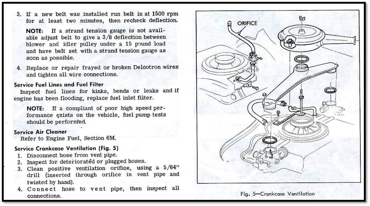

Did you disconnect the vacuum tube on the side of the crankcase breather tube and check the fixed orifice to make sure it is clear and clean? If it is clogged a significant part of the PCV system would not be functioning properly.
From the 1965 Corvair Chassis Shop Manual, Page 6-5...
