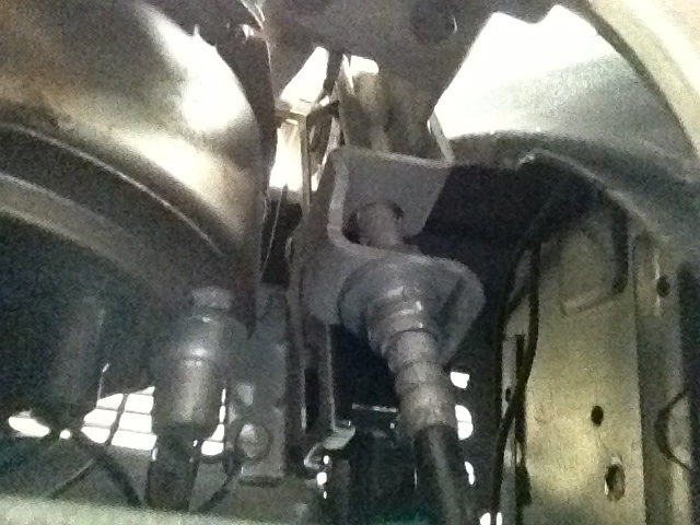

See photo of my cable, taken from underneath looking up. Where is the "clip" that needs to come out? Is it in this picture?
Thanks.

Bogey,
To remove the nut on the cable housing I used needle nosed fliers on the nut from the top and a small
vise grips on the back of the housing. The C-clip is on the end of the cable located just out of view
at the top of your picture. Access from the radio side of the dash. It is very small. I popped it with a very small screw driver.
Rod

Hey Bogey,
Looking down from above the C-clip is located 3/4 inch behind where the shift handle
goes thru the dash panel. It may be helpful to remove the nuts that hold the shift mechanism
to the dash. This will allow you to turn the shifter a little for a better view. I hope this helps.
Rod

Extremely helpful! I see it now. I ended up shifting to low gear and that really exposed it. Thank you so much. I'm learning from the best. I'll get back at it and disconnect it tonight. The nut was obtainable from the radio side, 5/8" wrench with a whole bunch of super short turns.
