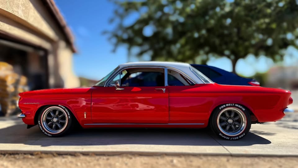

I run 16x8 rear and 16x7 front. These wheels are aftermarket wheels off a Nissan 240SX.
