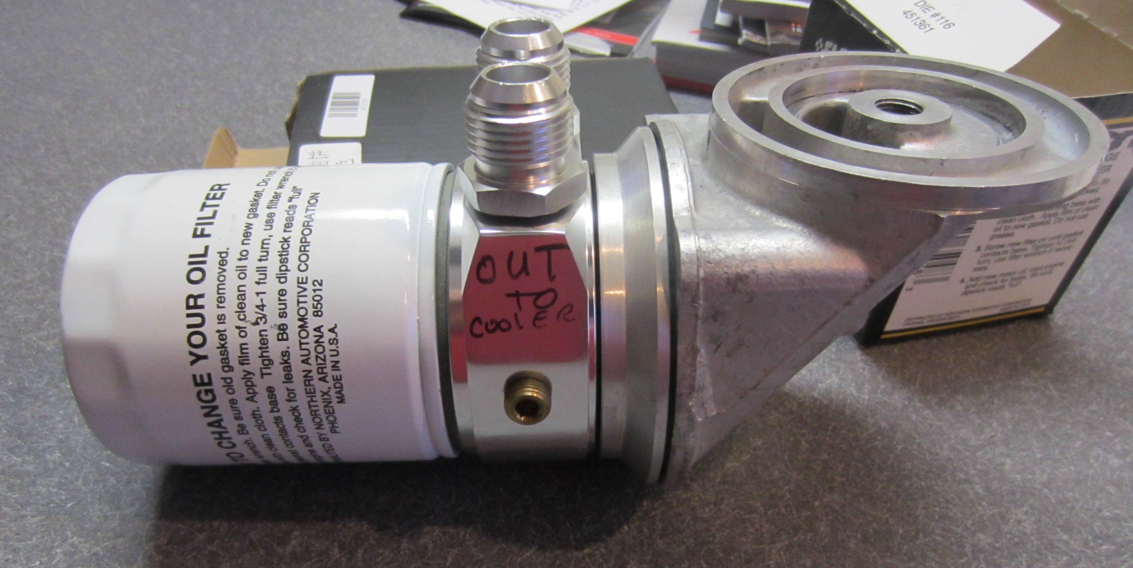

You could install an external cooler, combined with a larger "spin-on" filter. Like this:
Corvair Enthusiast.

Wouldn't there be an issue with belt install with the adapter Seth posted. How would you get around that?
1962 700 Wagon
1963 Spyder convertable
1965 Monza
1967 UltraVan 211
SpyderMan
Posts: 245
Location: Durham NC
Re: *Additional* oil cooler
Post by SpyderMan »
Most leave an extra belt already captured so if the loose one you can just put the next one on. It would be a pain.

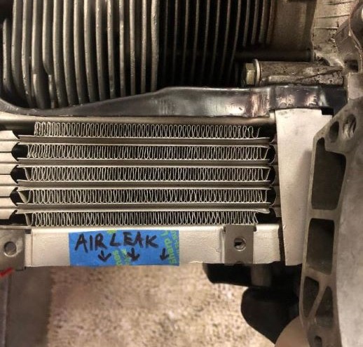

SpyderMan and Nashfan have described the cooling system I am using on my turbo engine. :tu:
Folded fin cooler + airflow pulley + bellmouth with mag fan. Engine head temps stay cool (no oil temp gauge) even during hot/humid days pushing the wastegate open. I have to admit that water-methanol injection is also helping me keep it cool.
I did make one improvement when i discovered an air leak... The top shroud was leaking air under the oil cooler cover plate. It was easy to detect under the alternator where cooler cover plate is installed on the running engine. There was a substantial air blast (leak) there.
oil cooler air flow leak above flange.jpg (81.64 KiB) Viewed 609 times
The seal was made from a turbo inlet pipe collar. Cut to length and inserted under the shroud, held in place by cover plate screws.
