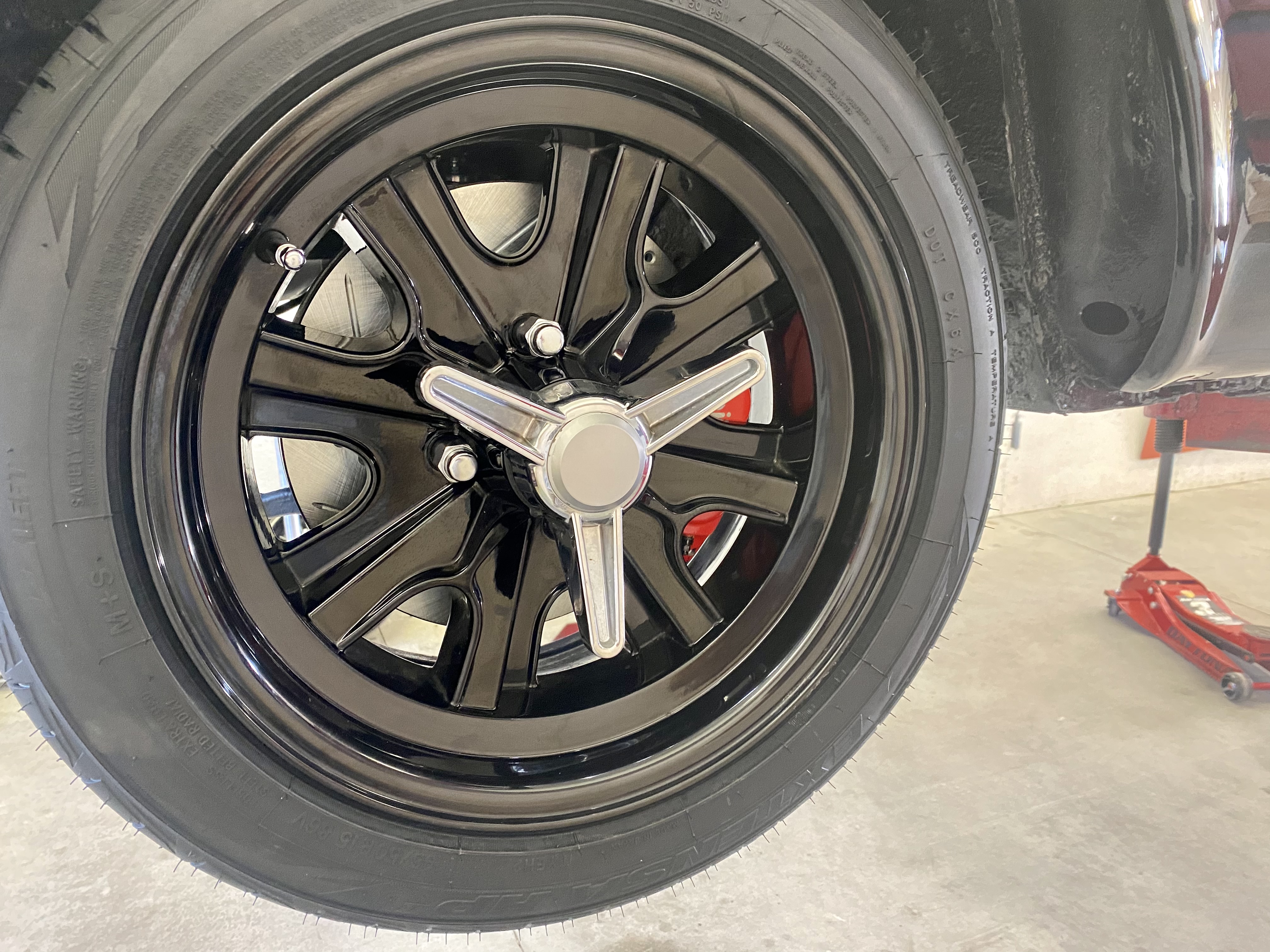

Re: Disc brakes on the 60
Post by Holyroller »
Problem is wheel hits side of caliper . If I put a spacer studs won’t be long enough . Guess I could get longer studs pressed in . Any suggestions
Post by StukintheMud »
they look great! I put longer studs when I did mine. Are you doing the rears, too?
Post by steptoe »
Holyroller I put front discs on my '64 Monza Coupe and can't stop the car. Using the Scarebird Kit and early Camaro calipers. Bought a special dual port master cylinder from Speedway Motors which is supposed to work for Manual or Power brake systems. It hasn't helped much. I need a power booster but no where to mount it on an early model. I have ordered a different combination valve and am hoping that will solve the problem. Question is do your brakes work OK? Did you mount a power booster? What master cylinder/combination valve are you using? Any suggestions for getting my setup working right? Thanks, David.
Post by joelsplace »
Tons of people have installed front disks without power assist and it has worked fine for them. You have something wrong.
What diameter is the master cylinder?
Holyroller
Posts: 69
Joined: Sun Nov 01, 2020 7:56 am
Location: Hesperia
I have willow pod and stock new master that came with 60 works great so far
