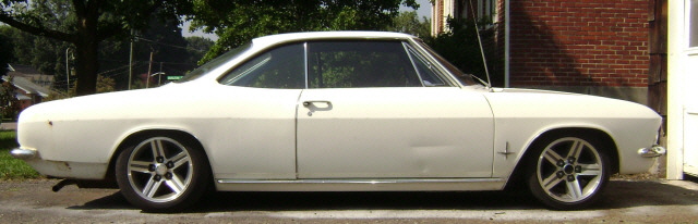

Re: 16 inch IROC wheels
I have 16 inch Irocs on my street car. You must install the rims marked front on the rear and vice versa... This is due to the backspacing. Tire size you need depends on ride height. I lower my cars drastically. I run 205 40 16 in the front with 225 50 16 in the rear. I work in the Tire business and find that low profile 16 inch tires are hard to find. Sizes that are avialable are 205/40/16 215/50/16 225/50/16 and there are some 225 45 16 in racing tires.
- whitecarsideview.jpg (91.16 KiB) Viewed 4935 times
