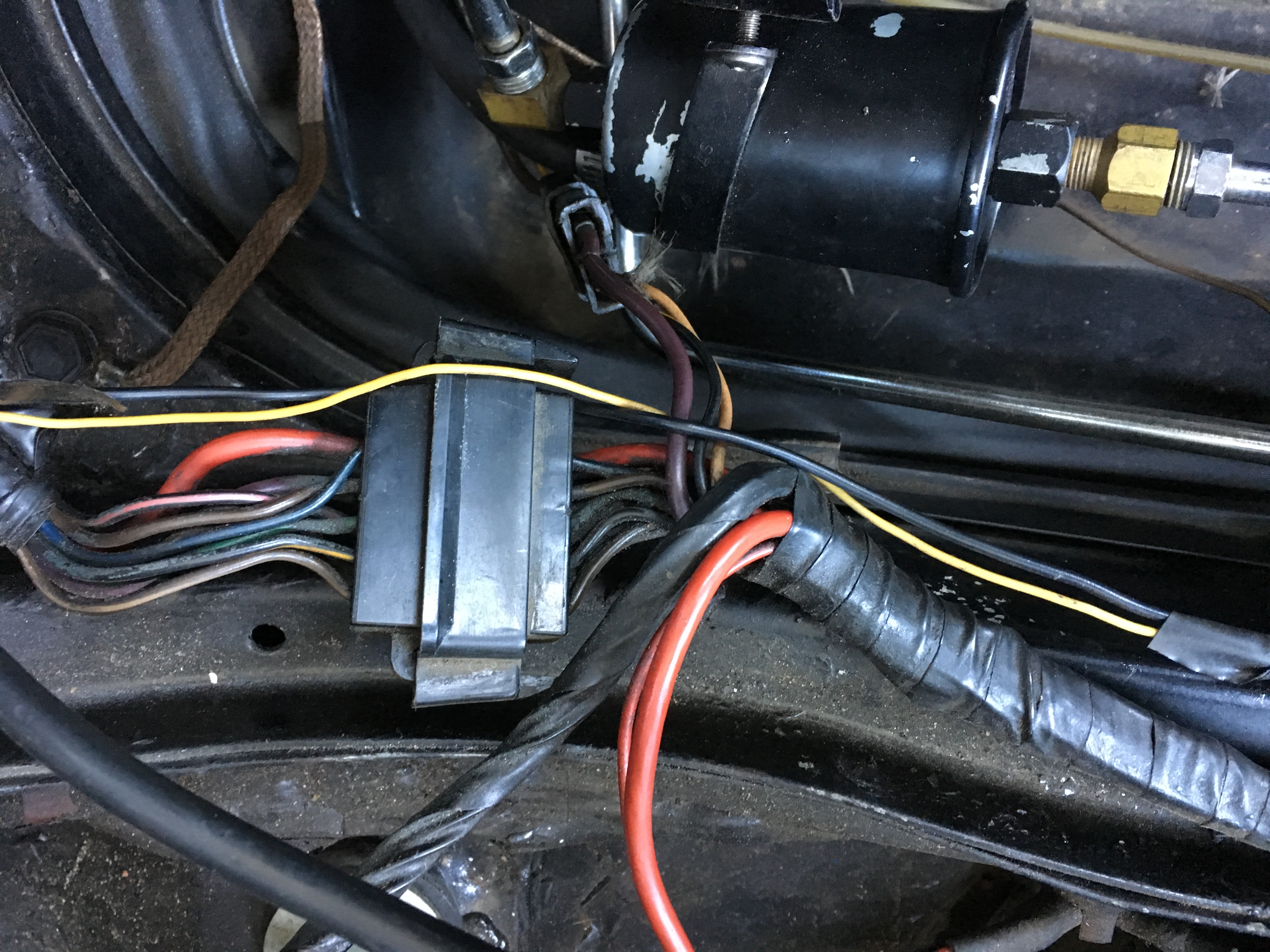

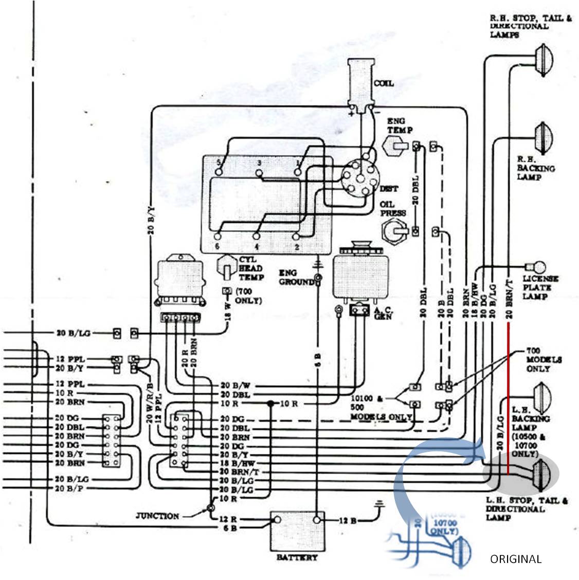

Hi everyone. Ok here is a picture of my main harness which of this group is the ignition wire I should splice into for my electric choke. 12v when key turned. I just cant tell.

Correct. The instructions say tap into a keyed 12v supply. I have been trying to find one with the multimeter and shop/assembly manuals. But no luck figuring which one would work. I was hoping someone already did this.

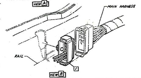

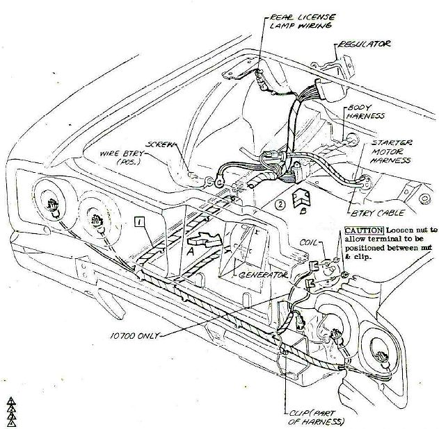

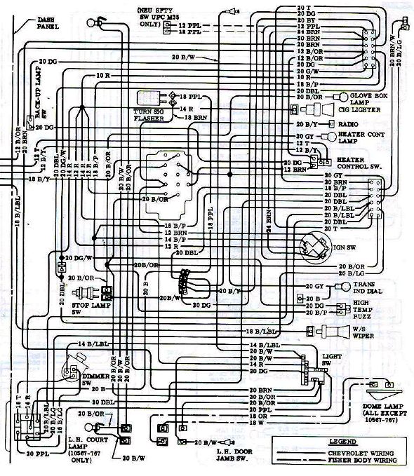

If you trace the switched ignition wire back from the coil (20 B/Y), past the resistor wire (20 W/R/B), you will see it is connected to a 20 B/P (20 Gauge Black with Pink Stripe) wire on the firewall side of the multi-connector. Tracing it back all the way to the wiring harness inside the car you will find it becomes a slightly thicker 18 B/P wire, and leads to a wiring harness junction point that is fed ultimately by a thicker 14 B/P switched power source at the ignition switch. (Each time the wire gauge thickens, it is provided more current-handling capacity as more circuits are added to the mix).
If you tap into the 20 B/P wire at the firewall side of the multi-connector, you will have a 12 VDC switched power source that is controlled by the ignition key, providing power when the key is ON. If your add-on choke control is a low-current, short duration power load, it should not over-tax the circuit that would feed both the coil and the choke control circuit.
If your choke device needed continuous, unswitched 12 VDC you could pick that up at the point where the thick 12R (12 Gauge Red) secondary wire from the battery positive terminal meets the junction connector near the battery.
Left-click on each image to enlarge for better viewing...

Black with a pink stripe on the firewall side of the harness I have that one. My elec choke is the one from clarks. Thank you brad that you saved me a lot of trial and error
