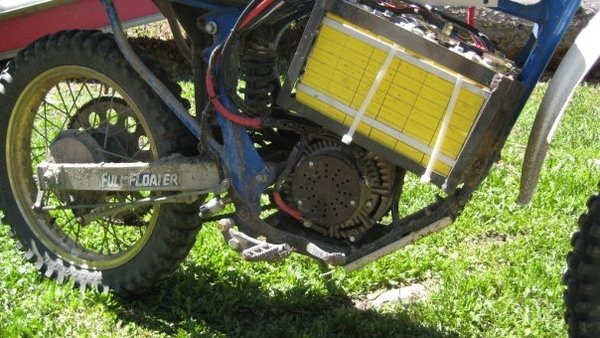

So here's the motor I'm talking about, the first pic is the dirt bike conversion I used it for, the outboard motor was the original purpose for this motor when it was built by Briggs and Stratton.

I'd be running motor and engine together, with the motor just providing some assist to the engine. I think a belt drive will suffice for this, but some experimentation will tell. When the engine is running, it can charge the battery pack, so no need to set up a clutch system. The speed controller provides pretty smooth motor control, so there shouldn't be a lot of shock in the system.

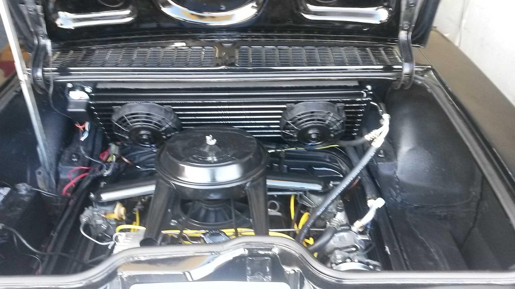

good afternoon
I thought I had some pics of the bracket without the compressor mounted but could not tfind them
here a few anyway
hope these help some
Hank

This is an interesting idea! My thoughts are to leave the existing V-belt drive alone and power through an extra pulley much like the A/C picture above. I also think the stock V-belt isn't up to the torque required to do the job. The mention of a toothed belt is probably your best bet.
