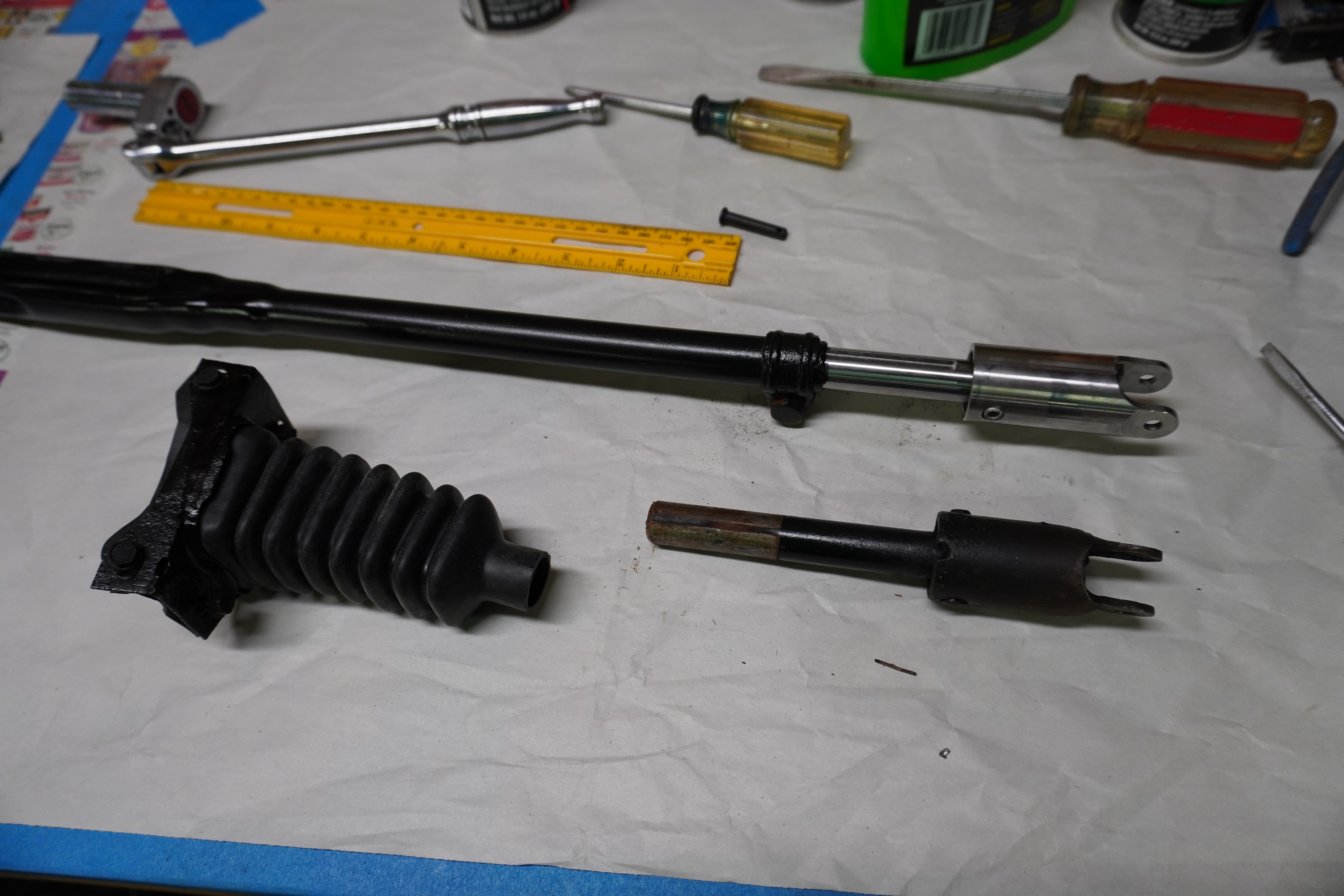

The shift clevis was very sloppy, so I ordered another one from Clarks. The holes were wallowed out some, but the rubber part is still OK. Trying to be more accurate with the adjustment, I ordered the nylon lined unit. Well, the shafts are not lined up well at all and I cannot get the pin in without pliers, too stiff. I guess the factory figured in a little wiggle room for it. We don't want a bind on the shaft bushing, so Plan B tomorrow. (there are a lot of posts about this, too. Thanks). I also forgot to order a shaft seal so now I wait for that.

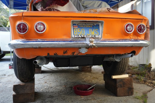

The view from the rear is interesting with the cut-out for a turbo exhaust and the "dog legs" for the air grille modified so the lower body line goes straight across.
It's funny that my mind went straight to thinking it's a 63 because of the tail lights.
The cool factor goes way up knowing the undercarriage got bent up while being used and abused.
I'd like to see how the rear wheel wells were modified.

Can you take a pic of the trailer hitch mounting for me?

Chad, here are your pics of a Corvair trailer hitch. Dad made this mainly for towing parade floats (never overheats), also for towing a tiny trailer with our camping gear. it also is very high due to the monster tires on the back. But that's how it's mounted. He even trimmed out the plate frame to cover the bolts. I wish I could ask him about Hatfield.
I was wondering about the back body as well, Jim. I had to look at a regular one to see how he did it. Dad was self-proclaimed, "My body work isn't worth beans" he would always say. I inherited that gene. It is actually the patience you need. He was mechanical, if it didn't do anything what's the point.

Thank you for putting those pictures up, I bought a similar hitch and have been looking for pictures of how it was mounted. I appreciate it!!

Got the shifter problems sorted and now have a Question: IS or IS-NOT the trans (4 speed) fluid shared with the differential. The manuals show separate capacities. I am changing the shifter shaft seal and might as well change the fluid. The trans does have a drain plug, and the cute red plastic label on the filler plug. . I read Bob Helt's book and No mention of shared fluid.

Thanks, I got a little carried away with my small amount of knowledge on these things. PG bell housings of course would be different. You are right Rex, if Dad didn't have one to use, he would have figured it out.
I did figure out the turn signal switch is bad from Brad Bodie's great wiring diagrams. That is the best description of how it works I have ever seen. I worked at Chevrolet for 20 years doing wiring, but didn't know the wire colors. The Kumquat is a mix of "63 & '64 stuff. It is cool not having to pull the steering wheel to diagnose the switch. I will be doing an autopsy on it.
