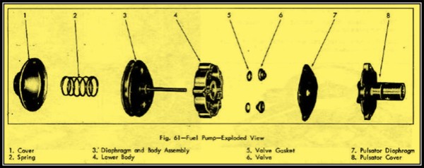

The mechanical pump operation is fairly simple, as described below. Other than poorly made diaphragms internally or a bad aluminum housing/casting, I cannot think of anything in the external pump environment that would cause a leak to form immediately after installation at the proper insertion depth (controlled/determined by the set screw indexing properly with the tapered hole in the side of the pump shaft).
The pump push rod is driven by a cam lobe on the crankshaft. The repeated "upstroke" causes the pump to form a vacuum in the feed line from the fuel source (tank or gas can). As the fuel is drawn into the pump chamber, the one-way valve in the pump inlet closes at the top of the stroke, and the spring in the pump forces the diaphragm back down to push the fuel out of the pump through the other one-way valve, toward the carburetors, with a designed fixed-pressure (determined by the spring) of 4-5 psi.
The fuel delivery system that included a fuel return line to the fuel tank was added by GM for the turbocharged engine configuration. A variation of that return system (using a brass cross connector at the mechanical fuel pump) was added in later years to keep fuel flowing in the gas lines when the carburetor fuel inlets (on non-turbo cars) shut off because the carburetor float bowls were full. When this occurred, the fuel flow would normally stop when the fuel pump spring could no longer push fuel in the direction of the carburetors. Providing a thin fuel return line (Z) from the pump back to the fuel tank allowed fuel to keep moving, even when the carburetor float bowls were full. The continuous fluid motion had the effect of keeping the circulating gasoline cool, which helped to prevent vapor lock in the steel fuel line in the hot engine compartment. (Vapor lock happens when your fuel boils in your carburetor or your fuel line. Vaporized fuel creates back pressure in your fuel system and prevents gas from getting to your engine. It commonly occurs when a car has been idling or has been turned off and then back on).
In any case, the length of the mechanical crankshaft cam-driven stroke is fixed by the proper insertion of the tapered set screw, which establishes the stroke depth of the push rod. The push rod only causes an upstroke that forms a vacuum in the inlet fuel line from the fuel tank —sucking fresh fuel from the tank. The spring in the pump cover is fixed in tension. If the outlet flow was blocked by the closed needle/seat assemblies in each carburetor float bowl, the pump diaphragm and body assembly (3) would simply remain in the up position until an open needle valve in a carburetor float bowl permitted more fuel flow. When the diaphragm descended to the bottom of its travel, the next push rod stroke would raise it up again — forming a vacuum to draw more fuel from the tank.
There is nothing in this simple pump mechanism to cause any damage to the pump seals or internal diaphragms. If the pump materials used in its manufacture were faulty or damaged during factory assembly, the pump may leak upon installation.

Mechanical Fuel Pump Exploded View
