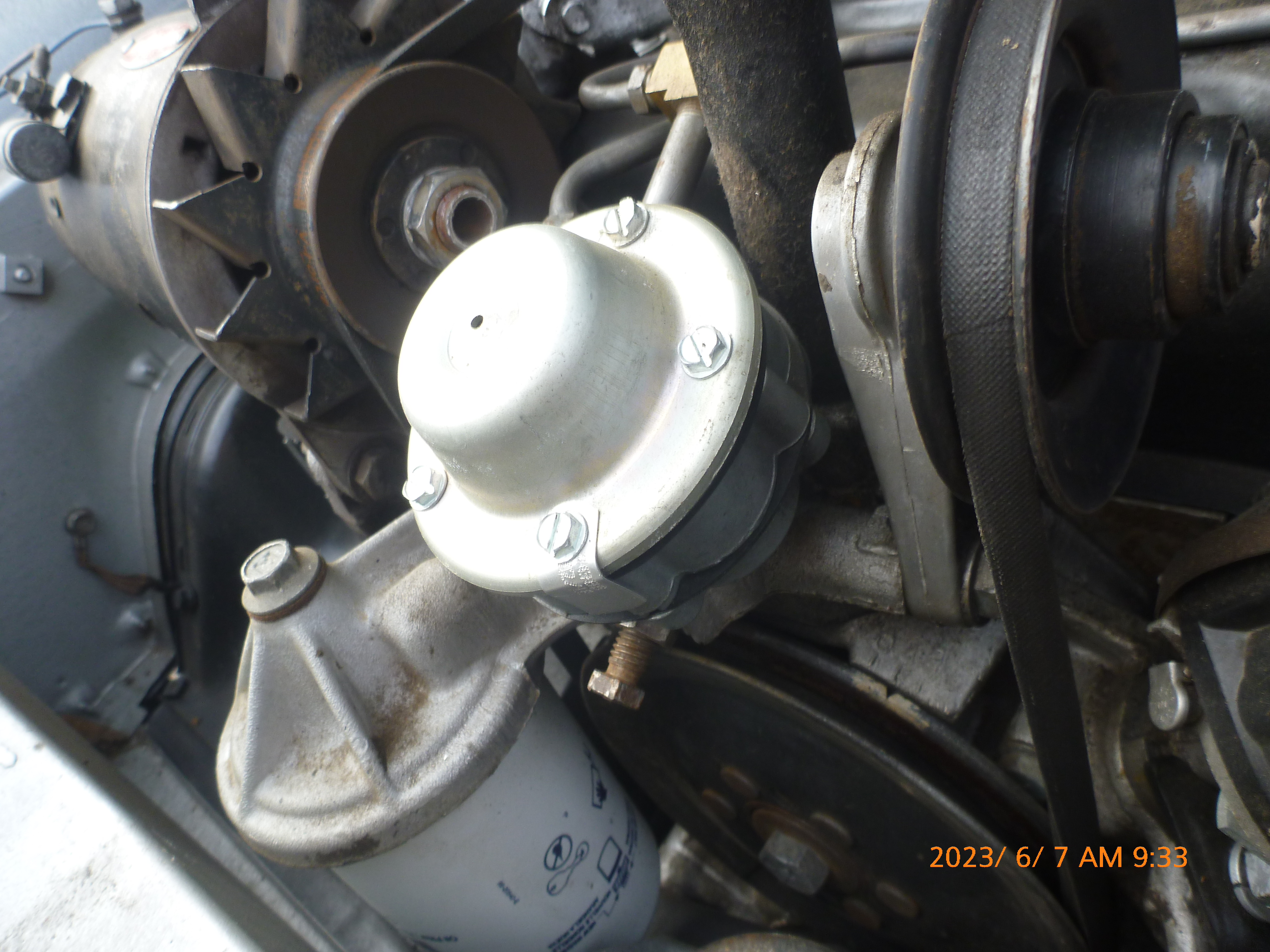

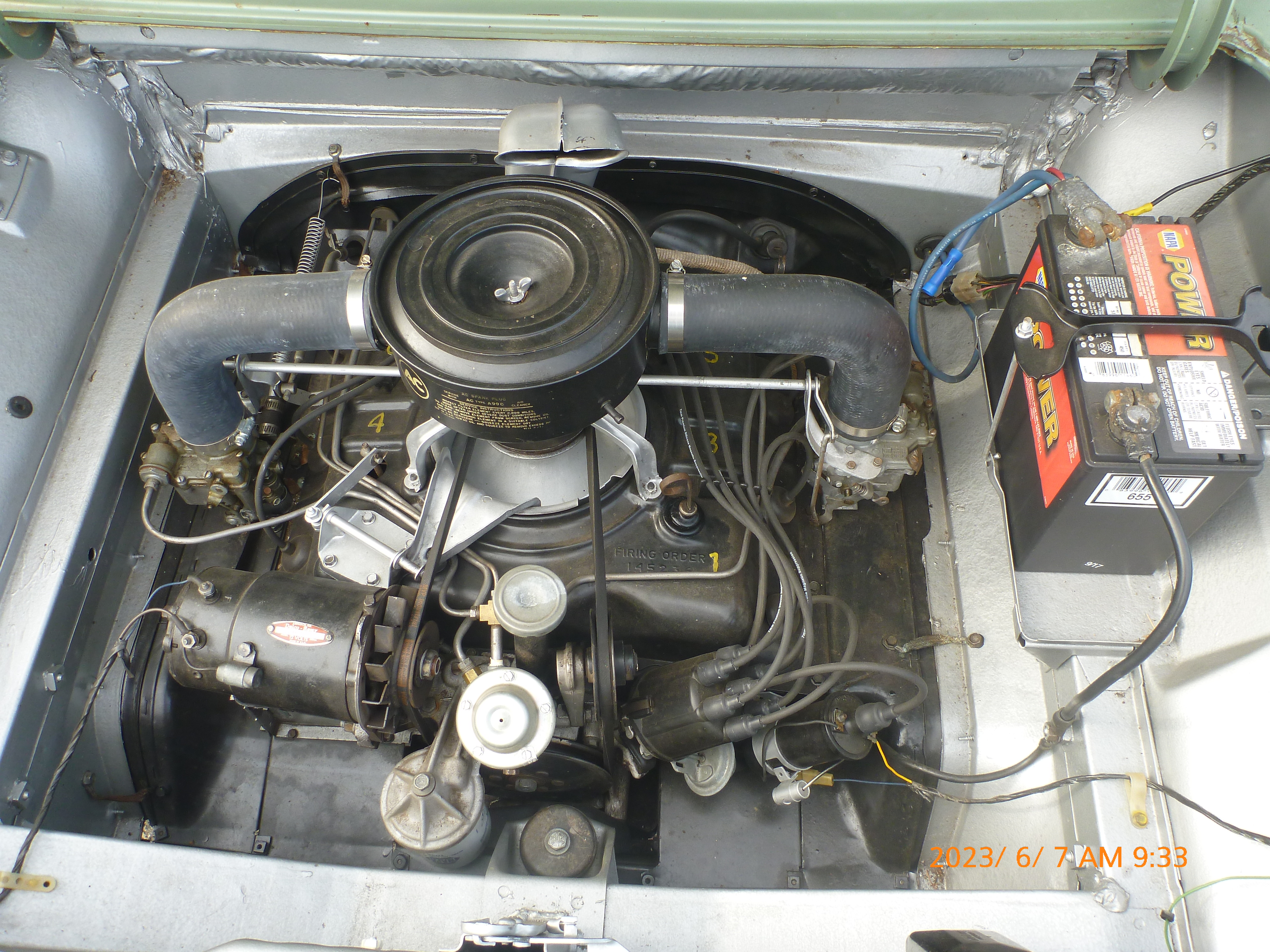

I am a very new Corvair owner and I just picked up a '60 cave car yesterday, so I apologize if this is a sortof inane question but what's the easiest way to tell if my fuel pump has a 60-61 or a 62-69 pump rod?

I believe you have to remove the pump and inspect it and the push rod. The catch is there is only about 1/16” difference between the 2 so looking at either one alone it is hard to tell.
Check out this post when I tried to replace my late model mechanical fuel pump. The pump with the retaining hole is a 62-69.
viewtopic.php?t=17361
Are you just curious or having an issue?

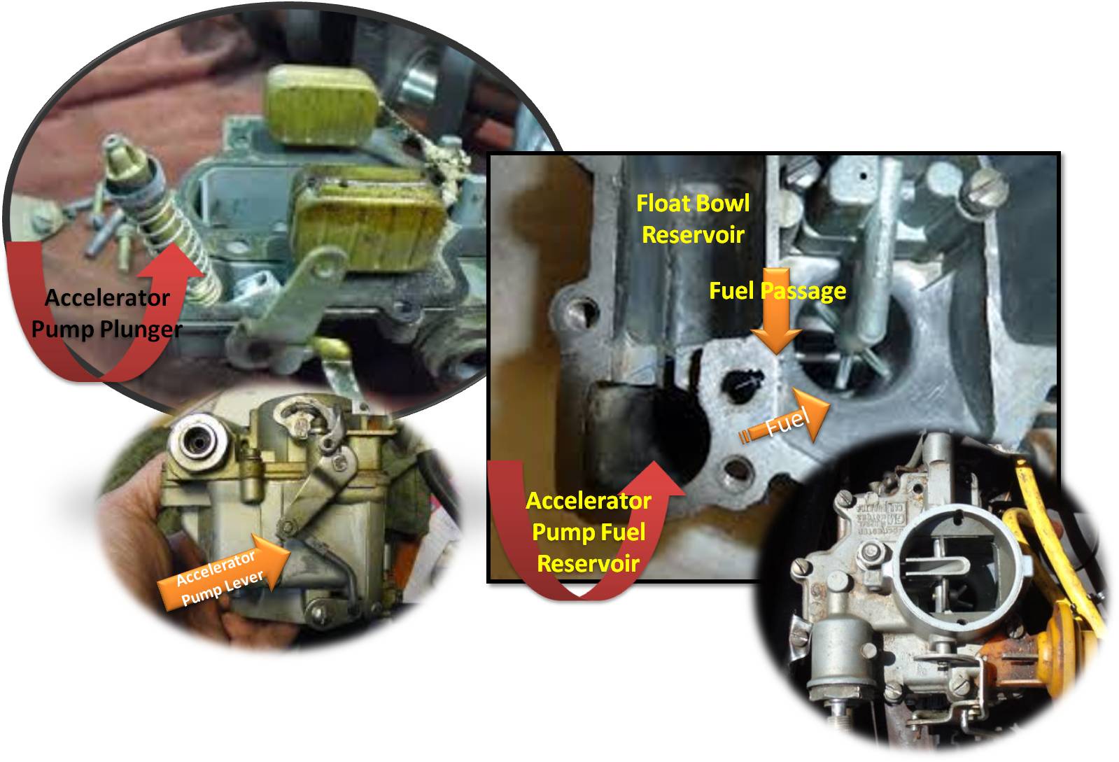

An indication that the fuel level is low in the float bowls might be observed by leaving the engine off when it has stalled and then looking down the throat of each carburetor while you manually open the throttle quickly. (Although the pictures were taken with the carburetors partially dismantled, the accelerator pump fuel-squirt action can be observed by simply removing the air cleaners and looking down each carburetor throat while holding the choke open and out of the way).
If the running engine has drained the float bowls, it is possible that some fuel may still remain in each accelerator pump reservoir. Try the test a few times to see if the reservoir is replenished by fuel in the float bowls. If you do not see a squirt of fuel into each carburetor throat when you open the throttle, the float bowls may be nearly empty, leaving no fuel to be pumped manually by the accelerator pump plunger into the carburetor throat...
