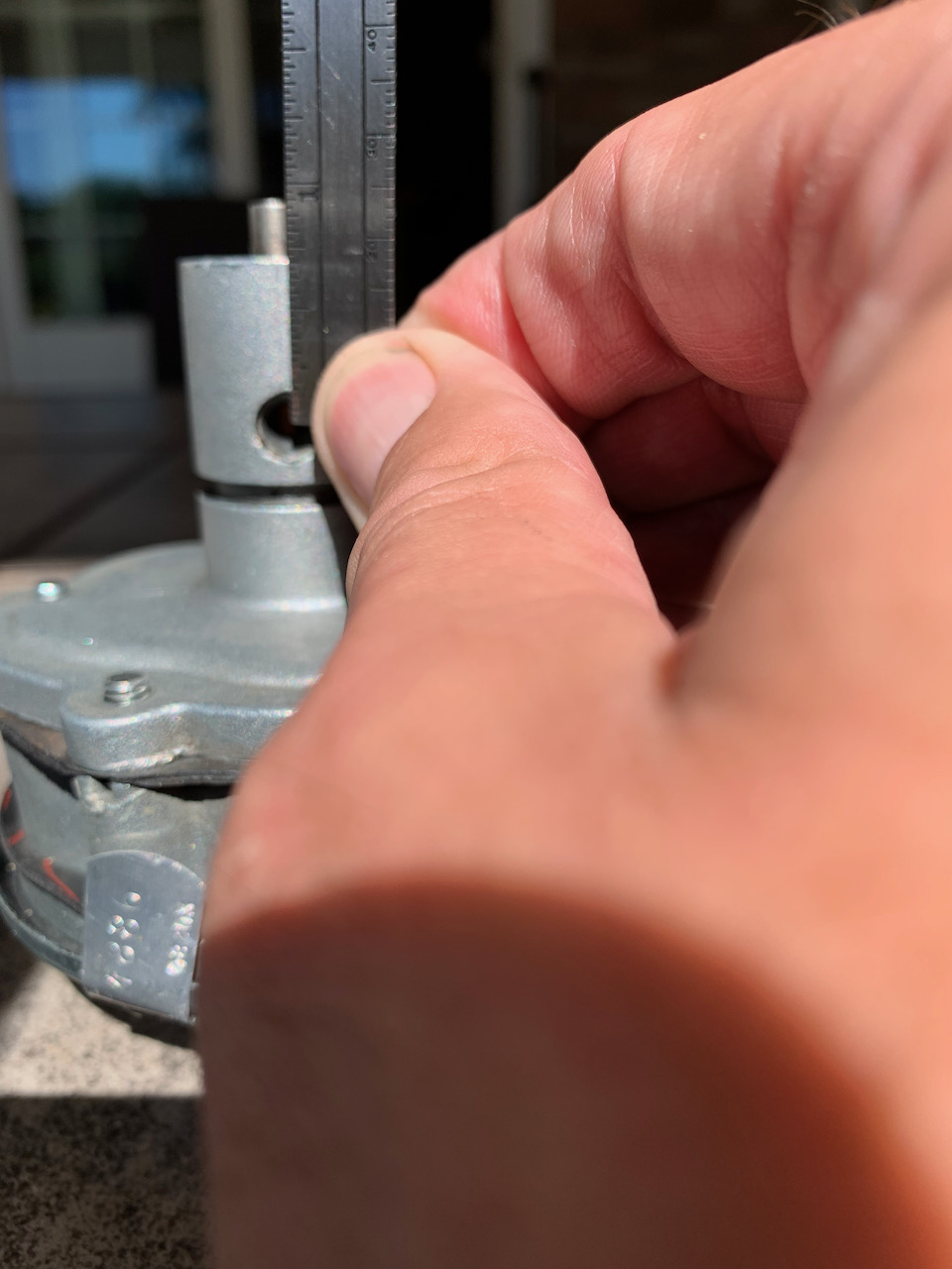

My existing Fuel Pump starting leaking again but this time screws started stripping before it stopped leaking.I purchased a replacement a while back but only took a quick glance at it when I received it. Now I see that it doesn't have the retaining hole drilled into it.
How does one position the retaining hole when the length of exposed shaft and the overall length of the boss are different than the old pump.
My gut is telling me I should position the hole relative to the end of the shaft since the shaft would then be in the same relative position to the mounting bolt and plunger as the old one was. Is that correct?
I just want to get it running now but an electric pump conversion may be in my future. Reading a lot of bad press on available Corvair mechanical fuel pumps these days.

The best answer is to source a proper fuel pump and deep six that junk new one. Personally I convert to electric pumps and forget about the trial and tribulations of new mechanical pumps which have been hit or miss for many years.
You would want to drill the hole at the same distance up from the end of the pump rod as the old one would be my thought on this. make sure it is in the correct place around the bottom of the pump to locate the output pipe facing straight forward like the original when mounted.
I would also suggest checking the output pressure once you get it mounted. Hopefully it is in the 2.5-5.5PSI range that is acceptable. A number of aftermarket pumps over the years have made too much pressure causing flooding.

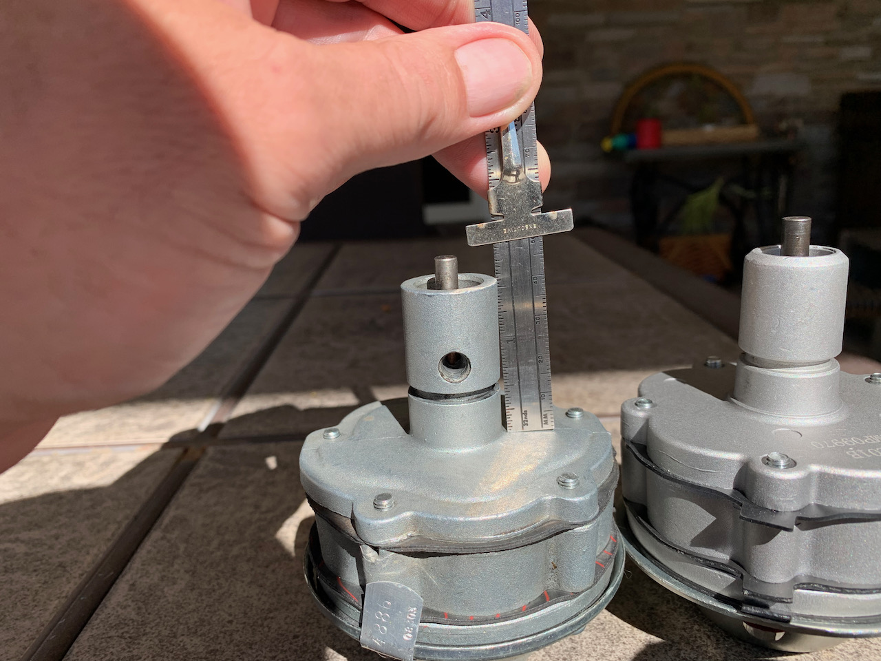

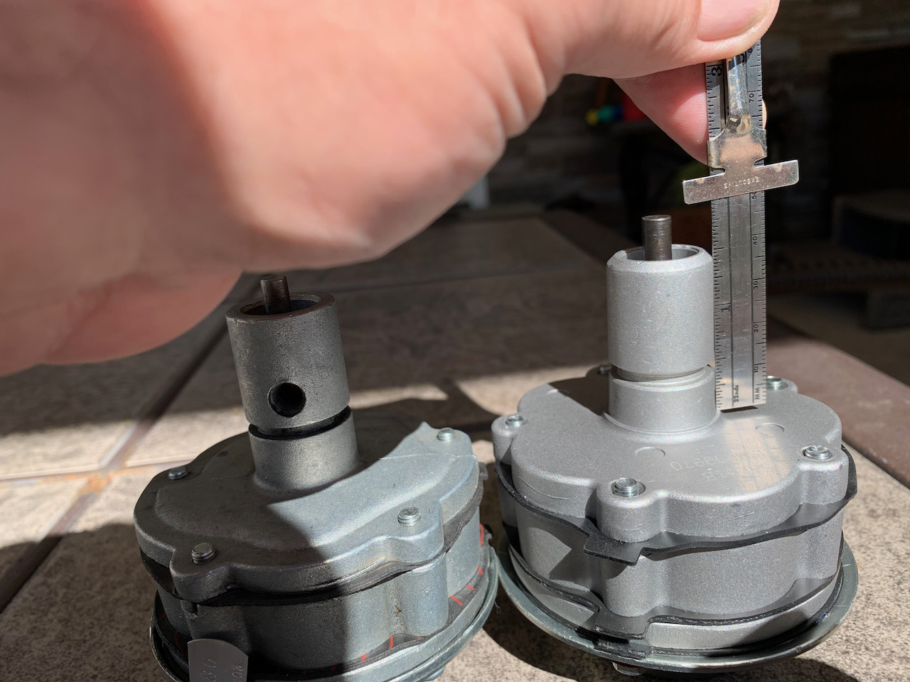

Thanks Ted,
I've been doing additional checks while waiting for answers and discovered the rod / diaphragm doesn't move as far on the new one either so I think I'm really stuck. I'm going to reach out to the seller and see if I get any satisfaction there.
Likely I'll be going the Electric Fuel Pump route now since it seems like Corvair Mechanical Fuel Pumps are not reliably available.
Oh well, missing out on a great weekend around here.

What was the source of the pump? Any chance of returning it??? I would not use that pump at all!
There are already existing quality control issues that you can see, and what about the ones you cannot see? I have read about a period of time when many manufacturers were producing Corvair reproduction mechanical fuel pumps that had a very high failure rate. Problems included internal springs that produced output pressure that was much too high and could flood the carburetors. I also read about pumps made with cheap, poor-quality substandard diaphragm materials that would tear or develop leaks. A failure of a substandard fuel pump could leave you stranded somewhere, or having to pay a high towing fee. An internal fuel leak can permit gasoline to leak through shaft that leads to the crankcase, and can fill your engine crankcase with gasoline in the oil that could result in serious engine damage!

As I'm doing more checking I'm concluding that I can't use this pump. My old pump travels at least 1/4" while the new one is about 1/8", something would have to give if I were to try this.
Should have bought a second spare when Clark's had them in stock.
