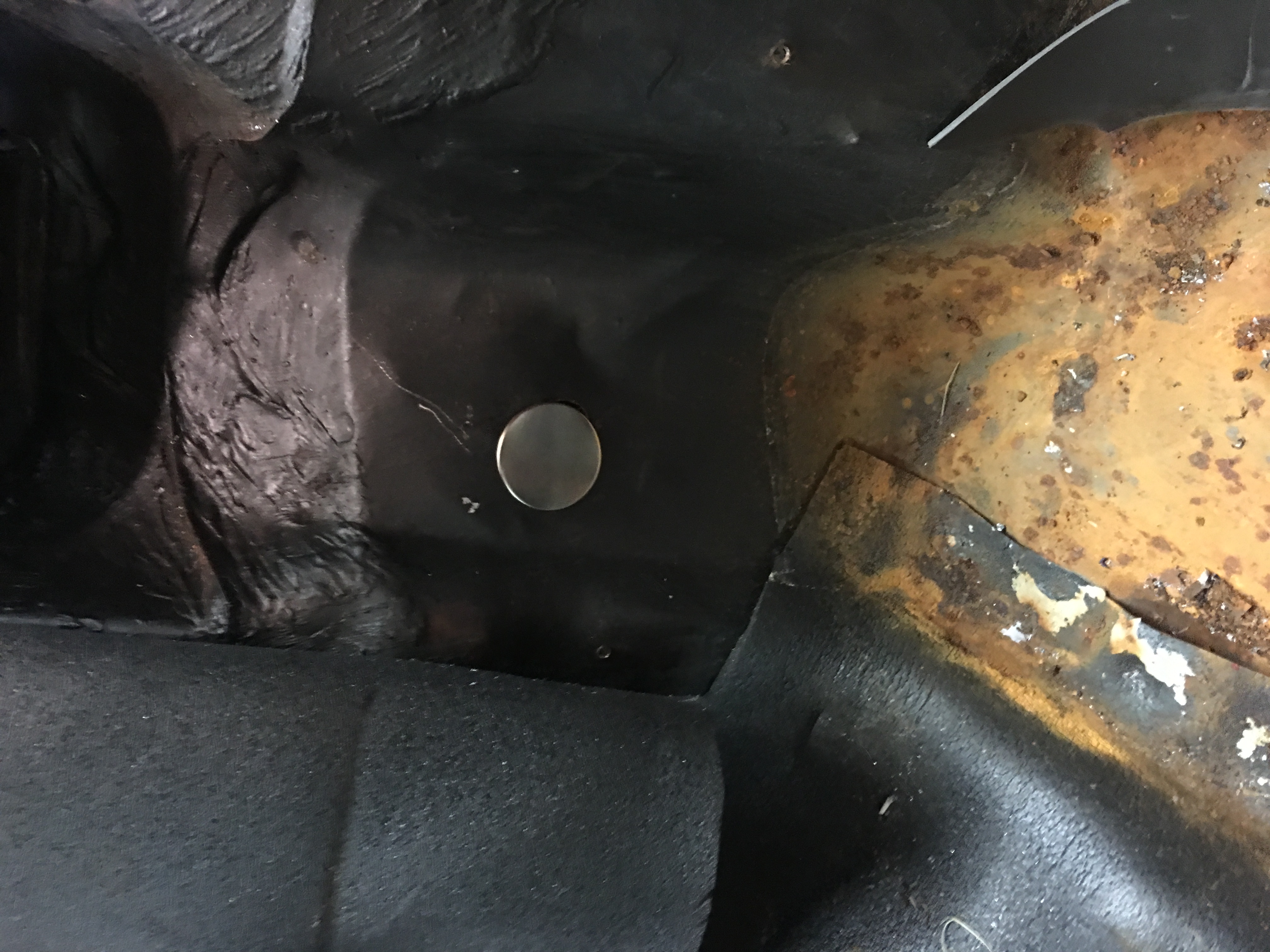

I lowered the front of the transaxle enough to allow removal of the transmission end mounts. We then cut a 2" hole from under the rear seat behind the Left heater distributor duct. This required removing the seat base and folding seat back for access and then removing the left side under seat heater duct. To locate the position of the bottom of this hole I used a die grinder with a pointy tip to grind a small hole in the vertical steel panel behind the seat. I did this from under the floor where I could see that I was making this hole even with the suspension crossmember just in front of the forward nut of the L trans mount. ( you could likely do this with a punch or a drill at an angle as well....all you need is a mark you can see from the inside of the panel so you know where to place the bottom center of the 2" hole you will cut.) I then went inside the car and marked a 2" circle with my mark as the bottom center of the 2" circle. I then drilled and ground out this 2" circle. Wow perfect access to the hidden nut:) After changing the mount I Installed a 2" plug in the hole sealed With a little seam sealer just to be sure it was leak free. I was unable to locate a 2" plastic Caplug (I think a 2" plastic plug similar to the type used at the Steering box adjustment access would be ideal), so I used a 2" diameter metal plug I found at the hardware store for now. Took a lot less effort than dropping the crossmember far enough to access the nut. If you rotate these photos 90 degrees right they will be oriented correctly...dang I-phone ( they display perfectly in the computer.

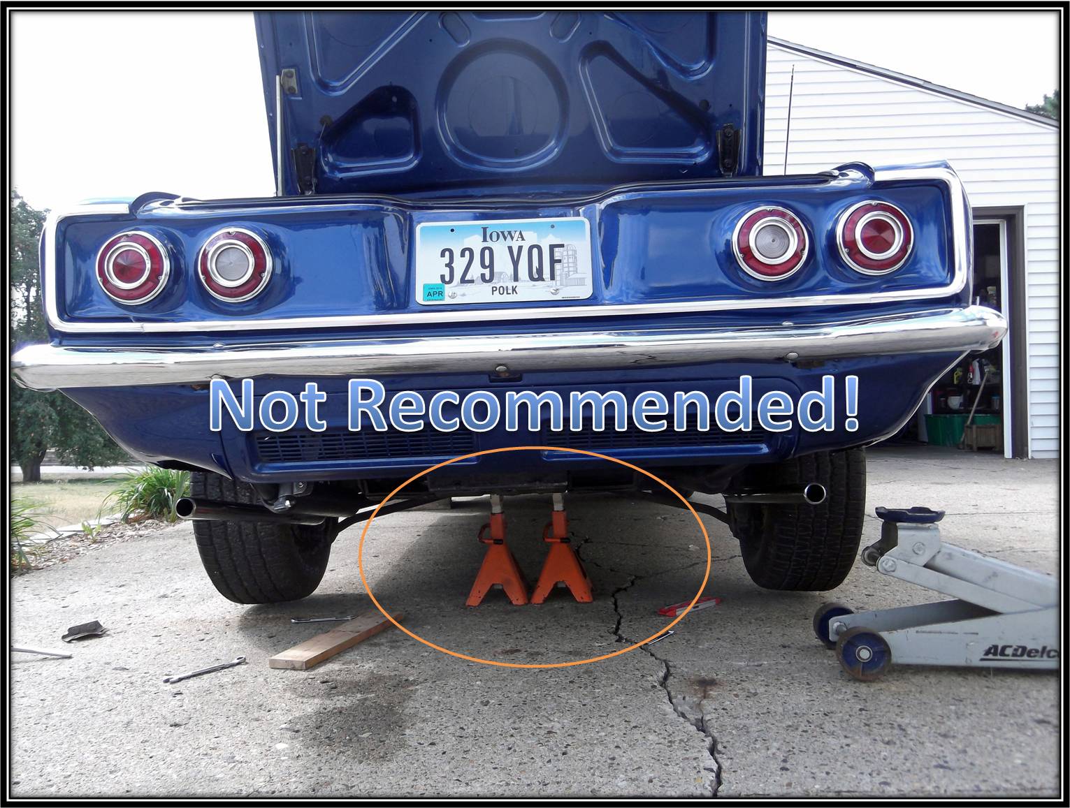

NEVER JACK UP THE REAR OF YOUR CORVAIR BY PLACING A JACK UNDER THE DIFFERENTIAL. DOING SO PLACES STRESS ON THE ENGINE AND TRANSMISSION MOUNTS THAT THEY WERE NEVER DESIGNED TO SUPPORT!
1965 Corvair - DO NOT LIFT HERE!

Thanks Brad, Yes I plan to replace both with new ones from Clarks, and I ordered them yesterday. I hadn’t seen that earlier post from terribleted. It looks like my plan to cut a hole for access to the top of the forward side transmission mount has precedence and is the way to go. Thanks again.
