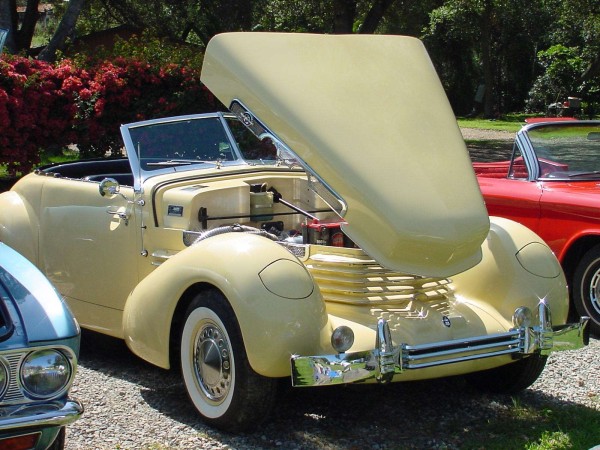

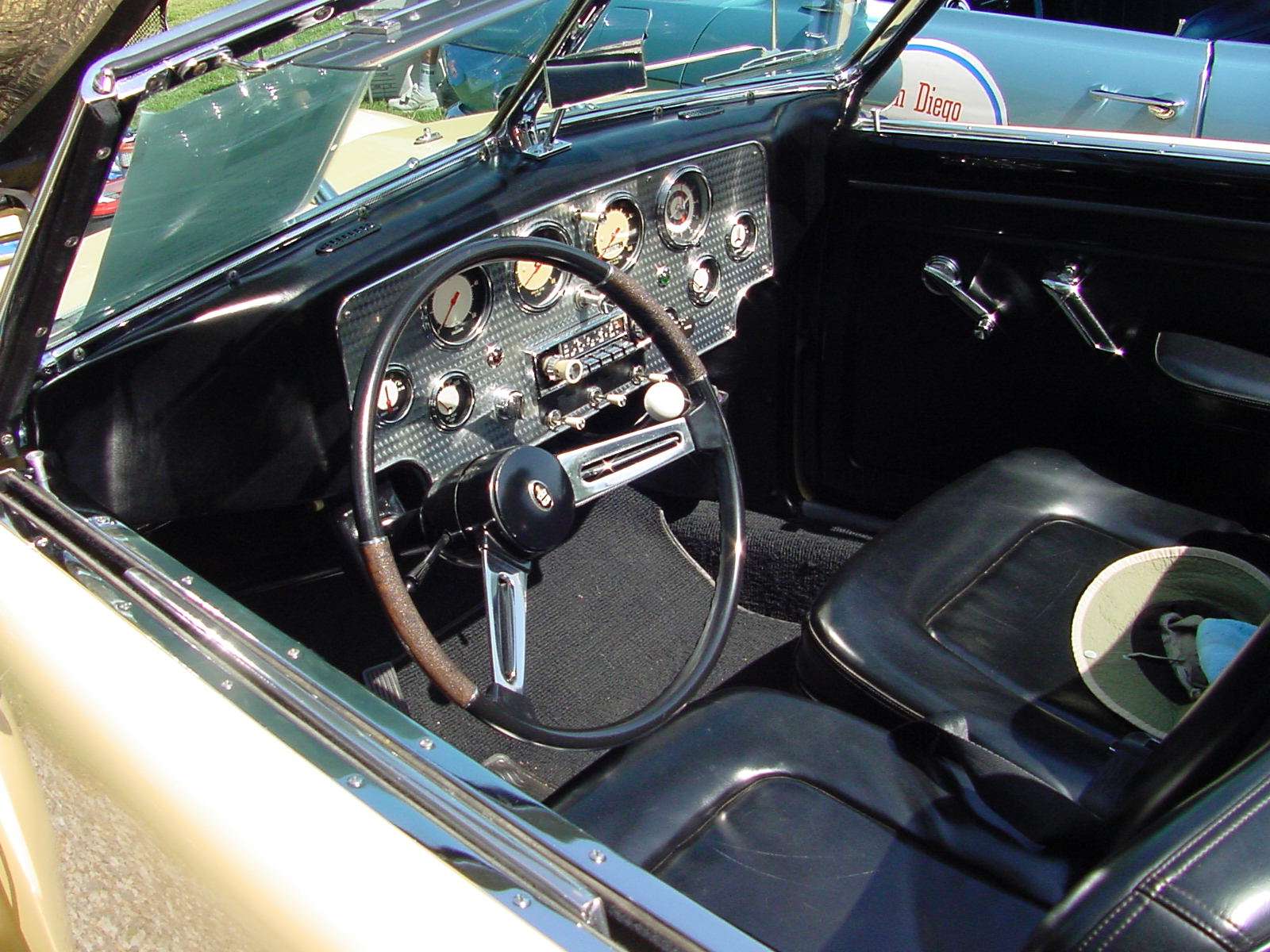

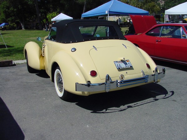

Here's a few photos of a Cord 810 taken at a Rainbow Oaks meet:

Really good engine picture...thank you Chet.
Anybody got pictures of an 8/10 up on a lift?
Like to know how the heck did they steer it?

Yet another turbo showing up with a Powerglide. Interesting.

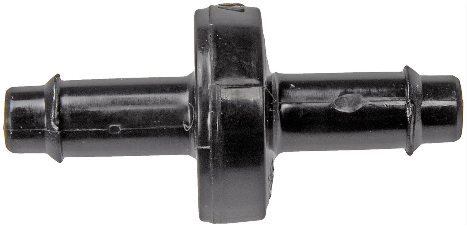

Powerglide with a turbo motor certainly can be done.
Put a one way check valve upstream of the modulator.
Use an HEI distributor (more fire) with a 5-pin module.
Trigger ground for the 5-pin with a 4 psi Hobbs switch.
The 5-pin retards timing up to 7 degree when ground.

No big issue with "turbo and powerglide", when you're custom building, the sky is the limit. On the check valve, couldn't you just hook the vacuum modulator hose UPSTREAM of the turbocharger?
Now my big question: The engine compartment picture shows the engine with the bellhousing / flywheel end of the engine facing forward. How are they connecting to the drivetrain? A special mounting plate to connect to a "regular" transmission?

The car is front wheel drive so the whole drivetrain is just moved forward.
