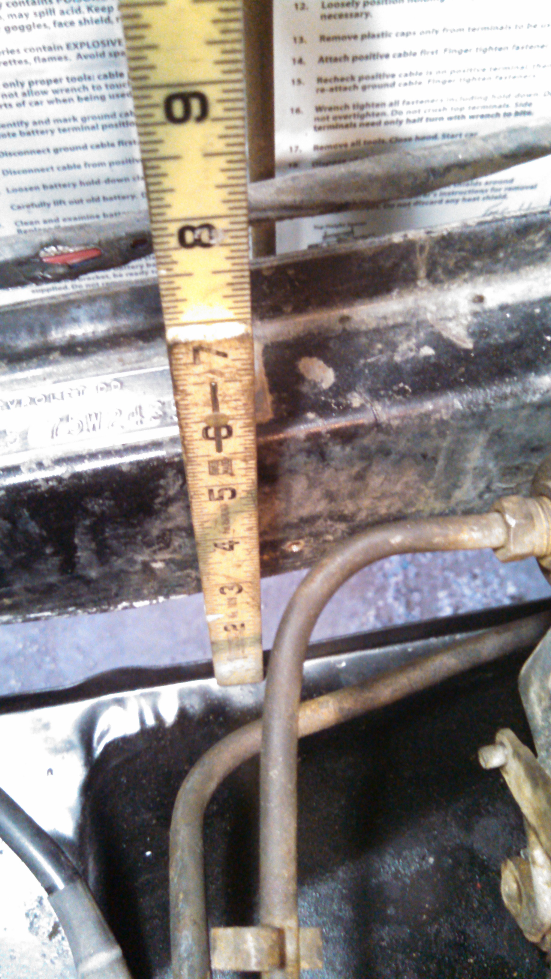

This is the only pic that shows up well. Last night I unbolted the trans, but it only has about an inch of clearance until it hits the cross member. I noticed that the top of the oil filter adapter is below the lip of the body- shouldn't it be above? If I unbolt the rear mount. I can jack the engine up where it belongs, but the bolt holes are way off.

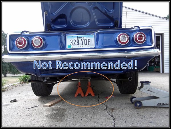

ALSO NOTICE THE JACKING NOTE AT THE BOTTOM OF THE PAGE! Never jack up the rear of a Corvair with a jack placed under the transaxle. This forces the engine mounts to lift the weight of the car, which they were never designed to do. Lifting the car with a jack in this way can cause internal damage to the engine mount!
:link: http://www.corvair.com/user-cgi/catalog ... N&page=160
1965 Corvair - DO NOT LIFT HERE!

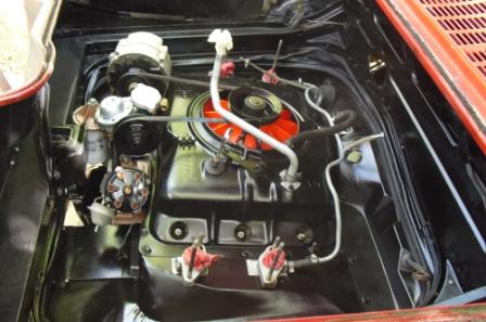

I noticed in your picture that you do not have the perimeter seal (gasket between body and engine) in place. I have noticed that the engine will appear low with out it. But you have to keep in mind that the seal takes up the clearance.
There is not much that would cause it to sit low by changing a trans. Check your mounts like Brad stated.

Boy, is my face red! I didn't realize just how wide that rubber strip is. I guess I never saw an engine without the seal installed, and it looked like a really big gap. After reading the replies, I went and installed the seal, and now everything looks like it should. Thanks for all the responses, you guys are the best!
