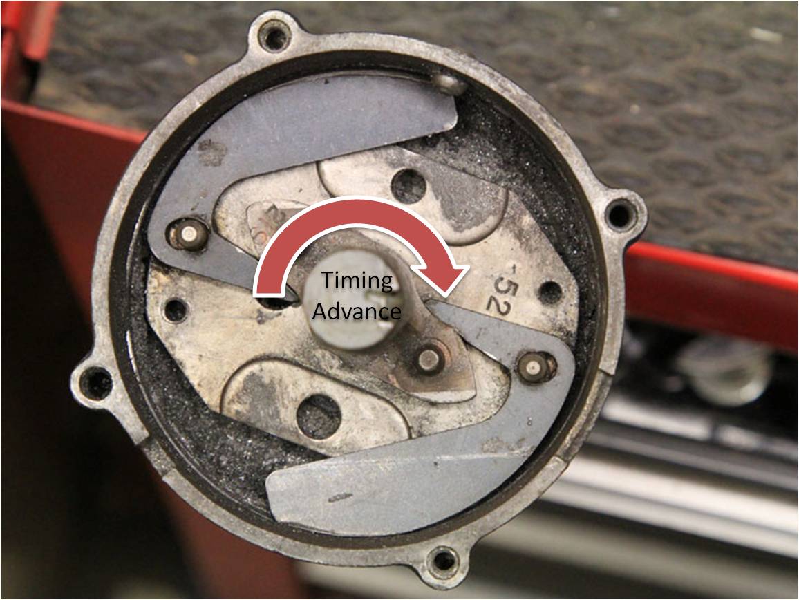

I put a timing light on it, and the timing was fine... until the engine RPM climbed. I discovered that the timing shown by the timing light was going the wrong way! Reving the engine caused the timing to retard! The vacuum advance knew which way to go, but the centrifugal advance was headed the wrong way!
If somebody took your distributor apart to clean and inspect it, it might have been reassembled incorrectly. You might have to pull the breaker plate and take a look. When the weights spin they might be sitting on the wrong side of the distributor cam, and when they move outward against the springs they may just be rotating the cam the wrong way.
In the picture below, you can see that as the weights swing outward toward the distributor housing, the portion of each weight that contacts the distributor cam in the center would apply leverage that would rotate the cam clockwise, which would have the effect of advancing the timing. HOWEVER, if the weights were removed, flipped over, and reinstalled so that they were pressing on the other side of the cam base, the weights would rotate the cam base counter-clockwise — RETARDING THE TIMING. This may be the problem you are encountering on your Corvair distributor.

That is exactly what it seems like. I've pulled the distributor and will dig into it...little else makes sense. And to Jeff's comment on weak/broken valve springs, that wouldn't effect timing in any way, though it could create some miserable running conditions.
