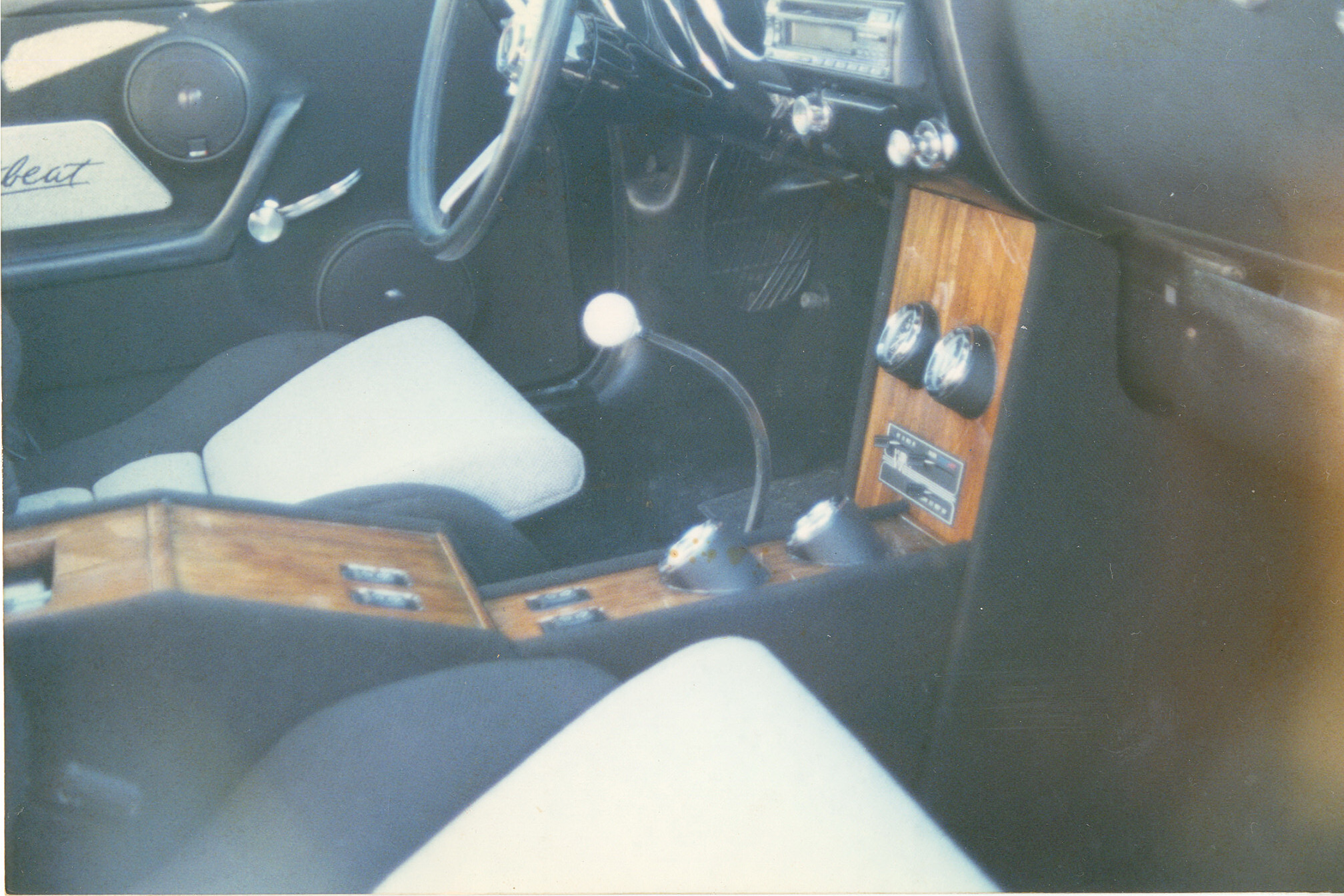

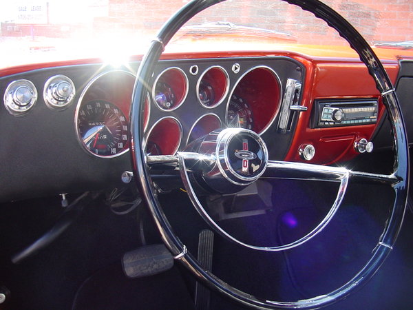

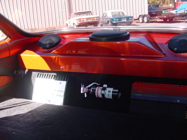

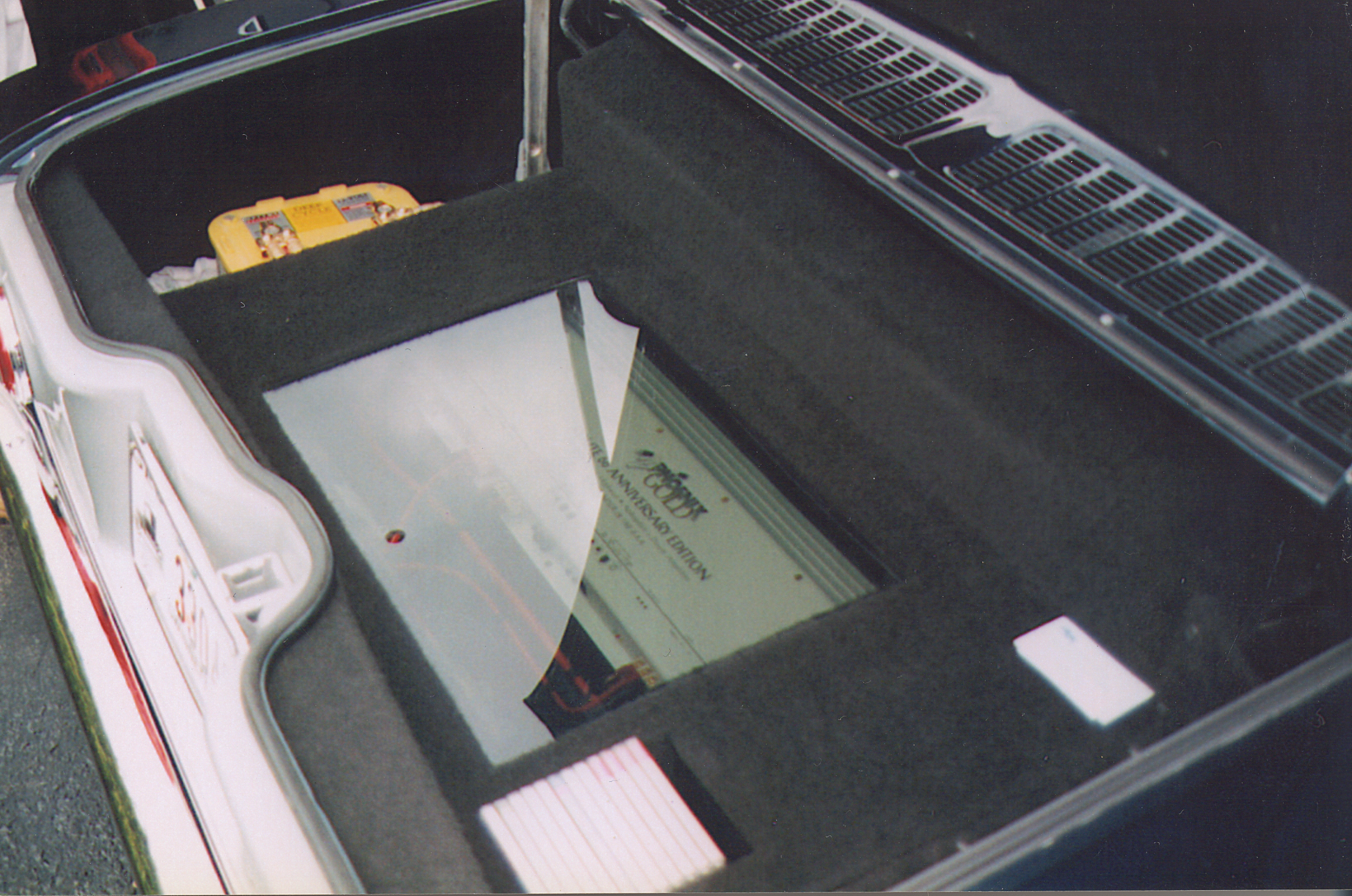

Universal underdash mount brackets are available to accommodate todays 2x7 DIN format radio chassis. You simply mount the bracket under the dash or in the case of a early model under the current radio bracket. I have used a number of different CD players over the years I tend to like Kenwoods a lot. I also have made dash mods to a couple cars to build in a metal 2x7 opening in the current late model radio spot. A few photos of some tunes in vairs. Both of these systems were bi-amplified using 1 or 2 10" subwoofers, Tri or Bi-separate R=L front speakers, and co-axial R+L rear speakers mounted in the sides of the Subwoofer enclosures.

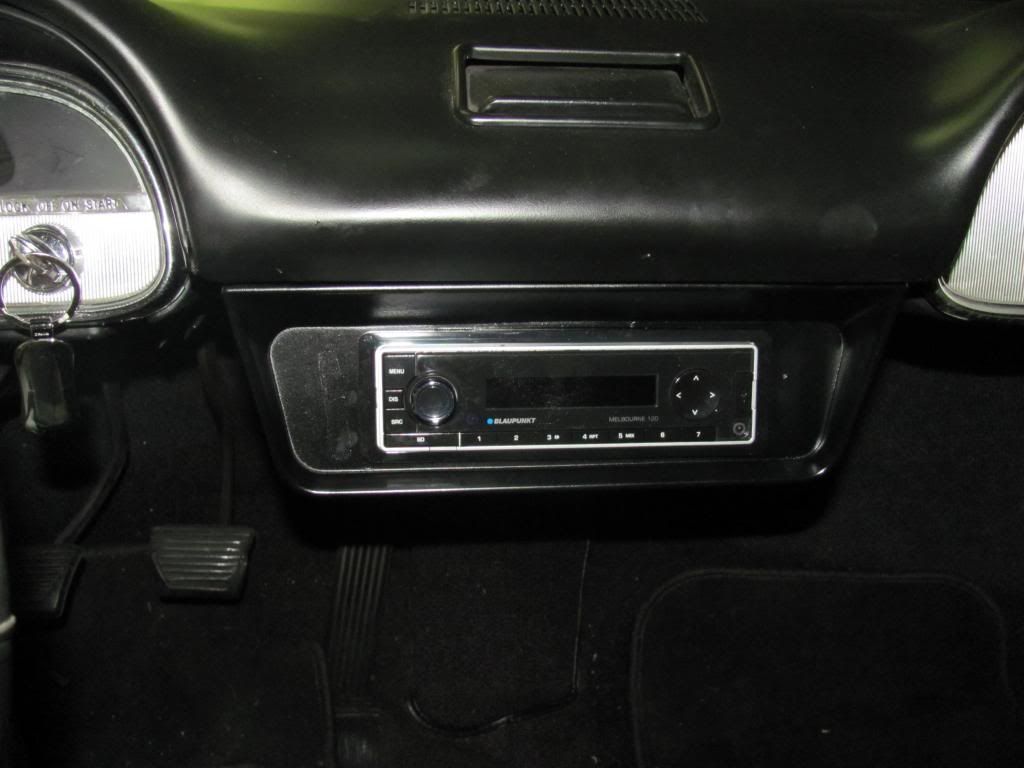

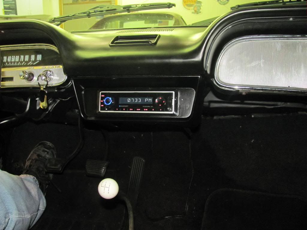

Thought this modern radio was dressed down enough it kind of fit the theme in the car. I have custom auto sounds "system 1" on the way, so we will see how that sounds.
