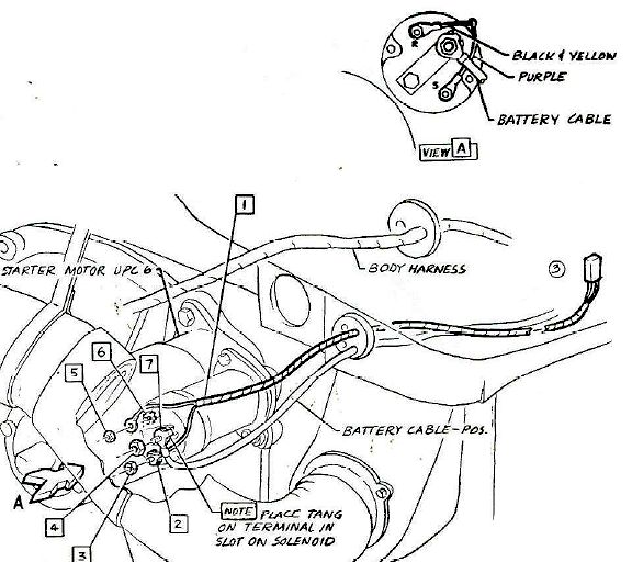

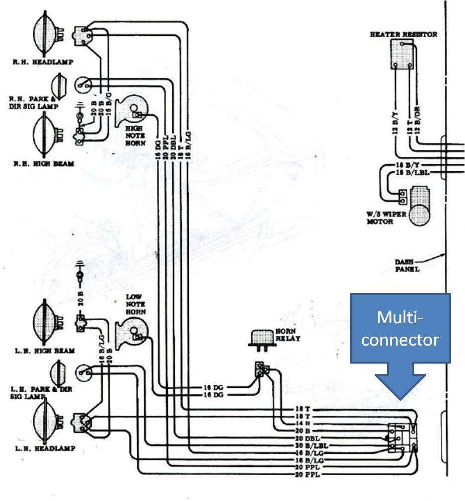

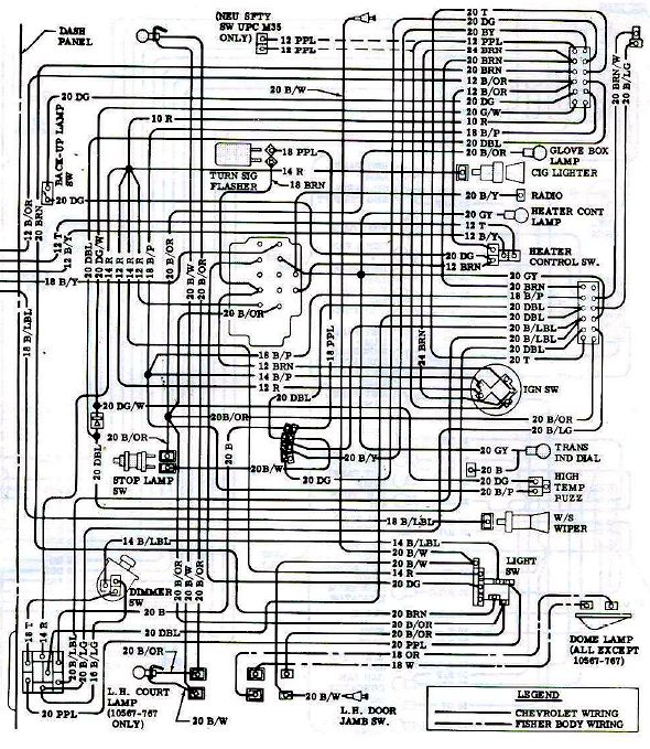

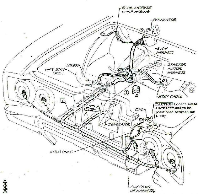

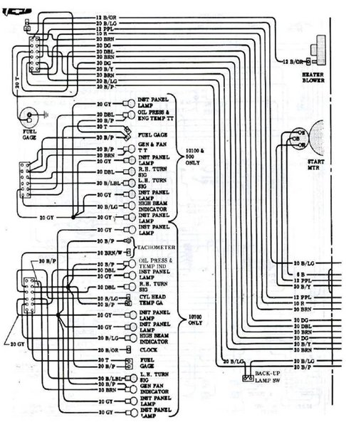

Here are the schematic and wiring illustrations I have for the 1965 Corvair, to use as a baseline...
Note that the engine compartment JUNCTION POINT (10 Gauge Red) is a voltage tie point between the alternator power output, battery power positive terminal, and the primary power feed line that runs to the passenger compartment, fuse block, etc. All power for every accessory, lighting, horn, heater fan, wipers, ignition system, etc. passes through this junction. The only exception is the direct 6 Gauge cable that runs from the battery positive terminal to the starter solenoid. This connection provides a high-current path that powers the solenoid and the starter motor, and through the solenoid provides a full 12V DC temporary feed to the ignition coil positive terminal to boost ignition spark voltage during periods when the solenoid is engaged and engine is being cranked by the starter. This "hotter" spark voltage enhances engine starting. The voltage shuts off when the key is released and the starter is disengaged — leaving a lower 6-7V DC via the ignition coil resistor circuit that is present as long as the key is in the ON position.
Note also that for every POSITIVE power connection, a comparable corresponding NEGATIVE GROUND connection must exist. The wire gauge for these GROUND connections must be equal to or exceed the wire gauge of the positive feed, to provide a comparable GROUND RETURN PATH. For this reason the thick 6 Gauge black negative battery terminal cable is bolted directly to the engine, so that the starter motor has a ground return path that is equal to the gauge of the positive battery cable. The 10 Gauge NEGATIVE GROUND wire is fastened to the chassis (frame) ground, and is equal to the 10 gauge positive wire that powers all of the car lights and accessories. (The schematic diagram shows a slightly thinner 12 Gauge Red and a 12 Gauge Black wire tie to the POSITIVE JUNCTION and CHASSIS GROUND. This is acceptible because of the short length of these cables. The wire current carying capacity is a function of both the wire gauge (thickness) and its length. Since these wires are short, the engineers deemed the thinner 12 Gauge to be acceptable between the battery and the connection points. The longer run between the alternator and the harness behind the instrument panel receives a thicker 10 Gauge wire.

1965-1969 Corvair Engine Compartment Wiring Harness Multi-pin Connector
1965-1969 Corvair Engine Compartment Wiring Harness Multi-pin Connector.jpg (33.79 KiB) Viewed 2528 times
1965-1969 Corvair Engine Compartment Wiring Harness Starter Connections
1965-1969 Corvair Engine Compartment Wiring Harness Starter Connections.jpg (80.88 KiB) Viewed 2528 times
1965-1969 Corvair - Instrument Cluster and Body Harness
1965-1969 Corvair Trunk Schematic Diagram

Thanks very much for the info. I found that the red ignition wire had power in the back but up front under the dash it had nothing. I believe I have just about everything hooked up correctly at this point but I still have some troubles. I jumped the red wire and have power to the switch now. When I turn the key I get power right at the starter via the purple wire, but the car does not crank at all and I still have no head lights...sounds like a ground issue to me. I ended up grounding the neg cable to the exhaust manifold as its the only steel I can find on the motor. Should I add another ground? Also, does the resistance wire hook up to anything in the back? Thanks guys for any info. I'm
Close, I can smell it.
Posts: 12142
Re: 1967 Corvair wiring problem
The normal ground point at the engine is to the left of the alternator. There is usually a support brace bolted to the alternator, and the other end of the brace bolts to the left cylinder head. This is usually the ground point for the thick (6 gauge) battery cable. You can see this cable in the above picture.
Since the engine is suspended by three rubber engine mounts, the mounts do not provide a ground path. The LM engines usually have several small braided ground straps to ground the corners of the sheet metal to the chassis (seen in the above picture on the right). But the high-current starter motor needs a good ground return. That is why the main negative ground cable is bolted to the left cylinder head near the alternator.
That engine ground is not sufficient for the chassis ground, that provides a ground return path for all of the accessories, horn, lights, etc. That is why a second ground wire (10-12 gauge) is connected between the negative battery terminal and the car chassis, usually at a bolt near the battery in the perimeter chassis engine compartment frame.

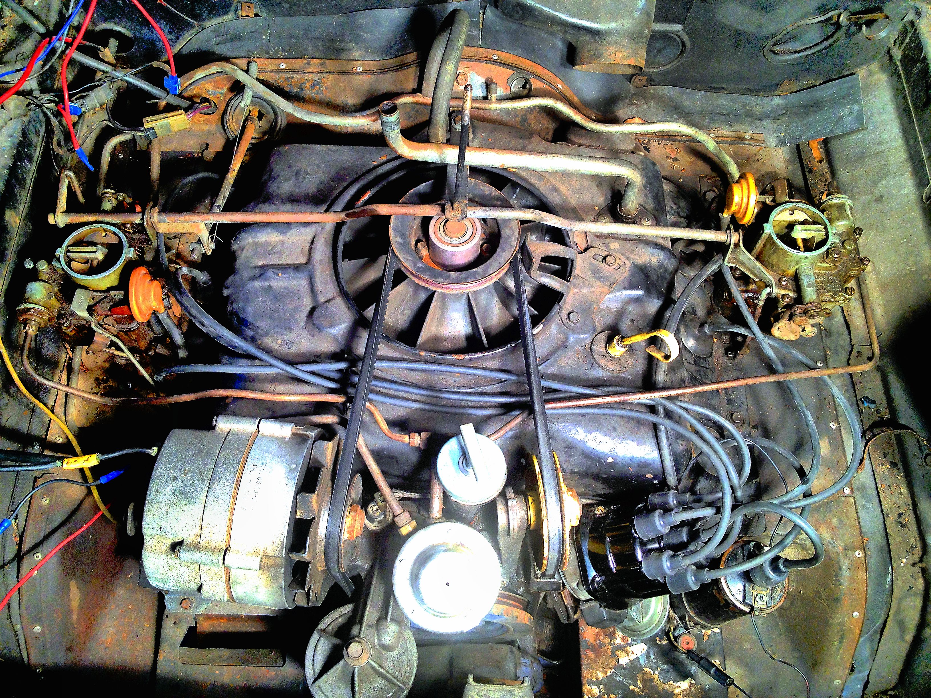

Thank you VERY much for the help. Part of my problem was the battery (which is not that old), had a short in it. So it had juice when I checked wires but when I would turn anything on, it would drain immediately. I got the motor fired up for a split second last night (with starting fluid), but still have to hook up carb linkage and fuel line. Any PDF or pics of how these vacuum lines are supposed to go? I'm going to use individual aftermarket air cleaners because my stock cleaner is junk. Thanks again for all the help.

Oh and it's a 2 carb motor
Posts: 12142
I cobbled this generic diagram up to illustrate vacuum connections in a variety of Corvair configurations.
This diagram illustrates potential problem areas for a normally aspirated Corvair where vacuum leaks can occur.
The PCV tube seen on 1963-1969 Corvairs uses either a fixed orifice or a PCV valve to connect to the vacuum balance tube. The other portion of this tube connects to the air cleaner. The crankcase is sealed, and vents through these two connections. Both the vacuum path and the air cleaner path function at different times, depending on the speed and operating condition of the engine. The upper PCV connection can be fitted with its own small air filter to keep dirt out of the crankcase. But the idea is to recycle crankcase blowby fumes back through the carburetor, either through the vacuum intake connected at the carburetor base, or through the upper intake where crankcase fumes are drawn through the air cleaner assembly. If possible, the upper connection should be connected using tubing to one of the air filters attached to one of the carburetors.
