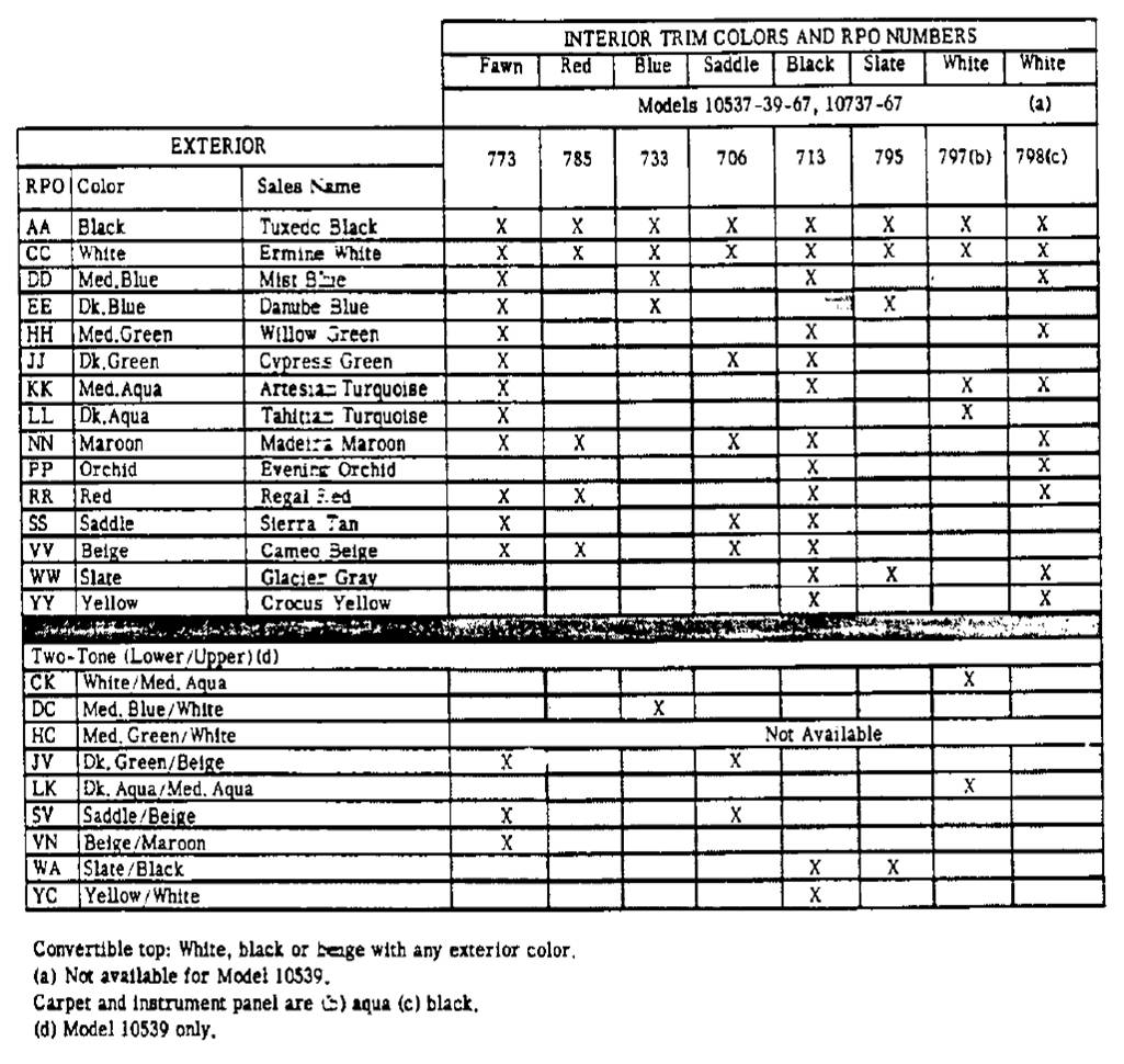

I have a body tag which I have been able to decode using the various decode lists on this forum.There is a lot of very good info in the list. However, I am stumped by a single trim code for a '65 Los Angeles built Monza. The paint code is DD for blue mist poly and the charts says that Los Angeles builds do not list interior colors on the tags but the tag shows a TRIM code of 633, which chartwise speaks to seat configuration on'66's but I can't it find anywhere for '65 year which is the most prolific year?

:chevy: I have checked several different sources, and all indicate that valid Corvair Body Tag Trim code numbers are all 700-series numbers. None reflect a code 633 for any model year.
Could you possibly post a close-up photo of your car body tag. It might help use to figure out the problem with that trim code number.

ooops! 733

Interior color code 733 is simply "BLUE", as shown on the 1965 Monza and Corsa color data sheet from the 1965 Corvair GM Heritage Center specifications. I have attached a copy of this document, which also includes many Corvair specifications, R.P.O. information, etc.
1965 Monza and Corsa Color Combinations - GM Heritage Center Data
