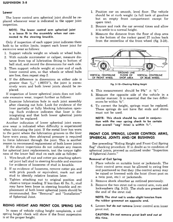

Re: first showing
Here are the body design specifications from the GM Heritage Center records. I have attached the full specifications for the 1962 Corvair for your information. Page 3-8 of the 1961 Shop Manual addresses riding height and coil spring sag checks.
Left-click image with mouse to enlarge image size.
1962 Corvair Exterior Body Dimension Specifications
Corvair - Early Model Riding Height and Coil Spring Sag (Shop Manual)
1962 Chevrolet Corvair GM Heritage Center Specs.pdf
(3.07 MiB) Downloaded 78 times
1961 Chevrolet Corvair Shop Manual - Section 3 - Suspension.pdf
(1.67 MiB) Downloaded 55 times
