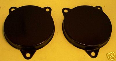

Re: Air flow on engine
It might be a good idea to cap those heater duct outlets . The factory capped them in heater delete cars .
It should be easy to rig something up.
delete covers.jpg (12.22 KiB) Viewed 688 times

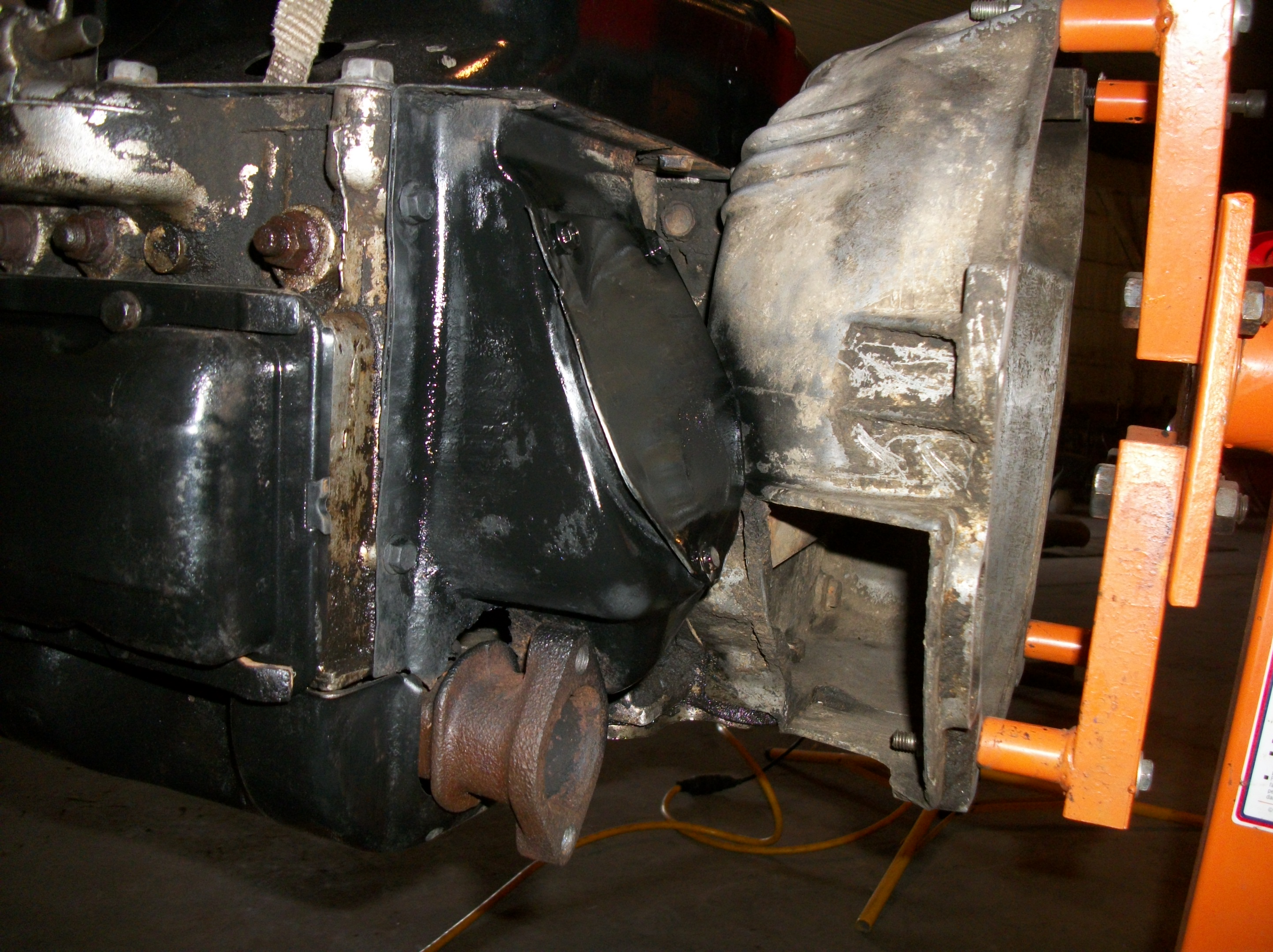

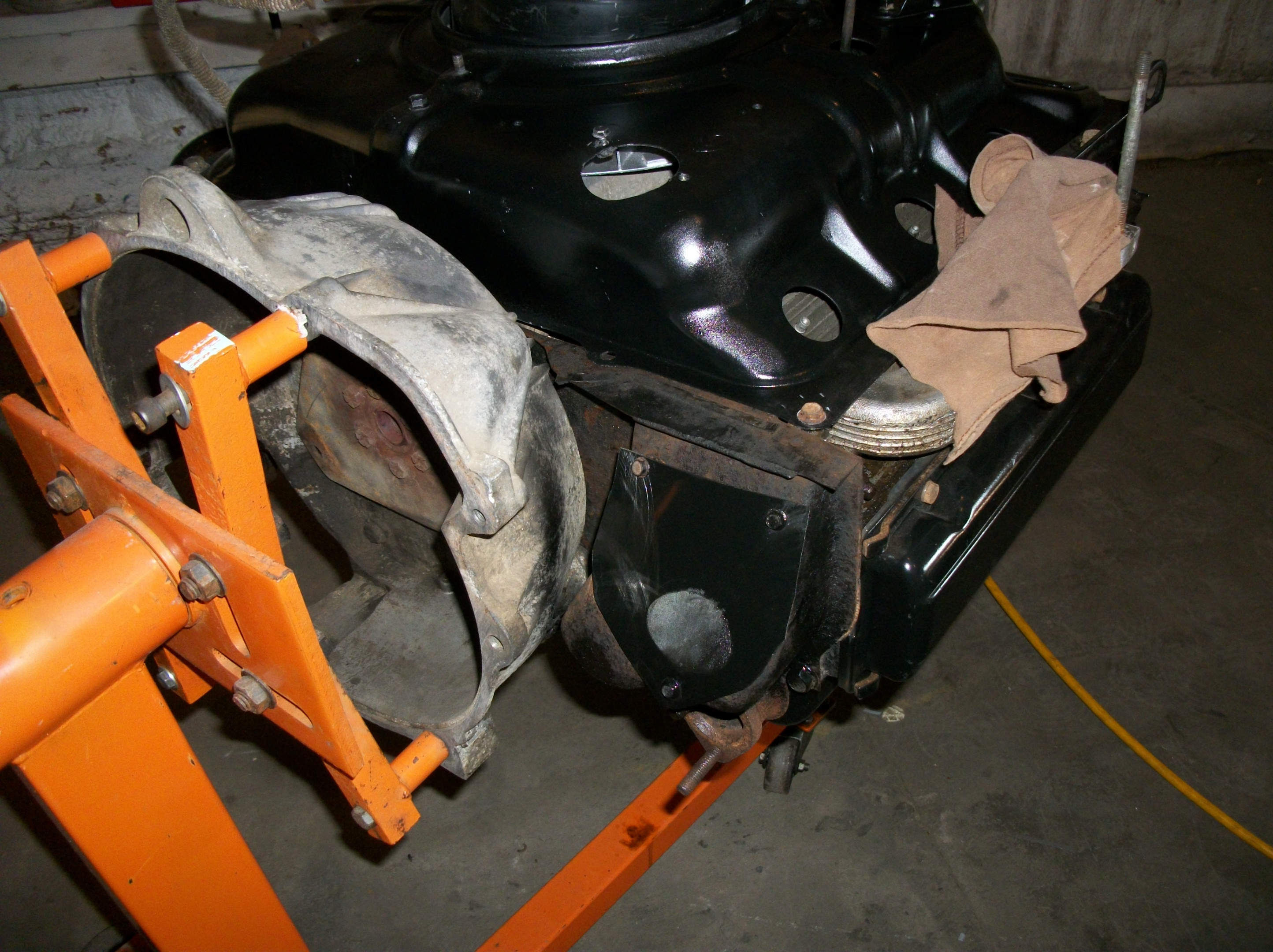

Post by jennirw »
1960 700 COUPE
Post by BIGTWIN »
Is that a small hole cut in the flashing on that bottom picture? If so then please 'splain it. Do those rear cylinders get hot if the air flows the other way? :think:
1961 Monza
jennirw
Posts: 453
Location: FLINT, MICHIGAN
Post by jennirw »
MY BROTHER JUST USED SCRAP SHEET METAL - ONE PIECE ALREADY HAD HOLE - NOT THERE ON PURPOSE
1960 700 COUPE
60vair
Posts: 110
Joined: Sun Mar 20, 2011 7:00 am
Location: Clio Michigan
Post by 60vair »
that is not a hole in last pic. metal had putty on it and left mark. used sheet metal from old hood.
