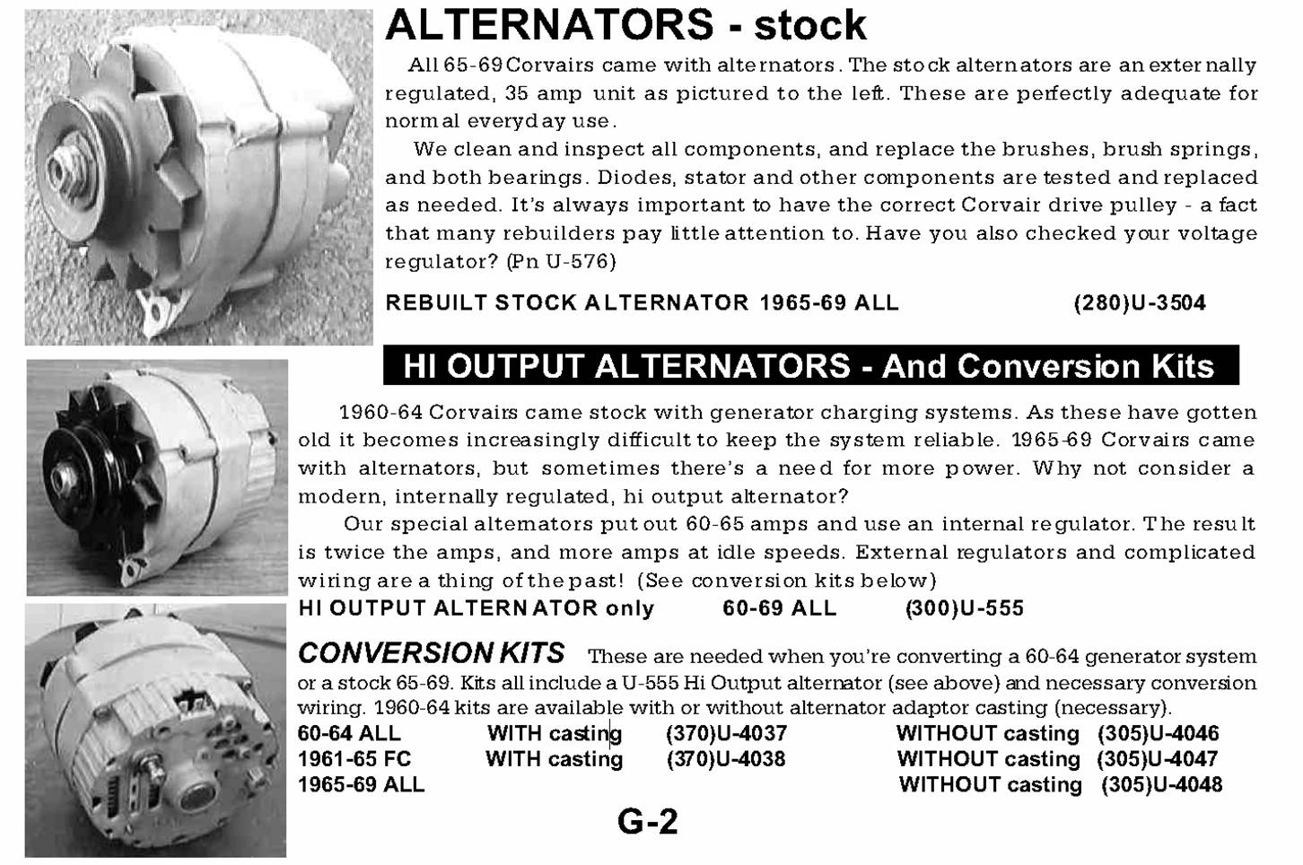

Corvair Underground Catalog Page (Using high output alternator with internal voltage regulator)
(Approximate Cost: $215) CORVAIR FORUM - Generator to Alternator Conversion Discussion
