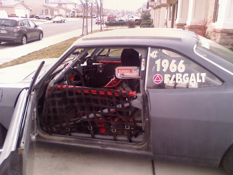

When you install you must sandwich the body at all mounting points to be effective.
Also as many gussets as possible...see my pictures...they will save your life.
Otherwise it's only for show!!

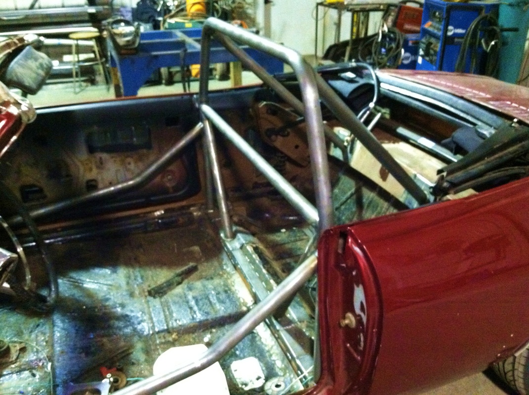

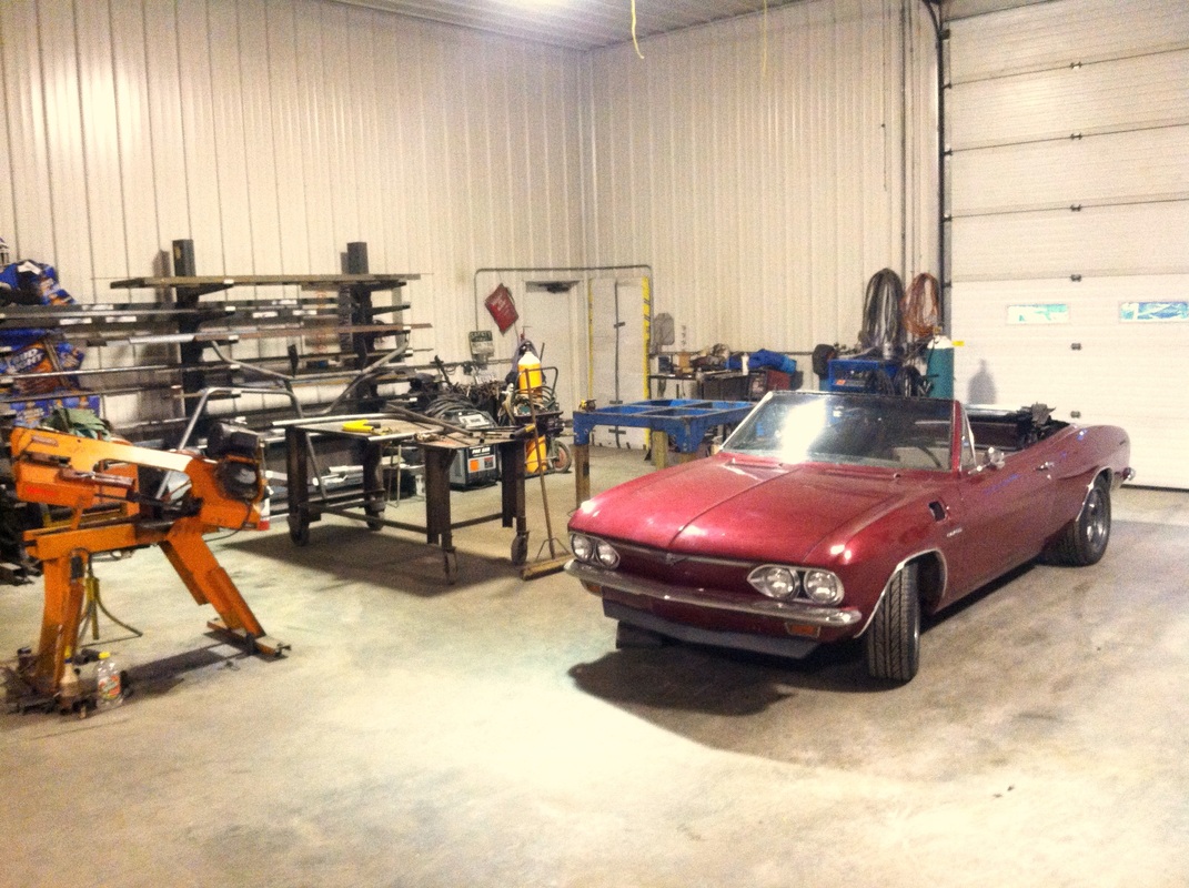

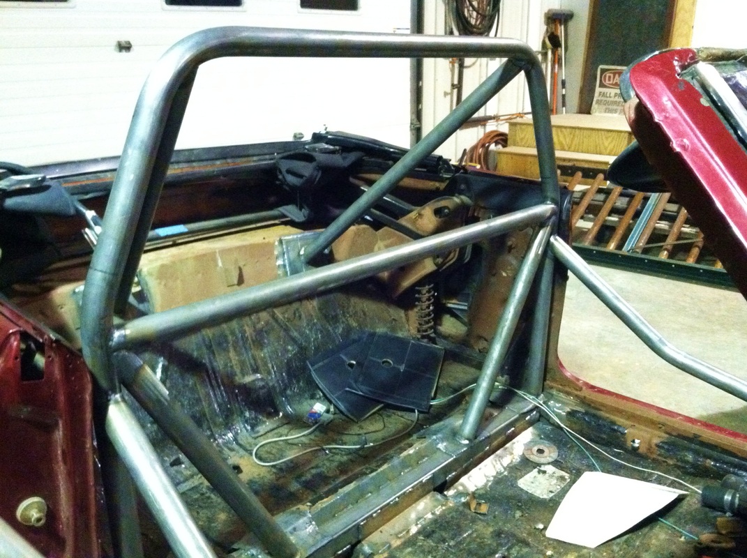

Not sure where you are located, but Spadano Enterprises in Chelmsford MA builds custom roll cages. He did a full custom main hoop for my 66 vert. its made from NHRA DOM spec tubing fully plated sections have been added under mounts for extra support, as well as a large square tube under the main hoop for side impact protection. he really went above and beyond on this one!

Thanks Mike, That is exactly what I am looking for. I like the low bars going to the front. Imp in SC.
