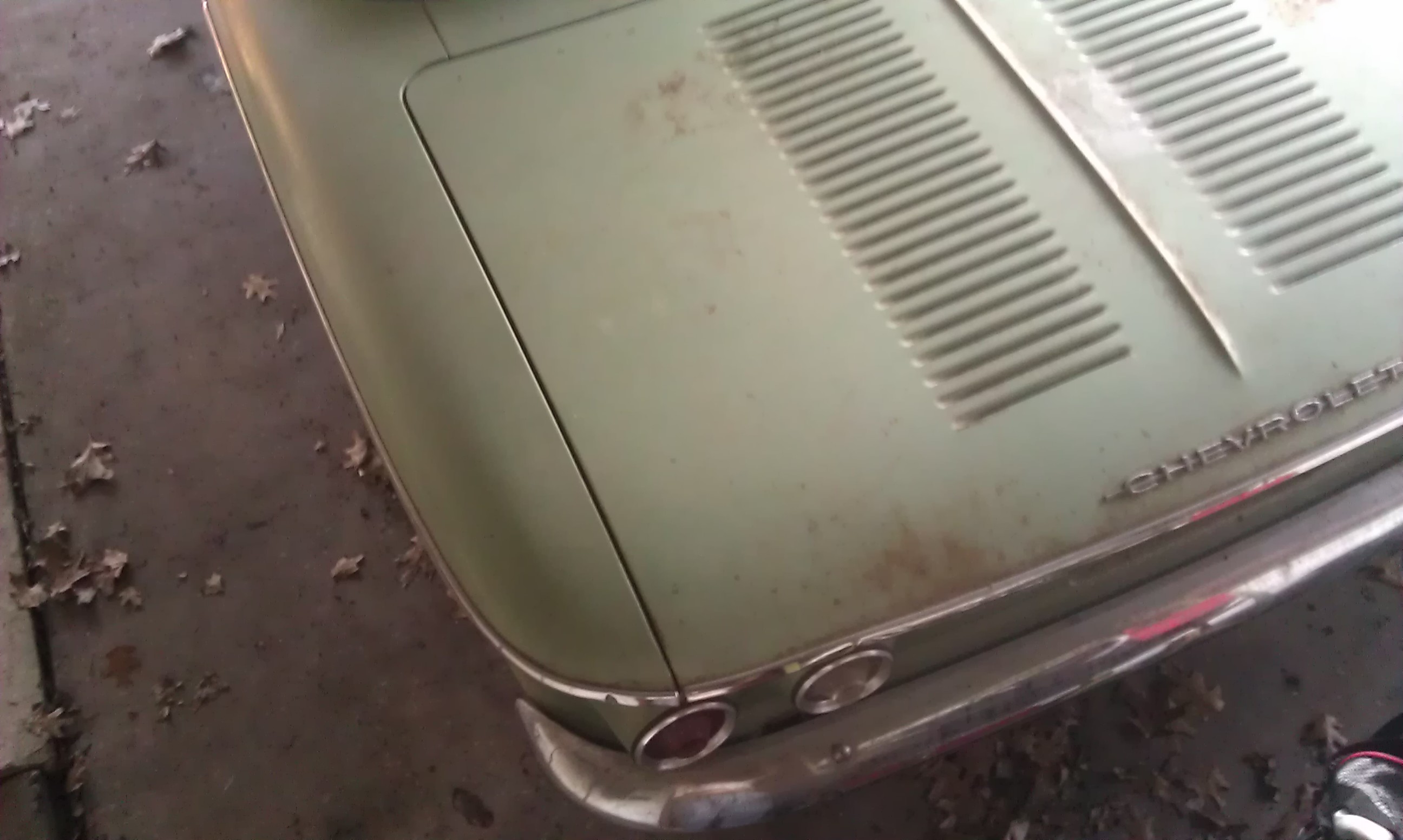

Hi my name is Dan. I'm from San Antonio TX. My wife's father bought this '60 4 Door Deluxe about 14 years ago. It hasn't ran since. I promised her I'd get it started. But don't know where to start. I joined this forum hoping to learn more about Corvairs and how to get mine running again. So hello, and any advice is welcome.
