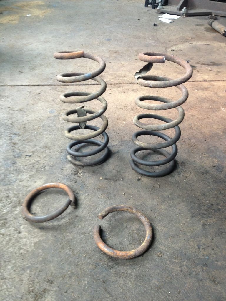

Front springs 1 coil. Should be done in the next hour or so
freedo
Posts: 457
Joined: Sat Apr 07, 2012 1:30 pm
Location: suburbs of philadelphia
Re: Lowering An Early Model?
Post by freedo »
1 coil is a tad over 1" drop going to cut another coil and then half or a one coil in the back

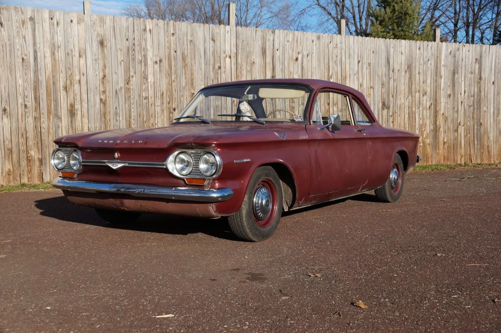

sam60
Posts: 371
Joined: Mon Dec 26, 2011 8:26 am
Post by sam60 »
I bought it like this but it appears lowered. I think it is just the tire/wheel combo.
I'll spray those weeds tomorrow. ::-):

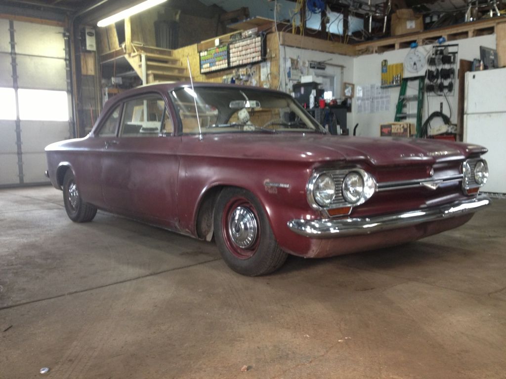

freedo
Posts: 457
Post by freedo »
Two coils cut up front, rear is stock

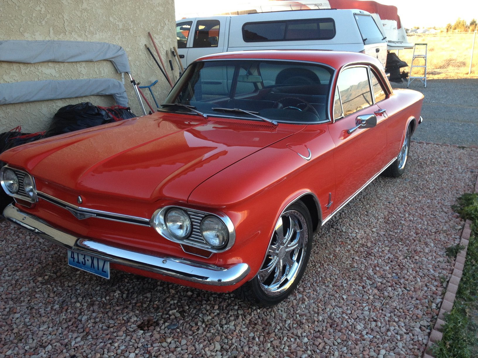

Nice! I also cut 2 coils from the front of my '65. I thought you had to cut the coils as either 1 or 2 removed, not 1.5 etc. Now I read that it's okay to cut them in 1/2 sizes. Who knew? I sort of wish I did 1.5 instead of 2. My front seems to have gotten even lower than when I first cut them.
