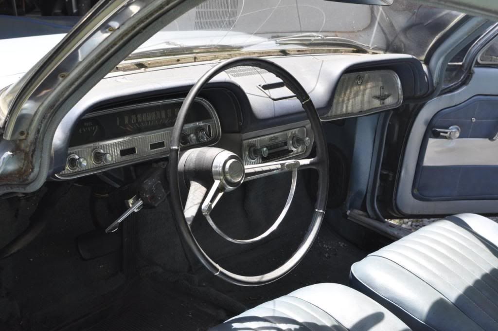

Just to provide an option if you care to, but somebody put an old school signal stat on mine. Looks like they were having cable problems and just unscrewed the stalk, cut the wires going to the plug at the column and wired this up. I plan to undo all this and fix the factory stuff one of these days. This works fine but doesn't cancel and I find myself driving with the signals on....
