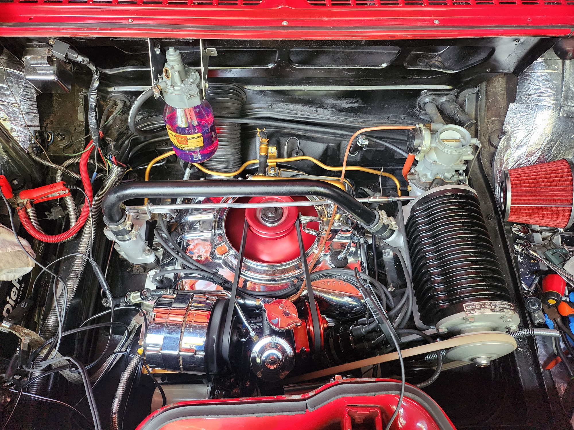

I installed a Judsun Supercharger on my 110 1966 powerglide (it has 95 HP Heads). It stalls every time I try to put it into drive (or reverse)
I get it started just fine and runs in Neutral about 1000 RPM minimum. It stalls out any lower. I bumped it up to 1500 RPM to compensate for the drive drop in RPM, and it still stalls when selecting a gear. I bumped it up again to 1800 and the same thing happens.
Timing is set at between 20 and 22 (factory spec is 24 for my car) and I'm concerned about going any higher with the supercharger on.
I'm honestly not sure what I should be adjusting. For now I'm assuming there are no vacuum leaks as all seals and hoses are new, nuts and bolts tight.

What is the carb and does it have ported vacuum advance? Is the 20-22* with the vacuum advance disconnected? Cool setup! One strategy for a low steady idle is low timing, a little extra throttle opening, and a rich mixture… Good luck! Ken

Carb is a Holley 2110. I've never dealt with one of these before.
Yes, 20-22 with disconnected vacuum and clamped hose.
Thanks for the advice :). I will try that tomorrow and report the results.

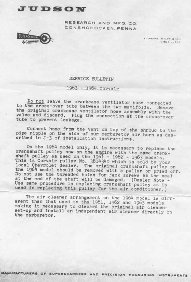

I am not sure why but Judson did not want the PCV hooked up the way you have it. Here is the 63-64 service bulletin about correct routing. I have the original instructions as well if it would help.

SpyderMan wrote: Wed Oct 02, 2024 4:33 pm I am not sure why but Judson did not want the PCV hooked up the way you have it. Here is the 63-64 service bulletin about correct routing. I have the original instructions as well if it would help.
As others said -- YOU NEVER WANT the PCV system hooked up to a pressurized source. The stock Corvair system uses manifold vacuum AND the air cleaner. Often a mystery to folks on how it works. The Judson folks just hooked the crankase vent up to the aircleaner. That is fine, but you tend to get more oil mist up to the aircleaner compared to the Corvair system and at idle there may not be enough air flow into the air cleaner to prevent fumes from leaving the air cleaner. The Corvair system worked well to ensure crankcase fumes did NOT get into the engine compartment. Those fumes contain carbon monoxide and you DO NOT want that getting sucked into the engine fan and blown into the engine compartment via using the heater!!!

Yes now that I look at of course that is the reason.
Back to the idle in drive issue, a Judson will run fine without the belt. Have you pulled the belt off to see if there is any change?
This did the trick :tu:
I removed the valve connection and the idle dropped a bit and I can now select gears.
Now the new problem is being massively rich and a little rocky at neutral, but being great in drive. Fixing Neutral brings up the RPM too fast with what I tried so far (like around 2000 RPM!). The Idle mixture screws don't seem to help neutral at all. I turned both all the way in wile playing with it, and it still poured out black smoke.
It seems to me the automatic choke isn't working properly either. The first time I thought nothing of it, but for the third day in a row I couldn't start the car cold because it was open. I had to close it manually to start. It feels really stiff. It seems to open up ok while warming.
