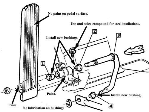

Here is an illustration of the LM pedal assembly and things to do (and not do), when reworking it. EM pedal is similiar.

Make sure if you take the pedal off of the assy that you put it back on at the same angle. I believe that the assy manual shows the correct angle that it needs to be. If you can't get the throttle to do what it needs to (pedal on the floor and can't get full throttle) the pedal could be on at the wrong angle. The pedal splines to the shaft with no keyway to put it back to the correct spline.
