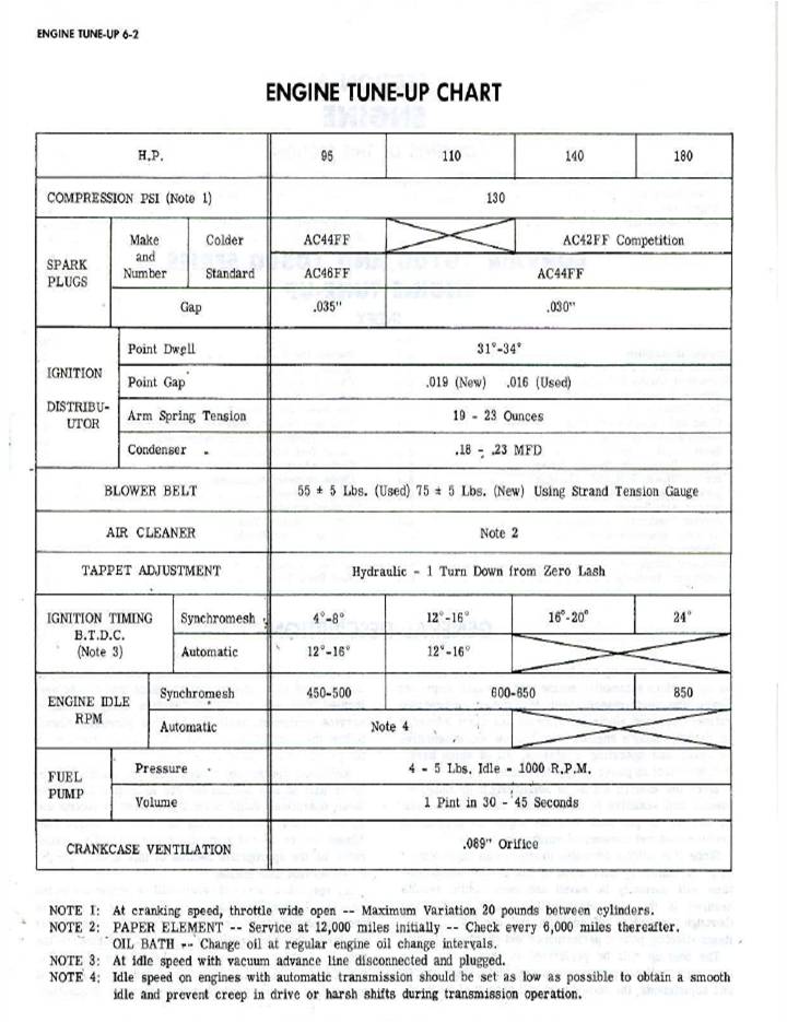

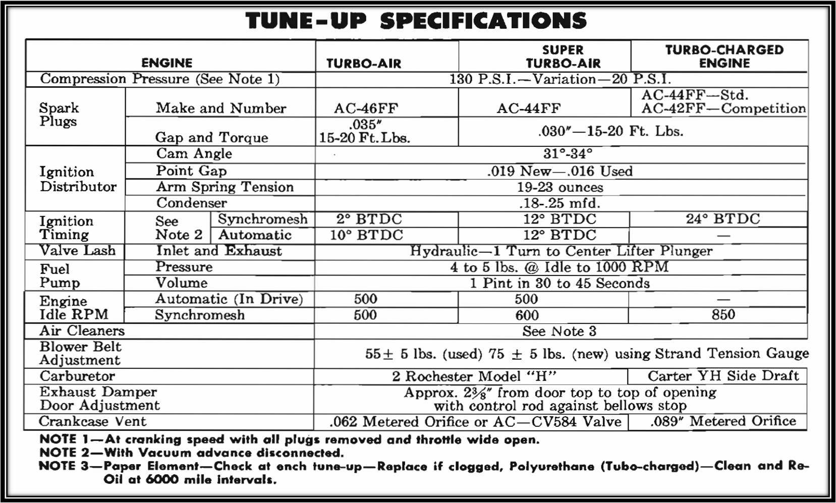

A spark plug gap of 0.030" meets the needs of just about all Corvair engines. A wider gap is more difficult to fire reliably with a standard ignition coil voltage output. Higher cylinder compression ratios or a turbocharged engine generally has higher combustion chamber pressures — making the high voltage needed to create the ignition spark reliably greater. The Corvair engines rated at higher horsepower levels generally had a higher 9.0:1 compression ratio, This can make the combustion chamber pressures higher. The turbocharged engine has a lower compression ratio of 8.0:1, but the turbocharger boost and increased horsepower output increase combustion chamber pressures, which again makes a reliable spark more difficult to achieve. For these reasons the Corvair shop manuals specify a reduced gap of 0.030" in all but the lowest horsepower engine.

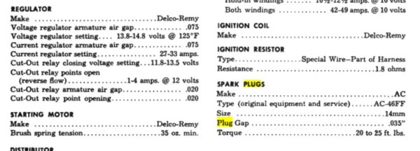

I would consult the 61 manual, since it is the basic manual for your car. The 62 manual is a supplement for changes, they made to the 62 model year.
Ir seems the 61 model is correct. Editors changed it for some reason in 62-63 supplement, but got it right again in 64 supplement.

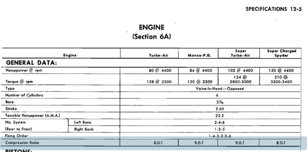

LEFT-CLICK EACH CHART IMAGE TO ENLARGE FOR EASIER READING...
As I stated earlier, the engine cylinder compression ratio has an impact on the combustion chamber pressures encountered by the spark plug electrodes. In 1961 ALL of the Corvair engines had the same 8.0:1 compression ratio. In 1962 and later Corvairs, the optional engines had increased horsepower — primarily due to increases in the compression ratios or the addition of a turbocharger, as well as some changes in the camshaft specifications. When the combustion chamber pressures increased due to the increase in the compression ratio from 8.0:1 to 9.0:1 (or the addition of a turbocharger on the 150hp engine option) the spark plug gap on those high performance engines decreased from 0.035" to 0.030". The ignition coil output voltage to the spark plugs remained the same, so the design engineers reduced the spark plug gap specification to facilitate a reliable spark plug firing under the increased cylinder pressures encountered with a 9.0:1 compression ratio (or with the turbocharger).
This revision of the spark plug gap specifications remained for all model years through 1969.

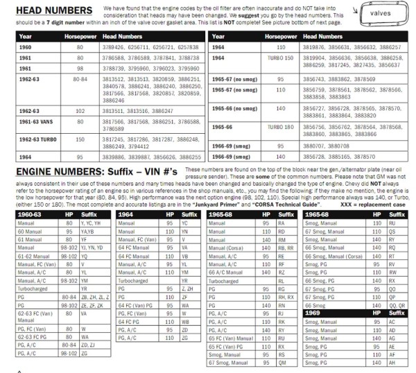

So the next question in order to make the complete circle of information, what engine HP is in the car? The original 84 hp or did someone swap in a 80 hp engine in the past 62 years?
I haven't found anywhere in his posts, what engine hp or the engine number being reported. Critical piece of info for any engine diagnosis.
Can you let us know the Engine Number and its HP as you know it.
Here is some info to help you ID your engine.
