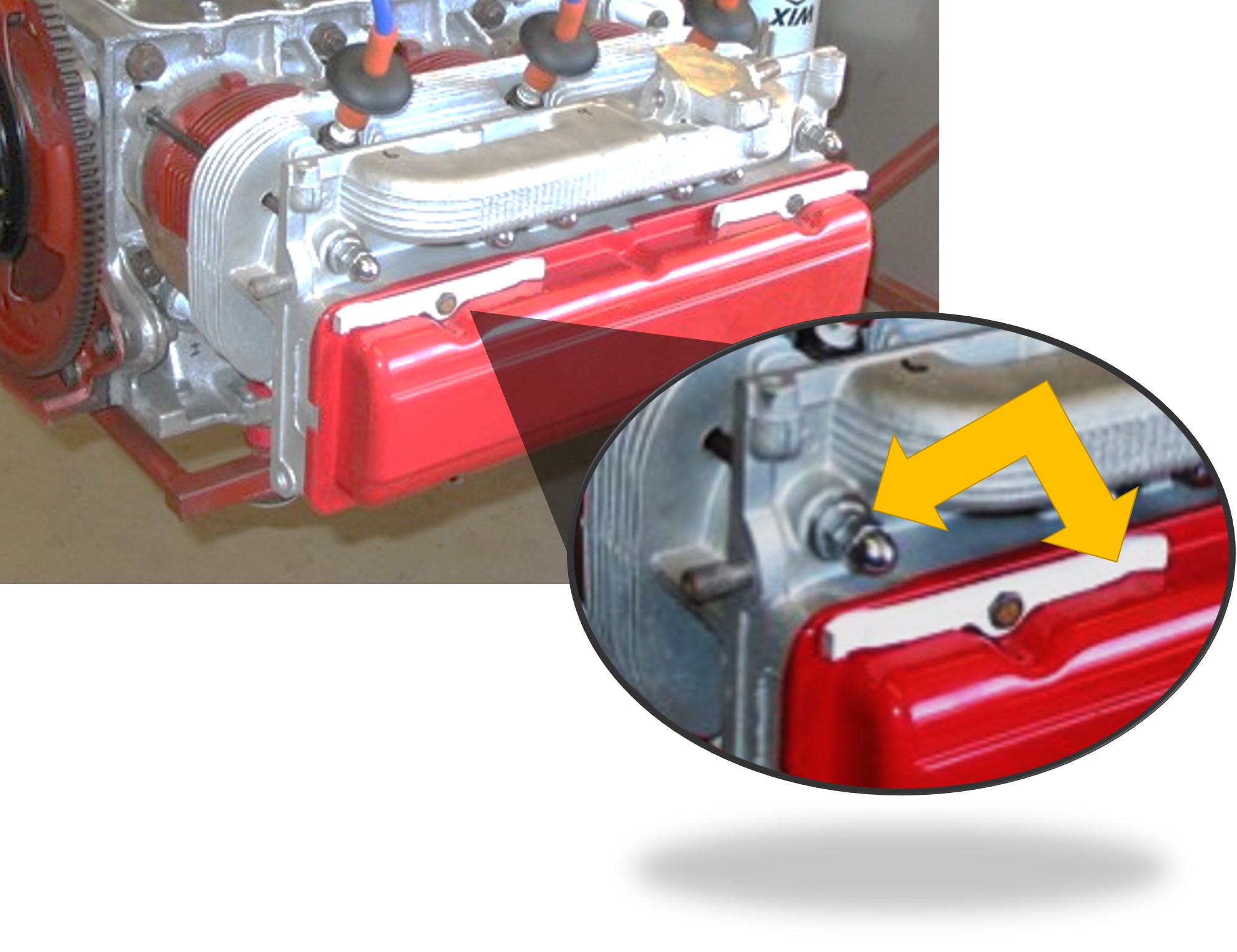

The four bolt method, combined with the compression "springs" to distribute the tension across the valve covers, seems more than enough. Valve covers are not hard to seal, and they are only sealing against splashing oil collecting and draining through the pushrod tubes. The oil pan is more-difficult, because it is holding back several quarts of oil that reside continuously ABOVE the gasket — even when the engine is not running! Most engines have an oil pan that is shaped like a trough, that holds the bulk of the oil below the gasket mating surfaces. The Corvair engine is unique, because the oil sits above the gasket, and the oil pan is flat. Splashing oil is easier to seal against leakage than holding back a pool of oil that is continuously trying to escape!
Some people mistakenly install the retainer tension springs upside down. They should be installed as shown, so that the bolt in the center applies spring tension t the outer ends — effectively applying spring tension to the outer ends.
