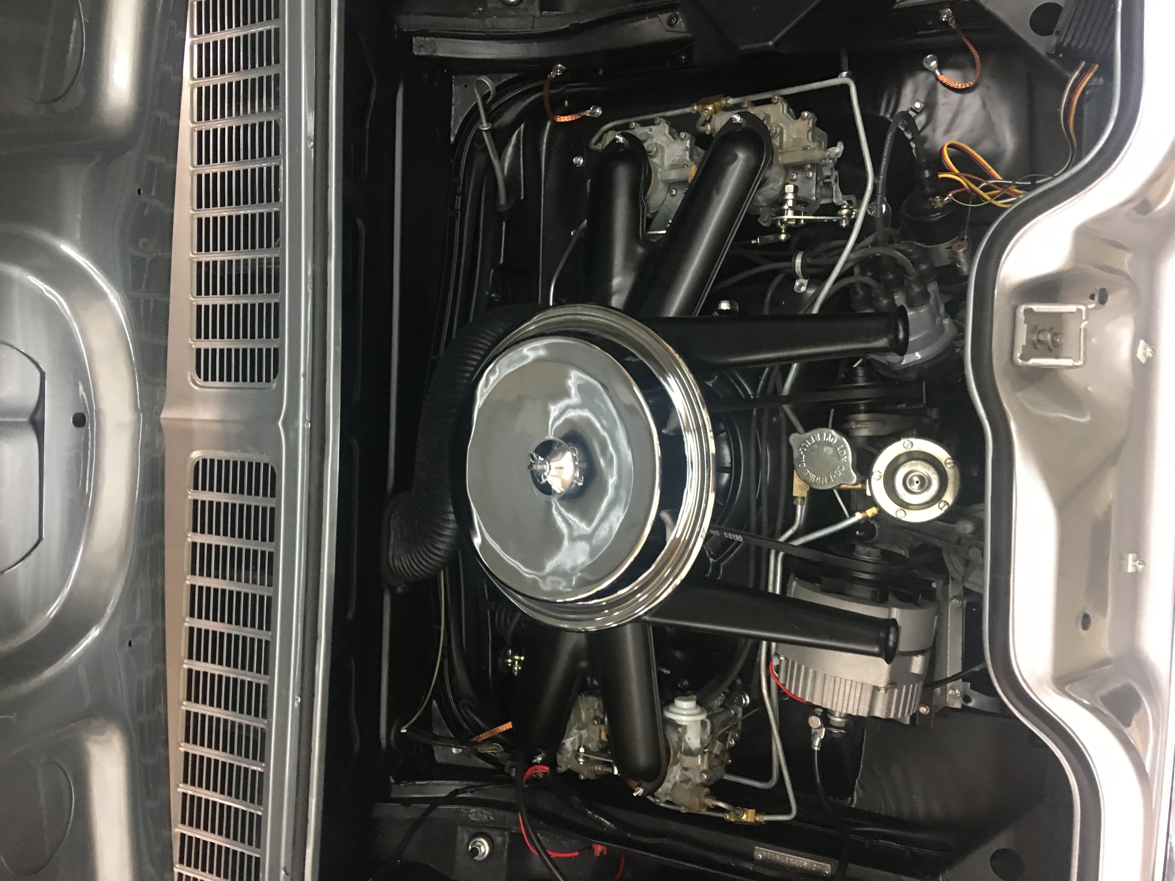

I have used this paint on the engine bay but NOT on shrouds. It is ok I guess. It seems to be a little glossy and mars easily. I have found that VHT Roll Bar and Chassis black epoxy in satin is close to the same gloss level (a hair less shiny) and is harder and muchmore durable. It functions ok on shrouds as well. I highly recommend what most powdercoaters call matte black in powdercoat for the shrouds. Powdercoating if in the budget is the best (not terribly expensive here, my guy blasts and coats a full set of engine sheet metal (like 30+ pieces) for well under $300. No high temp paint is needed on the bay or the shrouds.
This photo is powdercoated shrouds with VHT on the engine bay.
