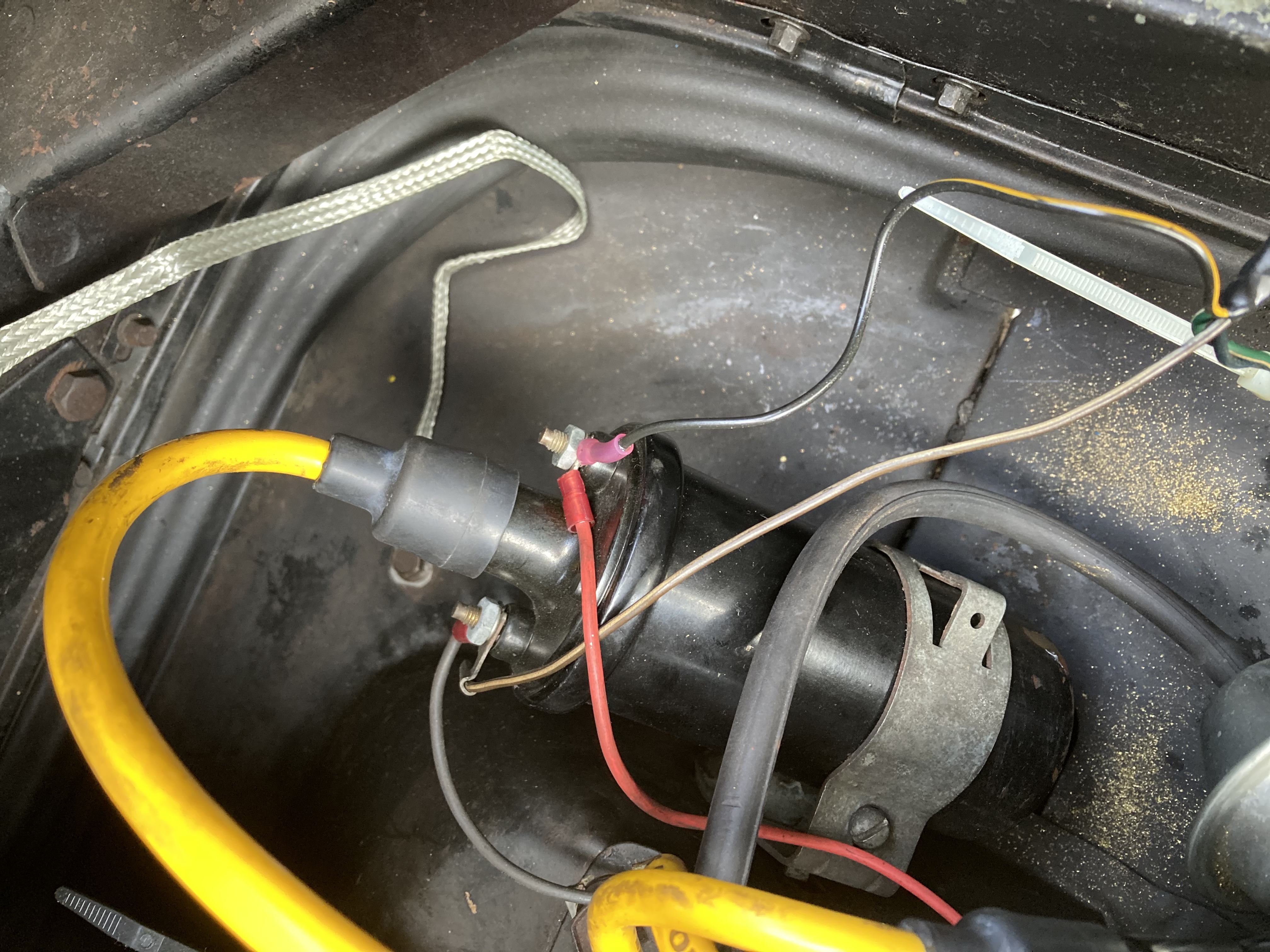

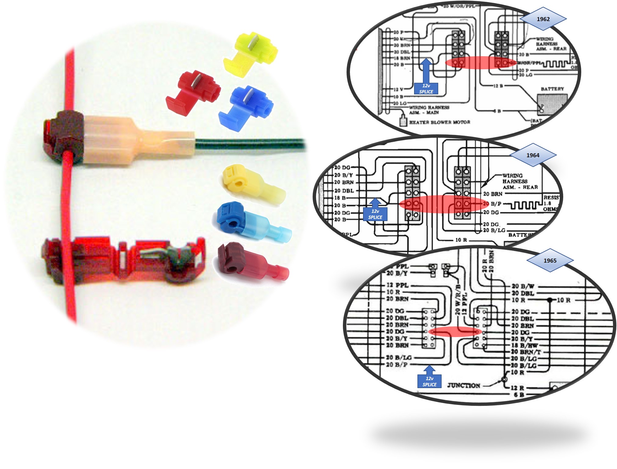

Probably the easiest way is to identify the wire that brings the ignition voltage from the ignition switch to the coil with the key in the ON position. This wire enters the large multi-connector in the engine compartment. A that point it has full 12 VDC available when the key is in the ON position. on the other side of the connector, the same circuit exits the multi-connector and enters the resistor wire. The output of the resistor wire connects to the two-connector plug that connects to the starter solenoid. The wire is spliced at that point and continues on to the ignition coil input (positive terminal). When the solenoid is not active, the reduced resistor wire voltage passes via the spliced connector to the coil. When the starter solenoid is engaged, 12 VDC is applied to the same wire (from the solenoid), which overrides the reduced resistor wire voltage and temporarily applies full 12 VDC voltage to the coil (to provide a "hotter" spark plug voltage to help start a cold engine).
If you go back to the large multi-connector and tap into the wire from the ignition switch (on the firewall side of the multi-connector) you can pick up the 12 VDC from the ignition switch there and run a straight bypass wire to the coil positive terminal. This bypasses the resistor wire circuit and the starter solenoid output connection.
bbodie52 wrote:The illustration below shows the point where you can tap in to the existing engine compartment wiring harness to bypass the existing ballast resistor circuits and provide a direct tie to the ignition switch 12 VDC power source for an aftermarket electronic ignition system that requires 12 VDC full-time. 1962, 1964, and 1965 Corvair harnesses are shown...
1965-1969 Corvair Engine Compartment Multi-Connector

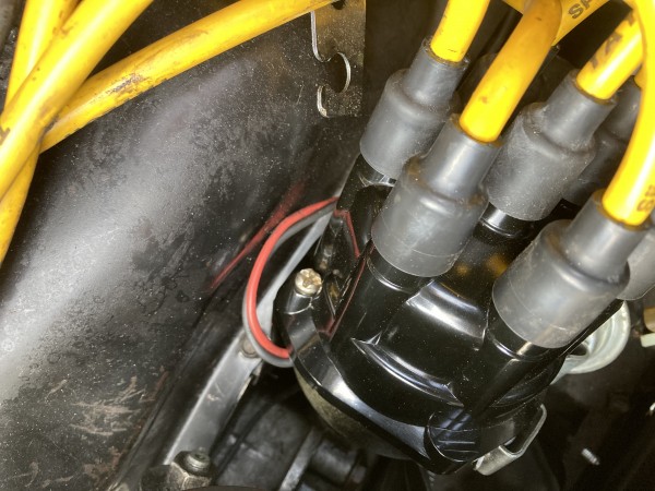

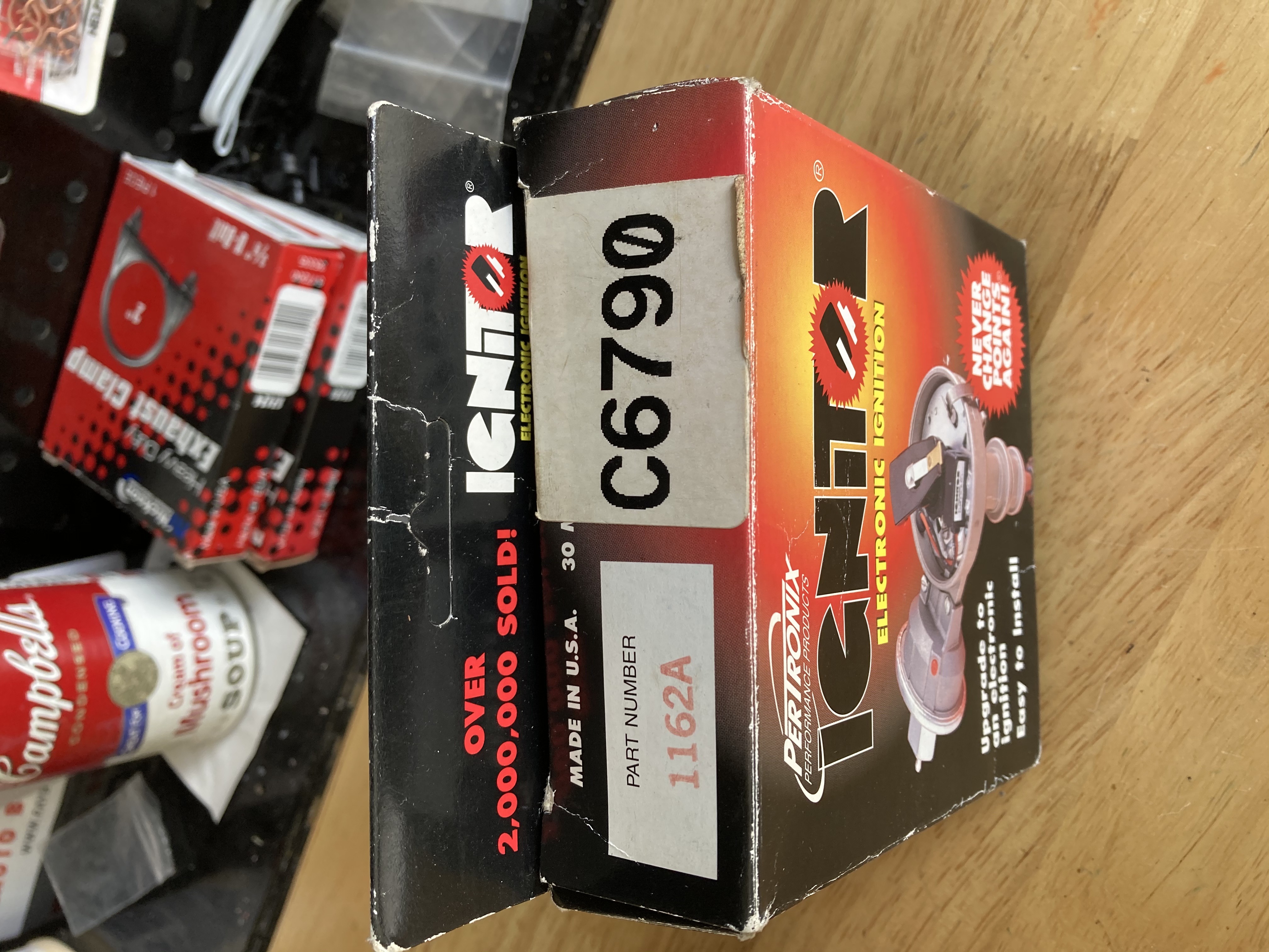

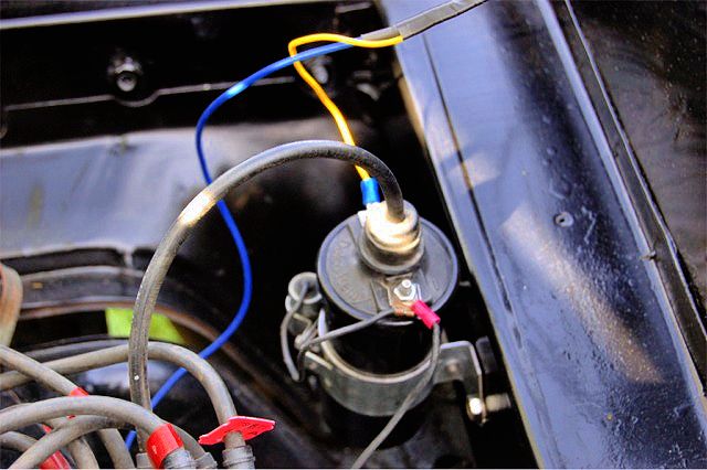

66vairguy, see photos. My car definitely hast the electronic ignition installed. This is apparently what I have installed on my 66 140 4-sp. I say apparently as I’ve had the car for only 1 1/2 yrs and these boxes, with the OEM parts inside came with an assortment of parts along with the car. Brad indicated that I should have the 3 ohm coil, but appears I have the 1 1/2 ohm. Two wires from the distributor, red one is on the positive side. I say all this to say that the distributor rotor failed and left me stranded a few weeks ago cruising down the road at 60 mph! The inside of the cap was coated with goldish colored filings (same color as the end of the rotor) and the end of the metal contact on the rotor burned off which, I assume, ultimately caused the engine to quit. I have no idea how many miles were on the rotor, I’ve put a couple of thousand on the car since I’ve had it. Do you think that the electronic conversion had anything to do with the rotor failure? Do I have the proper system installed on my car?

plrgpr wrote: Thu Sep 03, 2020 1:02 pm 66vairguy, see photos. My car definitely hast the electronic ignition installed. This is apparently what I have installed on my 66 140 4-sp. I say apparently as I’ve had the car for only 1 1/2 yrs and these boxes, with the OEM parts inside came with an assortment of parts along with the car. Brad indicated that I should have the 3 ohm coil, but appears I have the 1 1/2 ohm. Two wires from the distributor, red one is on the positive side. I say all this to say that the distributor rotor failed and left me stranded a few weeks ago cruising down the road at 60 mph! The inside of the cap was coated with goldish colored filings (same color as the end of the rotor) and the end of the metal contact on the rotor burned off which, I assume, ultimately caused the engine to quit. I have no idea how many miles were on the rotor, I’ve put a couple of thousand on the car since I’ve had it. Do you think that the electronic conversion had anything to do with the rotor failure? Do I have the proper system installed on my car?
Your Pertronix Ignitor 1162A (often called the Ignitor I) is the unit I use. This requires a minimum ballast AND coil total resistance of 3.0 ohms (Corvair ballast is 1.8 ohms plus stock Delco coil is about 1.3 ohms for a total of 3.1 ohms). So NO a 3 ohm Flamethrower is incorrect to use with with the Corvair ballast in place. You 1.5 ohm Flamethrower WITH the stock ballast is correct (however per my experience I would not use any Flamethrower coil, but if yours works then no need to change it). If your Flamethrower coil fails I'd use a QUALITY replacement coil for a 1965 Chevy SBC (283,327 c.i. V8). As close as you get to the 140HP coil now.
Many connect the Ignitor RED wire to the coil "+" terminal. It's not the best power source, but it seems to work. I connect the Ignitor RED wire to the ignition switched voltage BEFORE the ballast wire at the engine bulkhead connector. If you are not skilled at working with wiring, and the car runs fine then leave the Ignitor RED wire on the coil "+" terminal.
The brass filings in the cap indicate a clearance problem. I have found replacement rotors that fit too tight and would sit up too high hitting the distributor cap terminals. Also I've seen distributor caps on crooked, specifically if not notched for the Pertronix wires, that will cause contact/rotor interference. BTW the Ignitor magnet ring that fits below the rotor on the points cam is NOTORIOUS for being too tight and won't go down all the way (makes the rotor sit too high) or if forced it will eventually crack. A small machinist file to carefully remove casting flash plastic will fix it. DON'T make it too loose!
