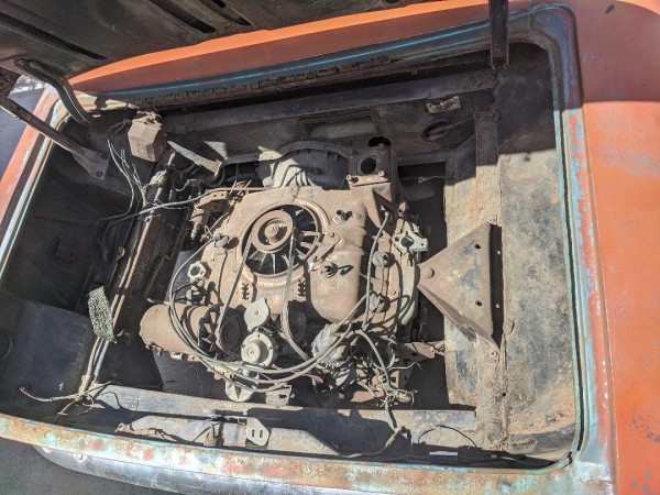

Here are those photos as promised.
First order of business is deciding what to do in place of the missing turbo/carb/intake? I am thinking about these options:
1) the best way to make use of an original turbo with a better carb
2) Weber carb with a modern turbocharger
3) EFI system

I love the early models and as mentioned before the 64 spyder is king. Based on what you stated I would look at some type of programmable ignition, hybrid turbo, progressive Weber or Mikuni HSR modded for automotive use with turbo and a water/meth. Injection setup. These mods will transform the spyder into a very quick ride and provide a semi stock look under the bonnet. You will also need a wastegate with this setup.

:think: One issue not discussed here (yet) is your financial budget for this project. :dontknow: :doh: Good used and complete factory turbocharger systems can be very rare and somewhat pricey. A developmental system like the one mentioned above can be VERY expensive and experimental/high maintenance and likely not much of a "daily driver". Success with such a system may be beyond the reach of a first-time Corvair owner (and even many experienced Corvair owners).
:idea: Alternatively, a well-tuned 110 hp or 140 hp factory layout, primarily a GM factory stock configuration — possibly supplemented with some modern technology updates like an alternator-based charging system upgrade (standard on 1965-1969 Corvairs) — possibly using a newer-design GM alternator with internal solid-state integrated voltage regulator — and a modern Stinger breakerless distributor to eliminate high-maintenance ignition points and condenser can produce a good-performing street-oriented Corvair that can often tolerate REGULAR gasoline. (Turbos DEMAND expensive PREMIUM fuel and usually get fuel mileage that is much lower than the normally-aspirated 110 hp or 140 hp Corvair). Electronic Fuel Injection (EFI), as outlined and described earlier, is well-developed using many standard GM components. Although a somewhat pricey jump, it can help the Corvair make the leap from the mid-20th century to late 20th/21st century performance, low maintenance, and high reliability. ::-):
