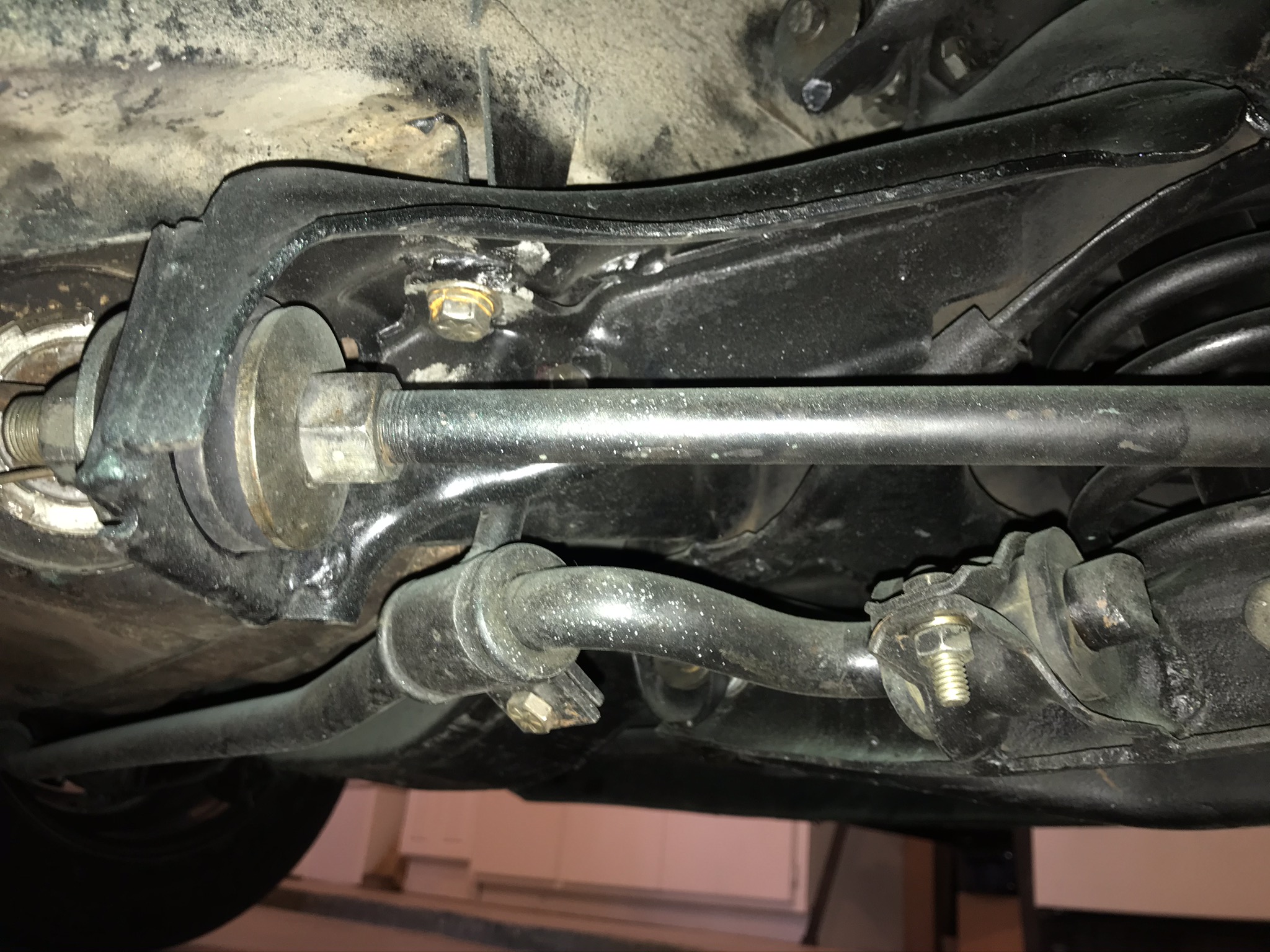

Re: Front end clunking
He stated a bolt in a slotted hole. There are no slotted holes that bolts go thru in the stabilizer assembly.steve57 wrote: ↑Fri Jan 17, 2020 10:17 am Westds1 was talking about the clamp at the end of the stabilizer bar, it is as he described, fits into a slot at one end secured with a bolt at other. Also check your lower shock bolts for proper torque. If loose than can cause clunking.14681929-E928-4FB1-8A4A-B47C072D831C.jpeg
I thought it might be the outer stabilizer bar bushings too, as mine were chewed up. Someone had replaced them the wrong way - they are oval, and stand up tall, rather than the way the previous job had been done. I replaced them and tightened them up - still clunks. When the snow melts around Chicago, I will take it back in and have my guy go over the front shocks in detail. If they were installed by the same person that mangled the stabilizer bars bushings they could be wrong as well.
