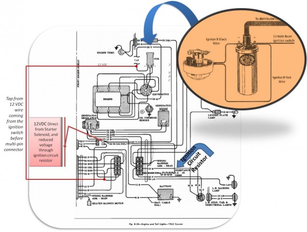

ELECTRONIC DISTRIBUTOR UPGRADE/REPLACEMENT OPTIONSbbodie52 wrote:The Pertronix Ignitor II has been known to have some sensor problems managing a slow idle, such as found with a Corvair running a Powerglide automatic transmission in DRIVE. I believe the problem appears when the idle drops too low for the Pertronix Ignitor II electronic module to manage the pulses properly. The ignition system may begin to skip every other pulse, causing an ignition system misfire. This may show up with the engine dying when you shift a properly idling engine from NEUTRAL to DRIVE. The load of the torque converter may slow the engine to the point that the Pertronix unit begins to malfunction. The problem is not present in the Pertronix Ignitor I, the Crane Cams (FAST) XR-700, or the Stinger electronic distributor marketed by Performance Corvairs (Seth Emerson).
viewtopic.php?f=225&t=15101
As mentioned in my previous post, the above link points to a post that discusses several different electronic ignition options. While you could return to ignition points, the concept of an upgrade to a breakerless ignition system is a good one that improves reliability and eliminates the continuous tune-up cycle associated with adjusting and replacing ignition points and condenser.
I have not heard of Pertronix taking a position on this compatibility problem with the Ignitor II, and since you did not actually purchase the Ignitor II system I don't know if they would replace it with an Ignitor I unit (which is compatible with the Powerglide-equipped Corvair). Increasing the idle speed might move the idle speed in DRIVE high enough to avoid the stalling problem by keeping the Pertronix unit functioning, but it might also cause the engine to race in NEUTRAL at a high idle and the jerk the car with you shift to DRIVE or REVERSE. Perhaps you could sell the used Pertronix II to help offset the cost of a suitable replacement. Ideally Pertronix would redesign the Pertronix II to correct the compatibility issue, but if the problem only surfaces in automatic transmission six-cylinder cars few customers are likely to discover the fault. They should warn the consumer in their advertisements and instruction manuals about the compatibility issue, however.

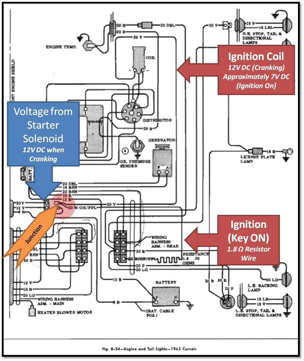

If your aftermarket ignition coil is a Pertronix FlameThrower II coil, it is not compatible with a Pertronix Ignitor I electronic module or the Crane Cams/FAST optical trigger XR-700, because of its very low resistance (0.6 ohms) primary coil winding. That ultra-high voltage coil is overkill and not needed in a Corvair, and the high current it draws due to the 12 VDC/0.6 ohm Primary will damage an Ignitor I or an XR-700 unit. If you sell the Ignitor II and have a FlameThrower II coil, it should be sold along with the Ignitor II system.
Pertronix recommends a 3.0 ohm version of their FlameThrower I coil, along with their Ignitor I ignition module. The electronics in the Ignitor modules really prefers a full 12 VDC power source, so Pertronix recommends bypassing the ballast resistor wire in the Corvair wiring harness to provide that 12 VDC power to the Ignitor I module and to the ignition coil. Coupling it to the FlameThrower I 3.0 ohm coil sets up the coil for correct operation on 12 VDC on a six cylinder engine.
If you were to choose switching to the optical trigger Crane Cams/FAST XR-700, you would find that the electronic module it uses was DESIGNED to operate on the reduced voltage provided by the Corvair wiring harness ballast resistor wire (nominal 7 VDC). The XR-700 electronic unit will actually overheat and probably malfunction if it is powered by a full 12 VDC battery voltage. With the ballast resistor wire in the circuit, the coil chosen for use with the XR-700 should have a 1.5 ohm primary resistance. This is the resistance found in the stock Corvair coil, and in many high performance aftermarket coils. (I prefer the reliability and positive reputation of the FAST XR-700 system over the Pertronix aftermarket units).
The newest upgrade system is the Stinger replacement distributor, which uses a magnetic pulse breakerless ignition system similar to the Pertronix design. It has a switching transistor in the circuit that can handle a coil with a a low 0.6 ohm primary, or it will also work with a 1.5 ohm coil. The electronics in the Stinger distributor requires a full 12 VDC power source. I think this new, modern design distributor is the best choice, it is cost-effective, and it brings the 1960's Corvair ignition system forward 50 years to 21st century performance and reliability. You might consider calling Seth Emerson to discuss your options. He has a lot of Corvair experience and I believe he is also t president of the CORSA club chapter in San Jose.

I hope all of this technical talk hasn't given you a headache. But when you modify the ignition system in your Corvair all components must be properly installed and properly wired according to the installation instructions, and compatibility issues must be fully addressed to have the new system installed according to the design specs.
CORVAIR COMBINED WIRING SCHEMATIC DIAGRAMS
viewtopic.php?f=225&t=12968
