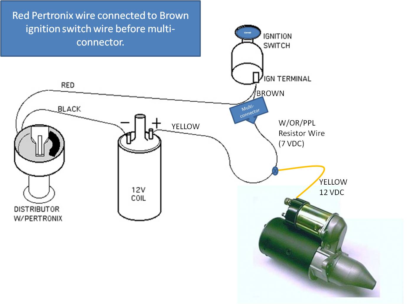

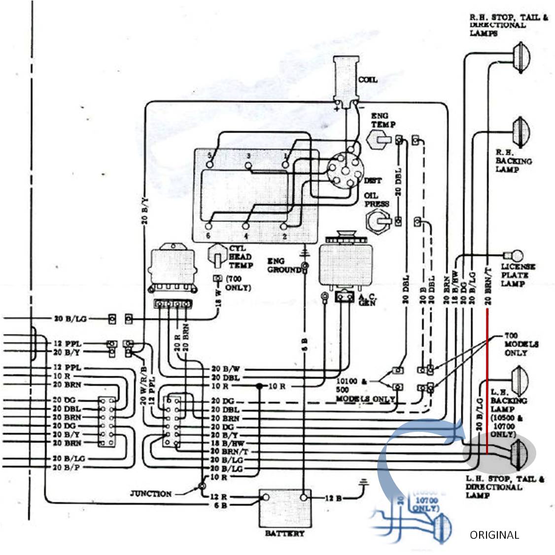

On a 1965 or later Corvair, tap off of the 20 B/P wire (before the 12-pin multi-connector) to obtain 12 VDC switched by the ignition switch.

This has been covered numerous times - the ballast (resistance wire in GM cars) is about 1.8 ohms and the stock coil was about 1.2 ohms for a total of 3.0 ohms (minimum resistance for the Petronix 1162A), EXCEPT when the starter is engaged that by-passes the resistance wire (to increase cold start voltage to the coil). I don't care for the Flamethrower coils since they have had numerous quality issues over the decades, but if your 1.5 ohm coil has been working it's probably fine.
1. Makes sure the Petronix module ground is good.
2. DO NOT hook the Petronix power supply wire to the coil "+" terminal (it will work usually, but is not advised). The supply wire goes to the harness wire with power from the ignition key (the other side of the connector has the resistance wire that goes to the "R" terminal starter). From the starter a regular copper wire that is either black/yellow or yellow goes to the coil "+" terminal. See Brad's markups here.
3. the Petronix coil wire goes to the "-" coil terminal (like the points wire)

So the black with yellow wire, as seen in my second image, is likely running at 7v (I'll check with voltmeter of course)?
Brad's images make it all very clear and as was recommended, I now understand to "tap off of the 20 B/P wire (before the 12-pin multi-connector) to obtain 12 VDC switched by the ignition switch." Is there a specific place I can do this in the engine bay or do I need to pull directly from the fuse block? Sorry, Corvair electrical is not exactly my specialty. ...oh and B/P would be black with purple?

Chris - Most of the Corvair folks in my club have difficulty with electrical concepts, so you are not alone.
The "B/P" is BLACK/PINK, P=pink. There is violet that looks like purple and is identified as V for VIOLET on the drawings.
The voltage at the coil is confusing to most since voltage only drops to a lower value when there is amperage (current flow). Basically when the points are open no current flows and the coil "+" terminal is the same as system voltage (13-14.5VDC). When the points close current flows and "drops" voltage at the ballast resistance and you'll measure about 5-6VDC at the coil "+". When the engine runs the points open and close rapidly and a voltage meter can't react that fast and some average readings and will display anywhere from 7-11VDC.
Hope that helps
