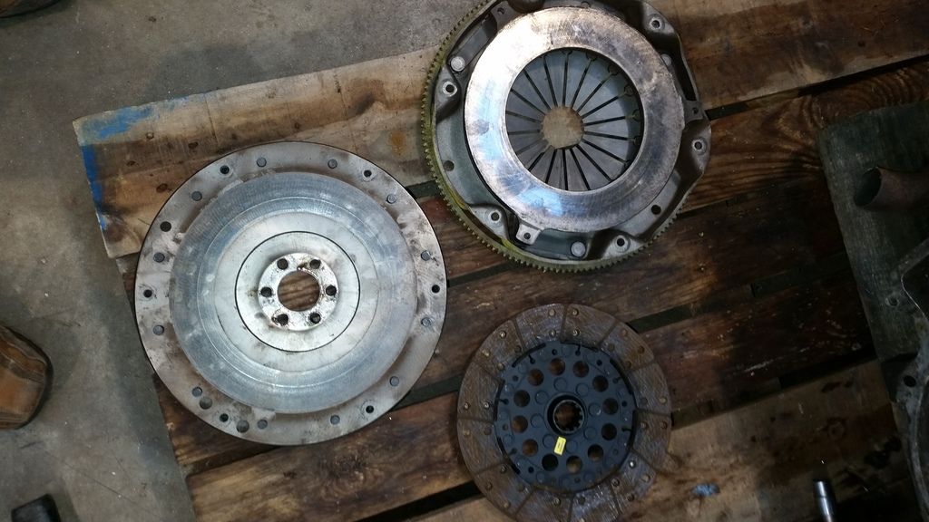

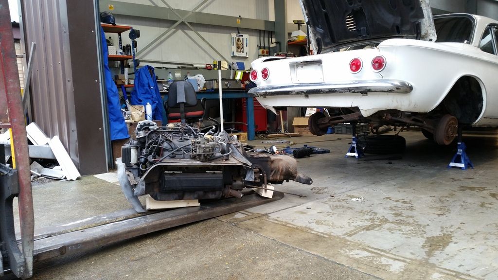

The immediate problem is the starter and a flooding carb. Having looked at the starter internals it was well worn but that didn't explain why it was slipping on the ring gear, I fitted a new pinion gear to the starter which came with the car but it was not much better. After a bit of thought I decided the engine had to come out to see what was going on.

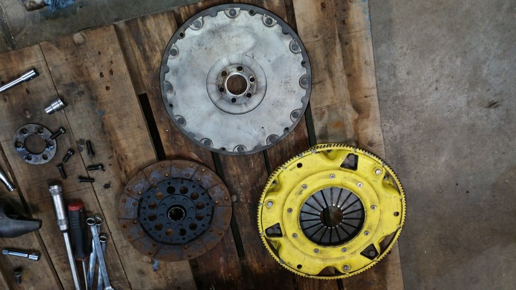

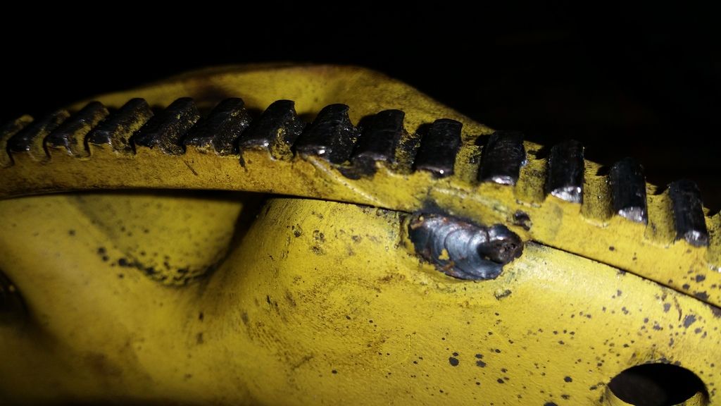

It would appear that it has recently had a new clutch and riveted flywheel which is nice! What isn't nice is that the ring gear has been chewed up by the starter and also some of the welds holding the ring gear to the clutch cover have started to fail.
So my shopping list is getting bigger, I might see if I can find or make a ring gear and put it on the existing clutch cover rather than importing a new clutch cover. There is no big rush but it would be useful if I could easily move it about. Now the engine is out I might dress the tin ware up and paint the engine bay, and there is a bit of welding round the back to attend to, and it would be nice to get the rear suspension out and re-bush and paint that. I can see this is starting to snowball!
Any clutch related suggestions are welcome, as are any other thoughts in general.

Yes there are many jobs you could do whilst the engine is out, where do you stop?
Very jealous of your workshop :tu:
