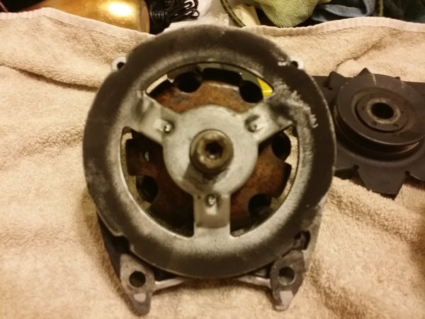

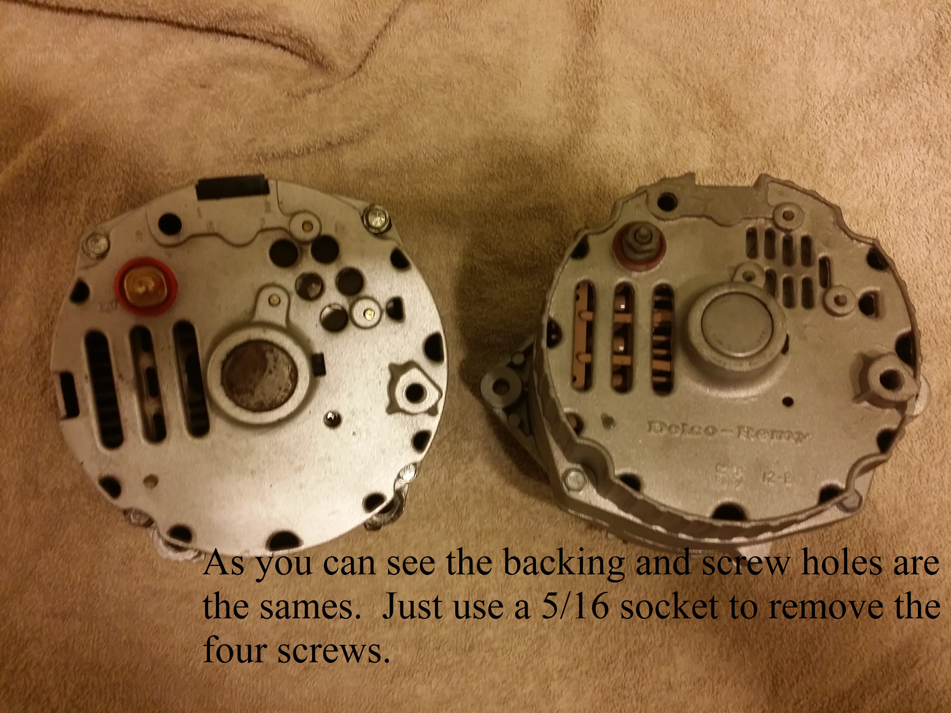

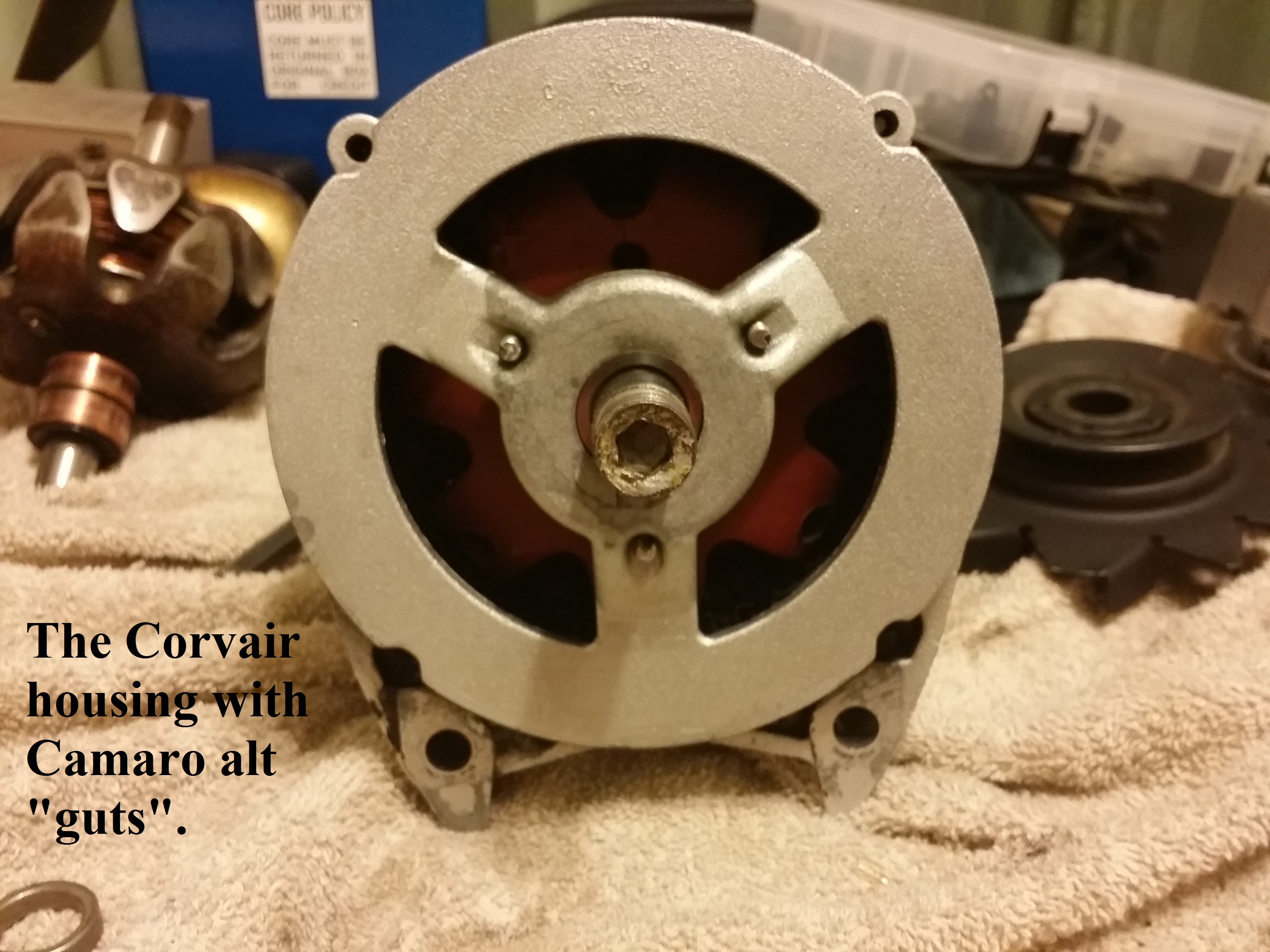

To Remove
1. Start off by removing the large nut that holds the fan/pulley.
2. Remove (4)5/16 screws from the back.
3. Carefully lift the top off by wedging a flat head screw driver between both alt pieces.
4. Take careful notice of where the bushings belongs, one below the fan and the other on top of the fan.
To Reinstall, just do the opposite of above.

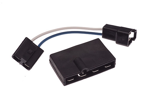

Yes this is an internal regulator, I plan to complete this conversion with a M&H #27555 kit.Jerry Whitt wrote:Is this integral type? Picture not real clear on the plug.

O.K. blue to blue, white to white. The connector to the alternator is keyed so they go to the correct terminals.LBC TITAN wrote:66vairguy wrote:
VairGuy, that was a good observation because I never mention that it was a one wire alternator.![]()

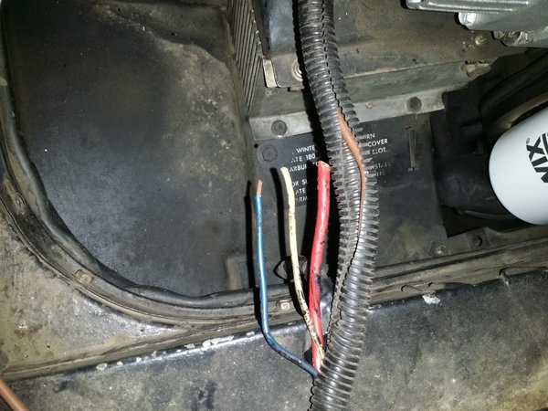

I peeled back the tape on the harness and found three wires cut, "blue", "white", and "red" probably a size 10. All of these wires are hot when I turn the ignition to the on position, tested with circuit tester. I'm going to go ahead and connect the two wires from the kit to the matching color wires I found in the harness this morning.
Unfortunately someone has cut the wires to the old regulator socket. Hard to say whats going on and you'll probably have to unwrap the whole engine harness to figure it out. So I'll bet your warning lamp will still NOT work and the alternator field won't get energized properly.
O.K. hard to explain without a diagram - but here goes. Blue wire should go to "F" terminal on regulator socket, White wire goes to "2" terminal on regulator socket, Red wire goes to "3" terminal on regulator socket, Brown/White wire goes to "4" terminal on regulator socket. To run your setup F (Blue) must connect to 4 (White/Brown) and 2 (White) must connect to 3 (Red) - note the red wire is any one of the wires to the battery usually all connect at the frame junction block. The wires are shown in the factory manual, but it's not easy to read.
P.S. your sense line is open - do NOT run the engine like this or very high voltages could result.
Good luck.

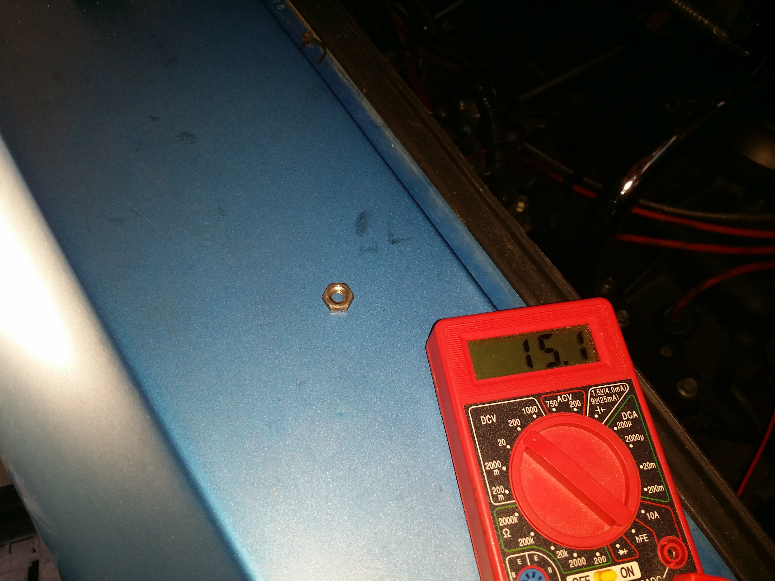

I understand what you're saying about the Blue wire should go to "F" terminal etc., but I believe M&H supply the adapter that will do that for me. See my pic below, great thought, I really appreciate it.
To check the voltage I used a multi-meter, black to chassis ground and red to battery terminal of the alternator, it showed 15.1. I'm going to test again at engine temp and see what the readings are.

Yes the rectangular black connector goes on the the plug that normally fits on the external regulator that is near the drivers side engine lid hinge, BUT based on your pictures the wires from your alternator to that regulator socket have been CUT.
Typically the 10SI internal regulator has an internal reference so if the sense wire goes open the alternator wont "run away" with a damaging high voltage. That may be why your seeing 15.1VDC. With a sense line to the battery the voltage should settle down to about 14.1 after the battery is charged up, or about ten minutes after starting the car.
