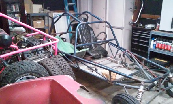

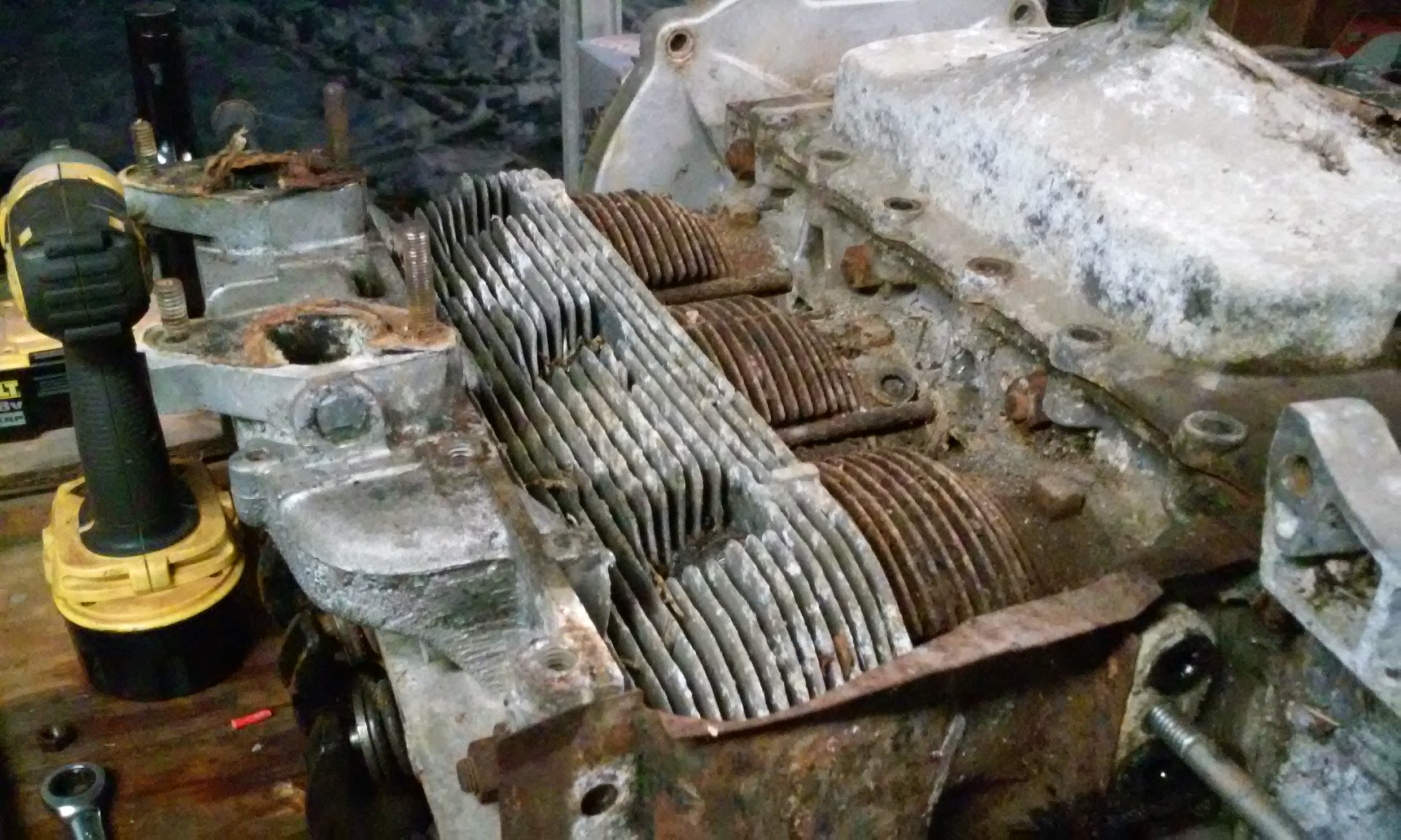

This is what I got. The engine sat out side many years. I didnt want to see it go to waste. I have a good running 150hp turbo engine that I am taking back to stock. I have a 110hp engine that I want to transfer everything that is good to the 110hp engine. It is going in the blue buggy.I will not be using the clutch or pressure plate from the corvair.

Better stock up on PB Blaster!

Havent had problems with bolts not coming out yet.
Re: 140 hp engine?
An "outside" engine is always a mystery until you dismantle it.
If water got down in the manifold there could be severe corrosion. Pull the heads and see what the gasket and chamber areas look like. Don't be surprised if the valves are corroded in the guides, don't force them. Maybe you'll get lucky.
Re: 140 hp engine?
Wont know till this weekend. The intake had a couple bags over it. We will see with more pics to come.
