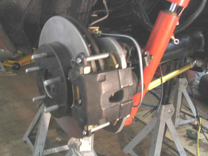

I am not familiar with the undergrounds setup but I made my own and here's what I did.
I'm using Caddy calipers - the difference is that they have a parking brake but it is essentially the same otherwise.
I use a metal line that screws into a banjo fitting on the caliper and the other end goes to a flexible hose .
The calipers are the floating type so your line must allow some movement .
My bracket where the metal line meets the flexible line is rigidly attached to the caliper so it moves with it .

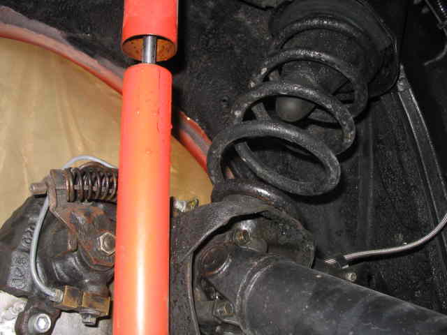

The pic below shows the factory hose and the fitting it goes to. Even with stock drum brakes there was a solid line from the wheel cylinder to the rubber hose .

Mine goes to metal line that goes around caliper and the connects to flexible hose so it is female .
