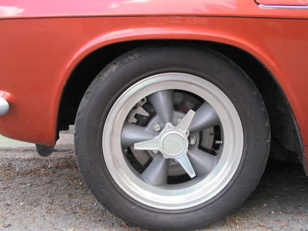

I would like to know where to get these wheels. I like these.

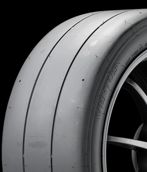

I just bought 15" tires for the front of my car - there were many choices .
I went with the BF Goodrich G-Force Rival in a 205/50/15 . The rival is a high performance summer tire with a
wear rating of 200 .
I also bought 4 new racing tires in 225/45/15 . They are track only tires with a 40 wear rating .
