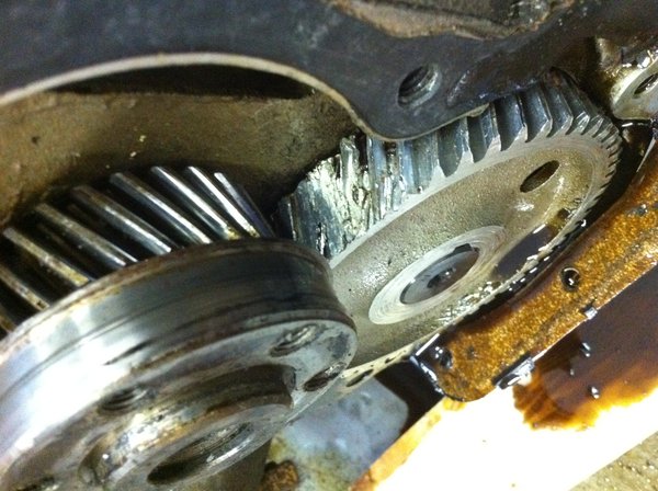

Ok i didnt have anyone to help me out today but i did have a compression tester, only tested 4 cylinders 3 had no compression, one had 30 lbs. hmmm kinda thinking its got something to do with the timing gear or cam itself. I guess im going to have to pull the engine. first time pulling a corvair engine, besides the obvious of unhooking wiring harness and all that junk, where should i start? ( havent taken a close look but i plan to start tomorrow) probably can figure it out but it would be nice to have a good idea before jumping in.

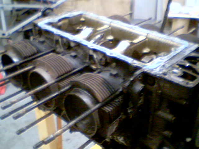

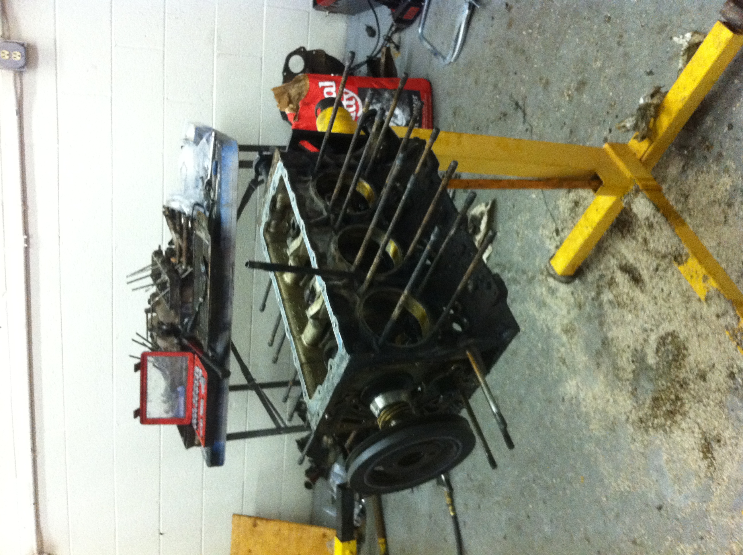

tore down the engine today

doing everything is oke, than it is done and you ccan ride for years again, fixin 1 thing now and next month you may fix it again do not work. The gear looks verry wornout :-( hope the rest is more oke !! good luck with ordering and collecting parts (like a early christmas whoooie) and putting it back together.

Ouch... hope it didn't bang up the valves, probably did though. :/

Ya It probably bent the valves. Not sure yet though, Im gonna buy a pair of 150 heads from Jimbo though, so all new valves are on my parts list. Also decided while I've got it out and apart I'm going to put a new clutch disk in. It's not too bad but I'd rather not take it apart again anytime soon
