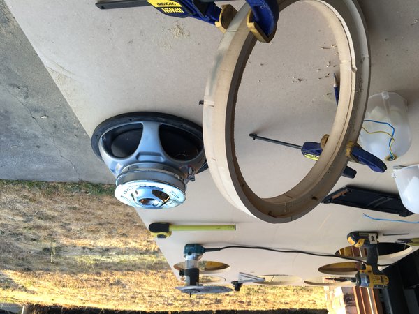

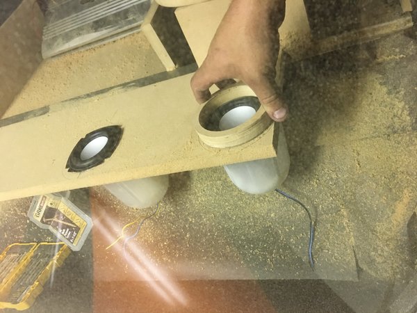

I want a very clean crisp sound but there has to be some pretty serious low end to keep me happy
I have an older pair of arc audio KAR12 Subwoofers. They're dual 4ohm Speakers, 700w peak, 350w rms. Would Like to wire them in parallel and end up with a 1ohm load and a pretty beefy amp.
I'm taking the backseat out of the car, not enough room for any shenanigans anyway, so the subs are going behind the seats, i'm building a 3/4 mdf box (optimum airspace is 1.1 cubic ft per speaker) for them but it will all be covered with a fiberglass shell that wraps up to the bottom edge of the window where i'll be placing my mid range drivers.
this is where I may have some people who tell me I'm crazy. For the Mid's I'm not planning on using a typical car speaker. I'm going to use the AuraSound NS3-193-8A. They are a 20w RMS 80w Peak 7.6ohm speaker (requires .1 cubic ft sealed airspace per speaker) I've used 64 of these wired together in a matroxed system and absolutely fell in love with these speakers! they have an incredible response 80-15kHz. I generally cross them over somewhere between 150 and 180 depending upon my low end. I have 6 of them, 4 are going directly below the rear window facing forward, and one in each door panel along with a tweeter.
I still need a controller that has a crossover, full parametric eq, pan controls, timing controls, and maybe a mixer, I'd like to have a channel for every speaker, but honestly an 8 channel would suffice. I plan on running my RTA when finished and doing an impulse study to adjust each individual speaker and on the back 4 speakers would like to pan the middle left and right speakers only slightly off center while the outsides would be fully left and right.
