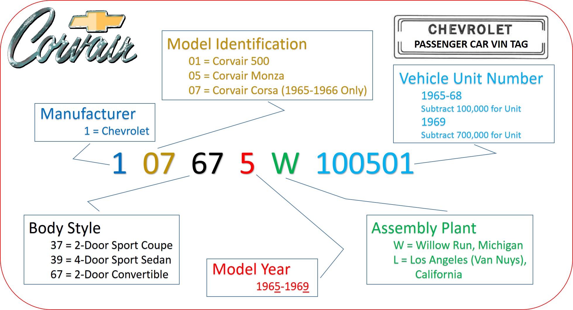

On my Body Tag are: "5Y" and "W". Also above the Y-Y paint code is "755". To the right of TR is "795-Z" Please decode.
Thanks

Re: '66 Coupe
Sample 1966 Corvair Body Tag...
STyle: 66 = 1966 10737: 1 = Chevrolet, 07 = Corsa, 37 = 2-Door Coupe 4-Passenger,
LOS = Los Angeles (Van Nuys Plant), California, Production Sequence No: 755
YY Lemonwood Yellow
TRim 795-Z
Interior Trim colors and RPO Number: 795 = White (Black) White Trim (Black Carpet, Instrument Panel, etc.)
Z = Corvair trim designation on LA built cars only.
ACCESSORY CODES:
First Group ( no numeric indicator)
W = RPO A02 — Tinted Windshield only
5 = Fifth Group (5YW)
Y = RPO A39 — Deluxe Rear Seat Belts
W = RPO A39 — Custom Deluxe Seat Belts Dual Front and Rear (Stainless Steel Push-button Buckles) With Front Retractors Only.
