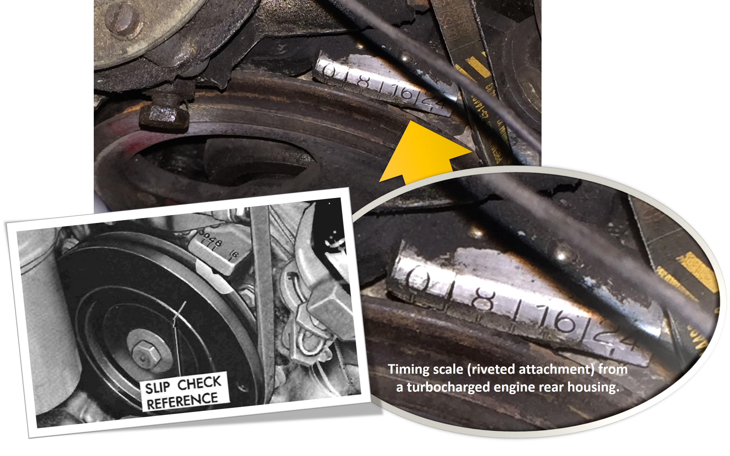

REFER TO THE DISTRIBUTOR AND PULLEY/TIMING MARKS PICTURES BELOW.
Basically, rotate the engine crankshaft counterclockwise until the timing mark on the pulley lines up with "0". If the engine is on the compression stroke, both valves associated with cylinder number one will be closed. If examination shows the EXHAUST VALVE to be open, the piston is at TOP DEAD CENTER of the EXHAUST STROKE. Rotate the engine crankshaft one more full turn counterclockwise until it reaches "0" again on the timing marks. This time it will have both valves closed on cylinder number one, and the number one piston will be at TOP DEAD CENTER on the COMPRESSION STROKE.
Point the distributor rotor (cap off) in the position of distributor cap tower number 1. Insert the distributor with the rotor pointed correctly until it is fully seated and the distributor gear is engaged leaving the rotor pointed as shown. (If the distributor won't go all the way down, the oil pump drive at the bottom may not be oriented properly to allow the bottom of the distributor shaft to engage with the oil pump drive. You can use a long-shaft flat blade screwdriver to manually rotate the oil pump a little to allow the distributor shaft to engage properly with the oil pump while permitting the distributor to bottom out).
See DISTRIBUTOR INSTALLATION — ENGINE DISTURBED on page 6Y-20 of the attached shop manual section...
It is possible to static-time your ignition system with a strip of paper placed between the ignition points. The engine timing mark can be manually positioned to the desired setting on the crankshaft pulley, and the distributor can be slowly rotated until the points just start to open and release the strip of paper. This establishes the point that the ignition coil will discharge, with the rotor pointing at spark plug wire number 1. The distributor is then tightened and the mechanic has established an initial static timing setting. Of course, having a timing light makes things much easier, improves accuracy, and permits visual confirmation that the centrifugal advance is functioning.
