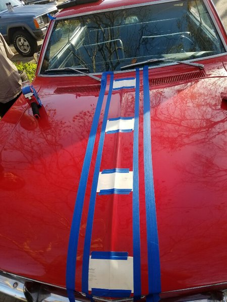

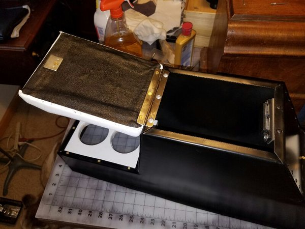

With a little help from my Daughter we layed out the Yenko stripe

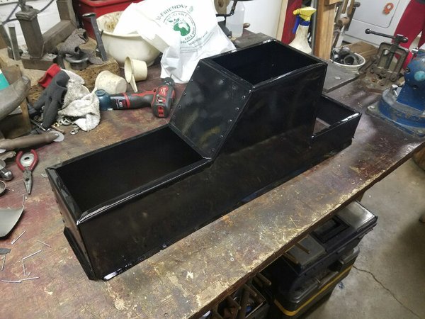

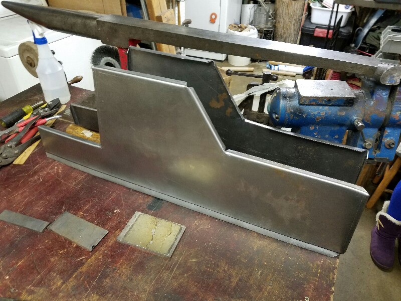

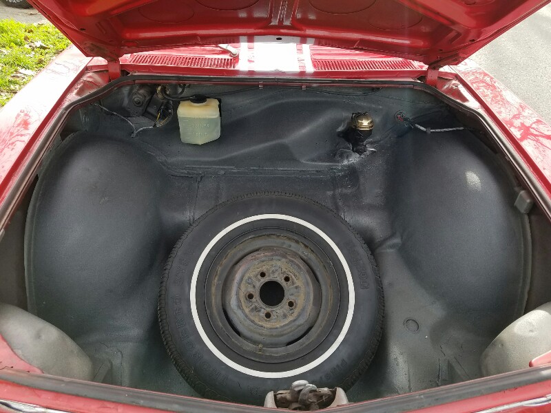

this is 16ga steel (cause i have lots) First test fit, seems like I imagined it Rust coating done. Now it needs the wooden drink holder inserts, the top hinged cover, and it's white and black fabric covering. and finally, got the Frunk mostly sorted out
FLat White was SO the right choice instead of the usual black.
I decided this car need a center console and drink holders (front and rear)this is 16ga steel (cause i have lots) First test fit, seems like I imagined it Rust coating done. Now it needs the wooden drink holder inserts, the top hinged cover, and it's white and black fabric covering. and finally, got the Frunk mostly sorted out
CORSA Member #034095
Re: 65ish Corsa Automatic
Man Steve, where did you get a hold of that nice long anvil? I bet that comes in handy for doing sheet work! Btw the stripe is looking good.
I've been making armor for more than 25 years so I have a bit... that is called a beakhorn, I also have a blowhorn which is the stake used for making trumpets and other wind instruments. I have about a dozen or two homemade stakes specifically for the components that I make, so yeah hand metalworking wise I've got lots of toys

Cool,looks good with the white stripes!!

Good idea on the stripe layout!

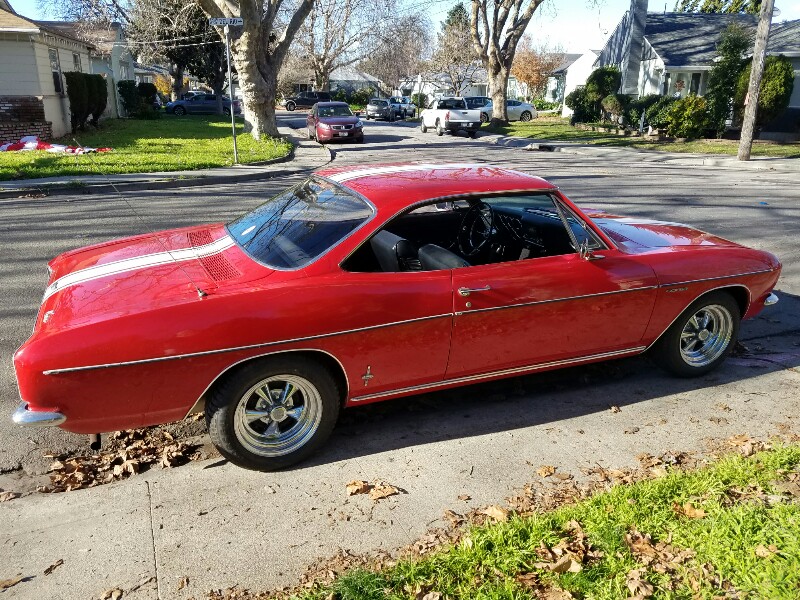

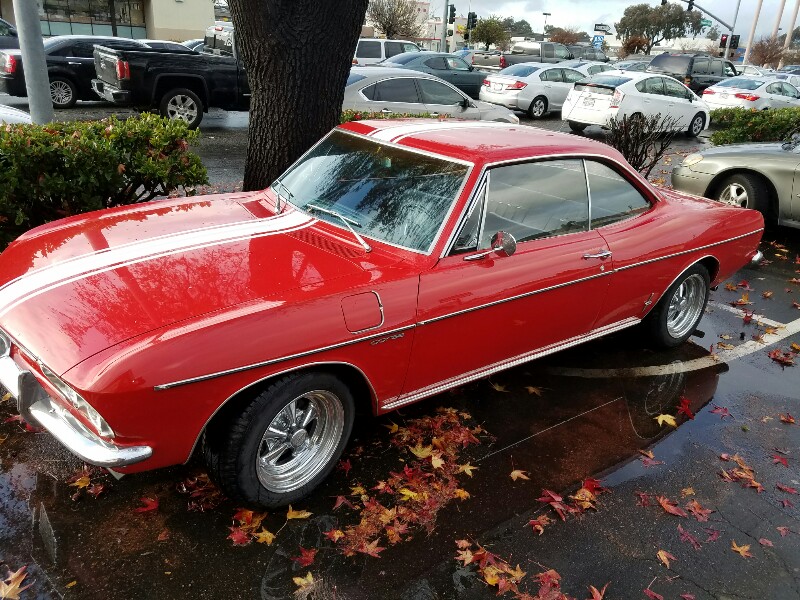

Birthday Upgrades!!! Front Air Dam, 15" Crager S/S's and 205/60R15's

Cool!! Congrats and happy birthday!!

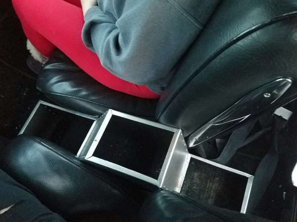

Center console done. Will be installed Tomorrow after she gets out of the shop.

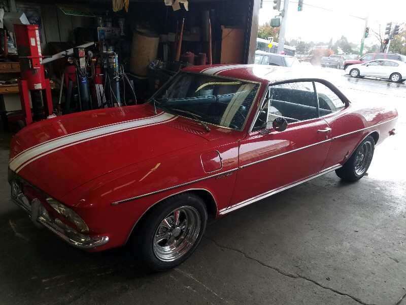

Took it to a GREAT local shop, same day service $190 to cut 1 coil from my fronts. I got a 1.25" drop.
Waiting until they close be stored inside waiting for the first AM appointment for brakes and alignment

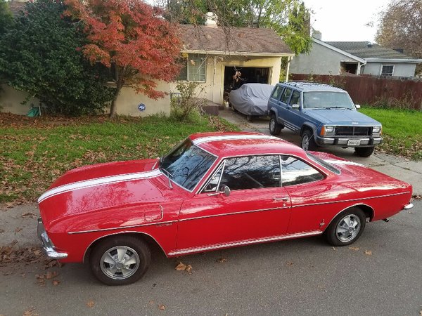

home!!!
Thanks! Here it is with the console in place.
