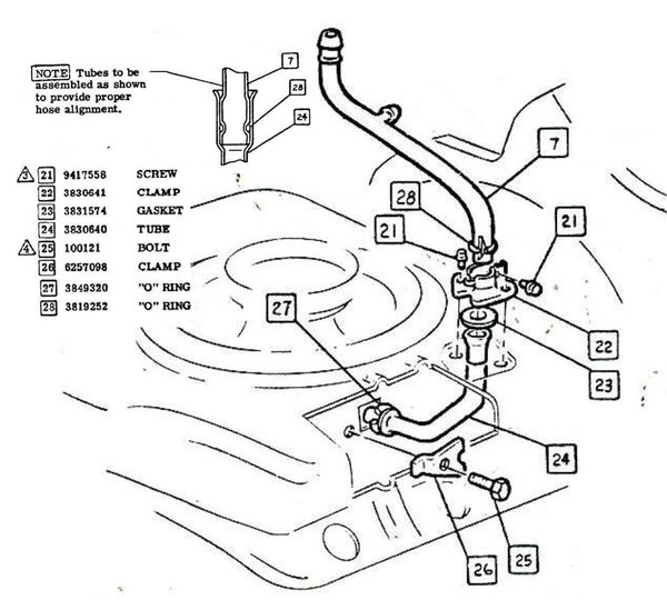

I have been cleaning the top of my engine so I noticed this after going for a drive...... There was a little puddle of oil just below the vacuum balance tube on the right side of the engine, and it seems to have run out of the tube or the carb base......unfortunately I did not do the sniff test to determine exactly what type of fluid it was......so I was wondering what places the vacuum balance tube is connected to.
Can it suck oil from anywhere or should I assume my. Modulator valve has decided to start leaking trany fluid through the diagram ? If memory serves the skinny rubber line about the middle,of the balance tube goes,to the modulator valve......where does the fat ruber line go to..... Crank case maybe?

The two sources of oil that might feed into the vacuum balance tube might include the PCV (Positive Crankcase Ventilation) system, possibly feeding oil from the crankcase via the fixed vacuum orifice. The other might be the Powerglide transmission vacuum modulator.
Oil would not normally be drawn through the PCV tube, as it is used to relieve crankcase pressure buildup created by piston ring blowby. However, the crankcase is a sealed area with limited places for pressure to go (if it is excessive). There is a baffle plate between the engine top cover and the engine cases to prevent oil from getting into the PCV system. I suppose it might be possible to have some oil work its way into the PCV tube and possibly collect and drain from the vacuum hose at the base of the carburetor (check the condition of the rubber balance tube connector hose — it might be cracked or split from heat and age).
The Powerglide transmission is like a fluid-based computer. Cooling, control and switching/shifting, as well as lubrication and fluid coupling between the engine and the transmission is all done by the transmission fluid. The condition of the fluid AND THE FLUID LEVEL are critical. An overfilled transmission is very bad, in that the rotating planetary gear set spins in a bath of fluid, which can cause air entrainment, or foaming of the transmission fluid. Low fluid levels can result in poor cooling and shift control and slipping/burning bands and clutches. A leak can quickly translate into internal damage that is much-more difficult and costly to repair than the leak itself would have been.
Clark's indicates that the vacuum modulator on the side of the transmission has a limited operational life of about 10 years or so. They cannot be repaired, so if you discover transmission fluid in the vacuum hose that connects your Powerglide transmission to the engine, replacement of the vacuum modulator is likely indicated.

Thanks for the vacuum circuit picture, very informative...... I really do suspect the modulator valve so I have already ordered one even if it is not the problem, it can't hurt to replace or have a spare:)
As I said the only way the oil could have got to,where I found it was the rubber coupler, so I ordered a couple of those to..... When my parts arrive I I'll pull the vacuum tube to replace the rubber couplers and I will see if I can see exactly which fluid is getting in there.
